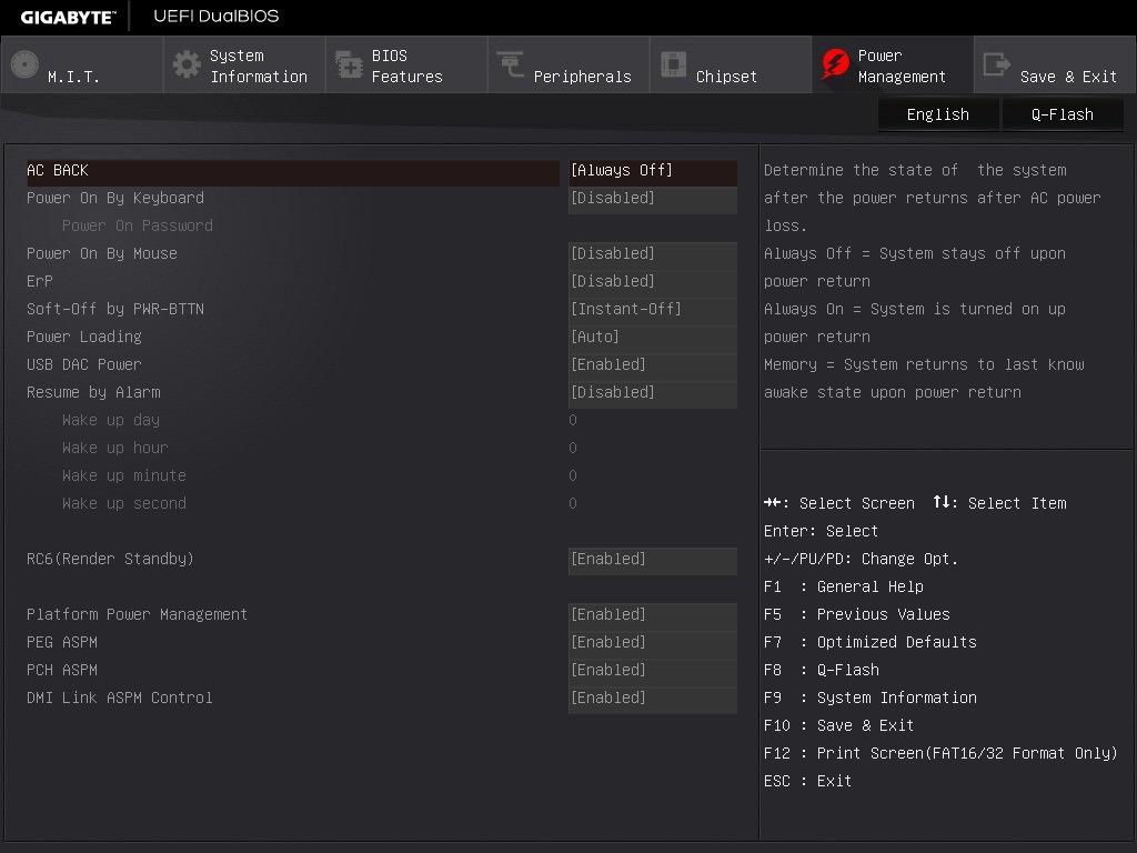

hackaro Posted March 19, 2016 Share Posted March 19, 2016 Well, fair enough. Maybe if you use AppleIntelE1000e.kext instead of IntelNausiEthernet.kext and double checking your BIOS power management will help. And please give me more info of your syndromes while shutting down. What exactly happens? I will give a try to AppleIntelE1000e.kext but I've already tried with the other NIC present on Gaming-5 and nothing changed. I have the suspect that the culprit is in discrete graphic card. Not because GA GFX 950 has something wrong (I also tried an ASUS GFX 950 and a Zotac GFX 950, both with the same behaviour) but because the 17,1 Sysdef is for AMD and this can cause some trouble of some kind, but I don't want to leave it because it's the only Skylake platform available. The syndromes are pretty simple: when I click Shutdown sometimes the screen becomes half transparent/grey than the round wheel appears and it shutdown properly, some other times (most of the times!) the screen becomes half transparent/grey ... the round wheel does NOT appear, I can hear the graphics card fan goes very up very high in noise, and after 2/3 seconds I have the GIGABYTE post screen and then I know system has restarted. https://www.dropbox.com/s/jikup6uv80csrvs/Power%20Management_%5B15-28-04%5D.jpg?dl=0 Please note that I tried with Platform Power Mngmt ON and OFF and nothing changed. Link to comment https://www.insanelymac.com/forum/topic/309352-el-capitan-on-ga-z170x-gaming-5/page/17/#findComment-2224947 Share on other sites More sharing options...
Cyberdevs Posted March 19, 2016 Author Share Posted March 19, 2016 I will give a try to AppleIntelE1000e.kext but I've already tried with the other NIC present on Gaming-5 and nothing changed. I have the suspect that the culprit is in discrete graphic card. Not because GA GFX 950 has something wrong (I also tried an ASUS GFX 950 and a Zotac GFX 950, both with the same behaviour) but because the 17,1 Sysdef is for AMD and this can cause some trouble of some kind, but I don't want to leave it because it's the only Skylake platform available. The syndromes are pretty simple: when I click Shutdown sometimes the screen becomes half transparent/grey than the round wheel appears and it shutdown properly, some other times (most of the times!) the screen becomes half transparent/grey ... the round wheel does NOT appear, I can hear the graphics card fan goes very up very high in noise, and after 2/3 seconds I have the GIGABYTE post screen and then I know system has restarted. https://www.dropbox.com/s/jikup6uv80csrvs/Power%20Management_%5B15-28-04%5D.jpg?dl=0 Please note that I tried with Platform Power Mngmt ON and OFF and nothing changed. Here is my power management setting in BIOS. I'm on Gigabyte beta F5h Link to comment https://www.insanelymac.com/forum/topic/309352-el-capitan-on-ga-z170x-gaming-5/page/17/#findComment-2224981 Share on other sites More sharing options...
hackaro Posted March 20, 2016 Share Posted March 20, 2016 Here is my power management setting in BIOS. I'm on Gigabyte beta F5h Same as yours, apart from RC6 standby which is not present, maybe because I have F5 non beta, but still no proper shutdown... Link to comment https://www.insanelymac.com/forum/topic/309352-el-capitan-on-ga-z170x-gaming-5/page/17/#findComment-2225101 Share on other sites More sharing options...
