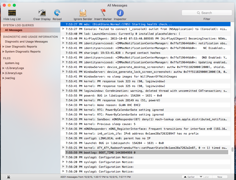

Here's what happens:
i press sleep the machine goes to sleep after a few seconds the fans stops and the light goes down so it's in Deep Sleep /Hibernation when i hit a keyboard button it wakes up Fans and lights works again but no thing on the screen and no sound comes out of the speaker .
it stays like that until i restart via the power button .

so it's not a CMOS reset / AppleRTC problem but a sleep problem?
wake reason "GLAN XHC EHC" -- how did you wake up your computer after sleep?
does your computer work after sleep besides the black screen? (sound etc)

i wake the computer using the keyboard/mouse (both are usb) , nope no sound .

I see you still don't catch that the problem is not in RTC.
The problem is very common
"AMD Radeon 6000+ will not wake up in ElCapitan, no signal on monitor".
That's all. And you will see in your attached screenshot
RadeonFramebuffer:: setPowerState... timed out.
Nobody has a solution.
Guys, please, gather here      No graphics / USB / Audio after wake
for next investigation of the issue
