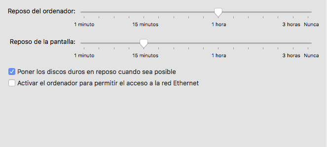

jaymack Posted March 2, 2017 Share Posted March 2, 2017 Jaymack, system goes to sleep, then immediately wakes up on it's own. What settings do you have in energy saver? Link to comment https://www.insanelymac.com/forum/topic/307064-hp-z400z600z800-workstations-os-x-1010x1011x-installation/page/27/#findComment-2376746 Share on other sites More sharing options...
ssprod Posted March 3, 2017 Share Posted March 3, 2017 What settings do you have in energy saver? Jaymack.. #1-Put hard Disks To sleep. #2-Wake for Ethernet network access.. I've experimented with checking/unchecking to no avail. Thanks! I´d tried your EFI folder and my computer do not start up, I´m back to my EFI and my cmos reset problem But sleep works perfect jaygrid... does the system boot to clover, and kernel panic? Link to comment https://www.insanelymac.com/forum/topic/307064-hp-z400z600z800-workstations-os-x-1010x1011x-installation/page/27/#findComment-2376906 Share on other sites More sharing options...
jaygrid Posted March 4, 2017 Share Posted March 4, 2017 What settings do you have in energy saver? It´s in Spanish but you understand I think Jaymack.. #1-Put hard Disks To sleep. #2-Wake for Ethernet network access.. I've experimented with checking/unchecking to no avail. Thanks! jaygrid... does the system boot to clover, and kernel panic? With your EFI folder, boot to clover and the black screen with the apple and the bar is there for ever (or at least for long time), I don´t even check verbose mode to see what happen. I put back mine and boot normally, as I said sleep works perfect so no so bad. I´d go back to Capitan but photo library is not compatible, hope next release solve this. By the way, when I have a Cmos reset is like this: sometimes when I shutdown the system reboot itself but stop in the list of drives (with F1 to save in the bottom) as if i´d change the config and when I go in bios config, the option network service boot is enable and hyperthreading is disable. I always disable network boot because if not you get a spontaneous reboot. Only to be sure we all are talking about the same Link to comment https://www.insanelymac.com/forum/topic/307064-hp-z400z600z800-workstations-os-x-1010x1011x-installation/page/27/#findComment-2378103 Share on other sites More sharing options...

ssprod Posted March 5, 2017 Share Posted March 5, 2017 Problem of instant wake after sleep is solved! I patched my DSDT w/ Rehab's USB3_PRW 0x06 patch and voila! In addition, my external USB Audio Interface (Alesis ControlHUB) is preventing my system to stay in "sleep" mode. Thanks, and I'd be happy to follow this forum and improve the Z Series going forward. Link to comment https://www.insanelymac.com/forum/topic/307064-hp-z400z600z800-workstations-os-x-1010x1011x-installation/page/27/#findComment-2378765 Share on other sites More sharing options...

jaymack Posted March 13, 2017 Share Posted March 13, 2017 go into the bios and disable NIC - wake from lan Also in your OS-X settings and in Windows settings also if you have dual boot. I use to have this same problem. Other wise every time your computer goes to sleep the lan activity will immediately wake it up. ssprod has already posted that he has wake up from LAN disabled. Link to comment https://www.insanelymac.com/forum/topic/307064-hp-z400z600z800-workstations-os-x-1010x1011x-installation/page/27/#findComment-2383401 Share on other sites More sharing options...
