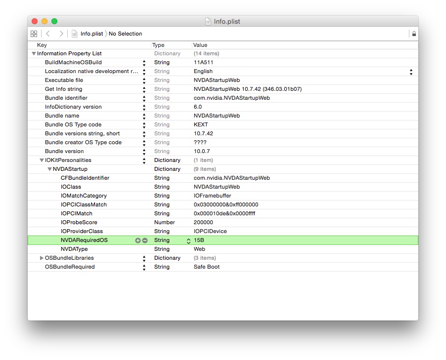

fantomas Posted September 18, 2015 Author Share Posted September 18, 2015 hi. any news about gm driver? the last 346.03.01b07 webdriver is the same for DB7/PB5/DB8/PB6/GM it also works fine with the first 10.11.1 build 15B17c beta... just have to edit the NVDAStartupWeb.kext Info.plist file NVDARequiredOS section 15A to 15B Link to comment https://www.insanelymac.com/forum/topic/306535-nvidia-web-driver-updates-for-el-capitan-update-07112018/page/3/#findComment-2168812 Share on other sites More sharing options...

fantomas Posted September 19, 2015 Author Share Posted September 19, 2015 are you saying you got these drivers to work with the GM release? I have heard they do not work nvidia is, not me <key>OS</key> <!-- GM Seed --> <string>15A282b</string> <key>models</key> <array> </array> <key>version</key> <string>346.03.01b07</string> Link to comment https://www.insanelymac.com/forum/topic/306535-nvidia-web-driver-updates-for-el-capitan-update-07112018/page/3/#findComment-2168956 Share on other sites More sharing options...
rhcp011235 Posted September 20, 2015 Share Posted September 20, 2015 nvidia is, not me <key>OS</key> <!-- GM Seed --> <string>15A282b</string> <key>models</key> <array> </array> <key>version</key> <string>346.03.01b07</string> So, when you upgrade to the GM seed. These drivers work OOTB? or do you need to modify something? I have been reading on here. they don't work? If someone can please reply with a clear and concise answer. With the needed edits if any are needed. Thank you! Link to comment https://www.insanelymac.com/forum/topic/306535-nvidia-web-driver-updates-for-el-capitan-update-07112018/page/3/#findComment-2169160 Share on other sites More sharing options...
fantomas Posted September 20, 2015 Author Share Posted September 20, 2015 I don’t know how you can obtain more 'clear and concise’ answer if you don’t read what I’m telling you. the last 346.03.01b07 webdriver is the same for DB7/PB5/DB8/PB6/GM it also works fine with the first 10.11.1 build 15B17c beta... just have to edit the NVDAStartupWeb.kext Info.plist file NVDARequiredOS section 15A to 15B it means that you only have to install this driver in GM and it will work fine (no additional kext editing required). don’t forget to set GraphicsEnabler on Yes if you use chameleon and Nvidia on True if you use clover you don’t have to add nvda_driver=1 boot flag... the installer will add it for you in nvram.plist file 1 Link to comment https://www.insanelymac.com/forum/topic/306535-nvidia-web-driver-updates-for-el-capitan-update-07112018/page/3/#findComment-2169168 Share on other sites More sharing options...

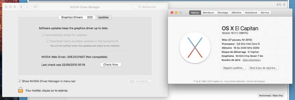

Fljagd Posted September 21, 2015 Share Posted September 21, 2015 Hi, Nvidia Web Driver - 346.03.01b07 is not good for me with 10.11.1 you have new? Fred Link to comment https://www.insanelymac.com/forum/topic/306535-nvidia-web-driver-updates-for-el-capitan-update-07112018/page/3/#findComment-2169545 Share on other sites More sharing options...
Fljagd Posted September 22, 2015 Share Posted September 22, 2015 Hi, Nvidia Web Driver - 346.03.01b07 is not good for me with 10.11.1 you have new? Fred problem set, I started without WebDriver I made a repair permissions, and everything is back to normal Fred 2 Link to comment https://www.insanelymac.com/forum/topic/306535-nvidia-web-driver-updates-for-el-capitan-update-07112018/page/3/#findComment-2169622 Share on other sites More sharing options...
