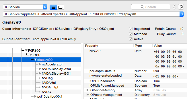

toleda Posted December 20, 2014 Share Posted December 20, 2014 My bios is 82.07.32 and DVI not working.. Just VGA 4 framebuffer connectors? Attach IOReg. Link to comment https://www.insanelymac.com/forum/topic/302628-gtx-750-ti/#findComment-2096456 Share on other sites More sharing options...
fanfan71100 Posted December 21, 2014 Share Posted December 21, 2014 My IoReg : IOREG.rtf Link to comment https://www.insanelymac.com/forum/topic/302628-gtx-750-ti/#findComment-2096695 Share on other sites More sharing options...
toleda Posted December 21, 2014 Share Posted December 21, 2014 My IoReg : Only 2 framebuffer connectors are present, should be 4. Install this IOReg, File/Save a Copy As ..., attach file IORegistryExplorer_v2.1.zip (View Raw) 1 Link to comment https://www.insanelymac.com/forum/topic/302628-gtx-750-ti/#findComment-2096728 Share on other sites More sharing options...

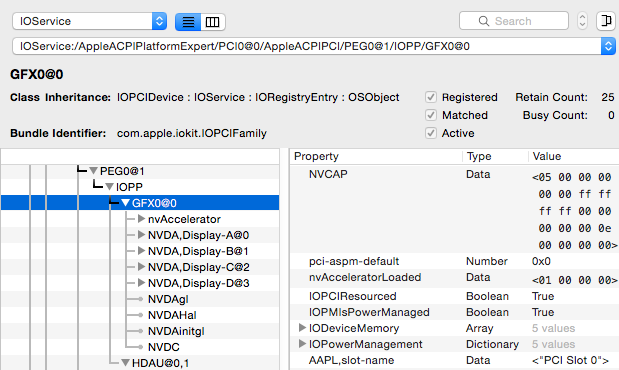

toleda Posted December 22, 2014 Share Posted December 22, 2014 ok so.. this is the file : Something is wrong with your install, try 343.02.01f01 (System Preferences/Nvidia Driver Manager) Still not working, suggest uninstall/install Nvidia web drivers. Your IOReg/750/2 connectors/wrong NVCAP (DVI/HDMI missing) Correct IOReg/750/4 connectors/correct NVCAP 1 Link to comment https://www.insanelymac.com/forum/topic/302628-gtx-750-ti/#findComment-2097167 Share on other sites More sharing options...
