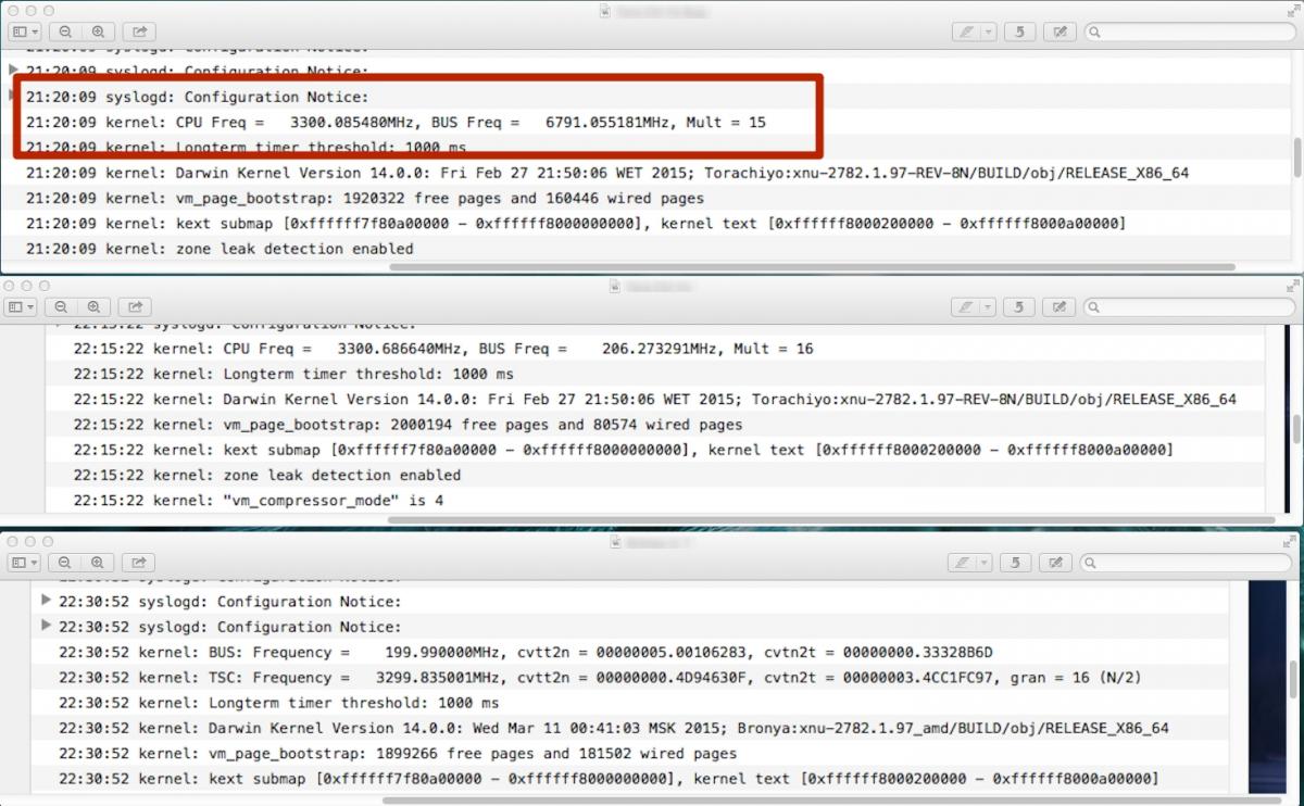

J0hny Posted July 16, 2015 Share Posted July 16, 2015 (edited) Hello everyone! I think I've found a bug in Tora Chi Yo kernel, you can see it in the screenshot below. Strange thing was happening to me since I have installed 10.10.3, sometimes my system couldn't boot, or it boot and then my system is very laggy, but like I said it was happening only sometimes, not always. And I tried to figure out what’s wrong, and I think I just found the problem. So I replaced my Tora Chi Yo kernel with rc7 kernel of Bronya and then that bug was gone. The bus frequency and cpu frequency was correct when booting. And with bronya rc7 kernel the same situation, which was in mavericks - l3 cache is 24 mb in profile, but in sysctl -a everything is correct, so it’s cosmetic. When i’ve used Tora Chi Yo kernel, and when I’ve tried to change bus speed and cpu frequency in clover config - still there was no change (actually it was, but both frequencies was too high when booting and when system was booted - frequencies was correct), with bronya kernel no problem. But Tora Chi Yo kernel is very good and stable, no problems with apps, only this boot problem. upd. Strange, but when I delete bus and cpu frequencies fields in clover configurator, and boot with 8N kernel, the cpu freq was correct, but bus was 206MHz and multiplier 16, so it's bus freq problem in 8N. Again it's only when system boots. Maybe only I have this problem in my system, I don't know. Will stay with rc7 for now...))) Edited July 17, 2015 by ImmortalSoulL Link to comment https://www.insanelymac.com/forum/topic/302075-amd-yosemite-kernel-testing-for-help-use-the-help-topic/page/51/#findComment-2153628 Share on other sites More sharing options...

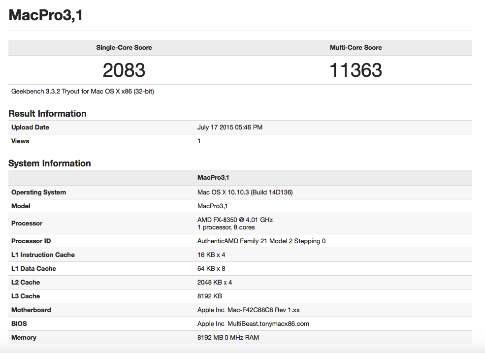

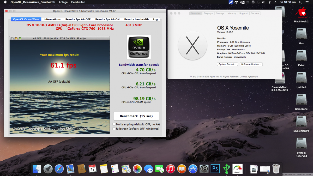

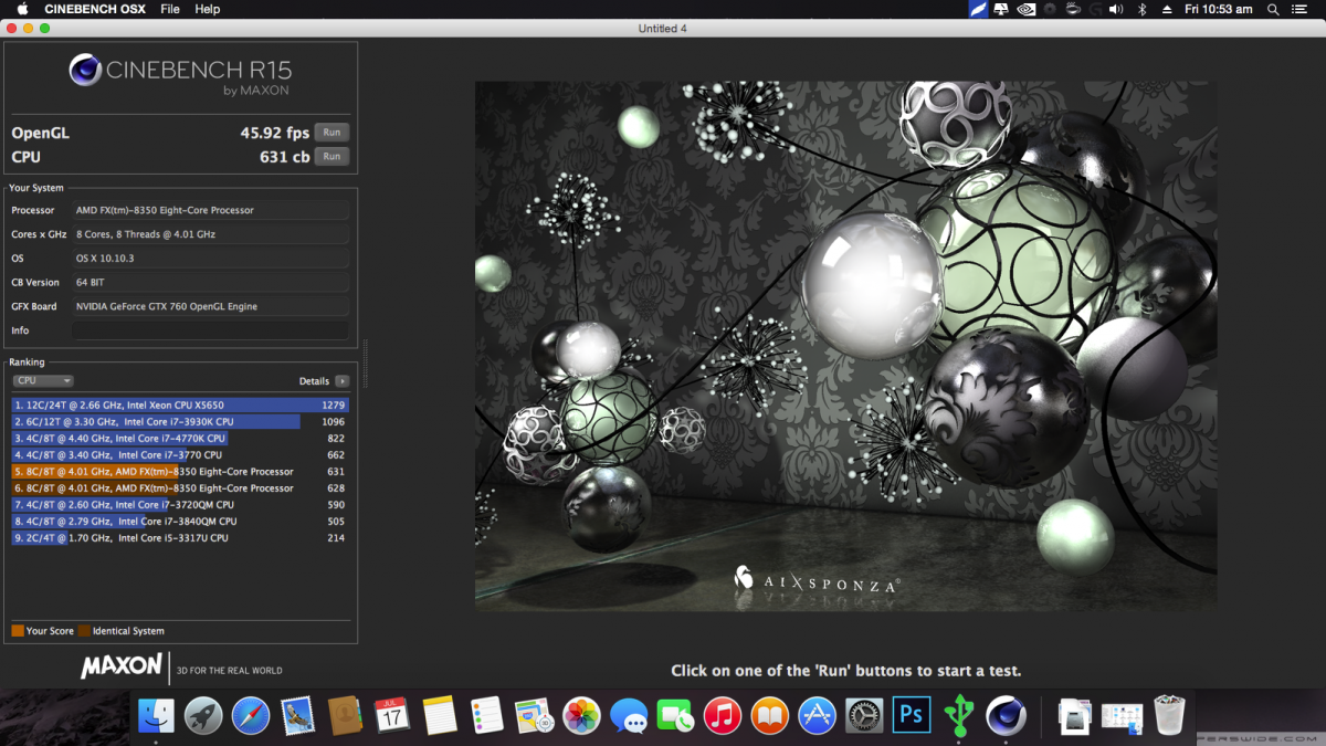

Avishek Posted July 19, 2015 Share Posted July 19, 2015 Successfully Installed Yosemite 10.10.3 on AMD FX 8350 with Tora Chi Yo - 1010-kernel-REV-8N + pthread.kext These are my benchmark results. 3 Link to comment https://www.insanelymac.com/forum/topic/302075-amd-yosemite-kernel-testing-for-help-use-the-help-topic/page/51/#findComment-2154100 Share on other sites More sharing options...

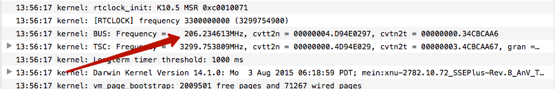

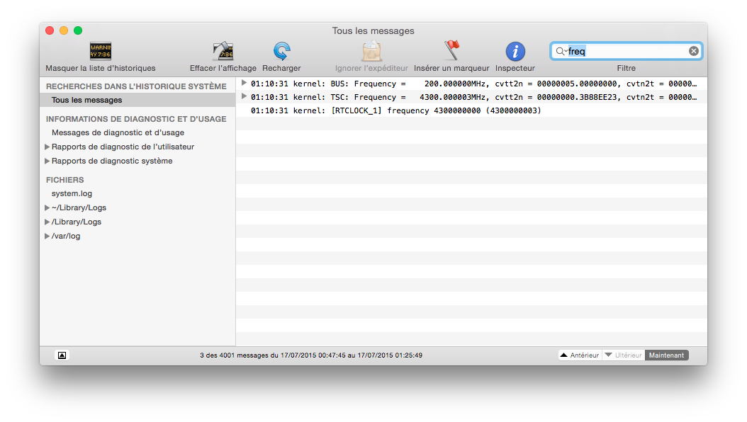

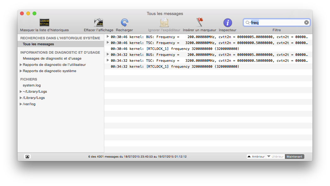

J0hny Posted August 5, 2015 Share Posted August 5, 2015 I've test this kernel and it's working, thank you very much! But bus frequency is incorrect when my system is booting. But with bronya kernel every thing is correct. This incorrect bus speed can cause my system will not boot sometimes, I talked about it here: #1286 . And here some screenshots (second screenshot with bronya kernel): Link to comment https://www.insanelymac.com/forum/topic/302075-amd-yosemite-kernel-testing-for-help-use-the-help-topic/page/51/#findComment-2158054 Share on other sites More sharing options...
