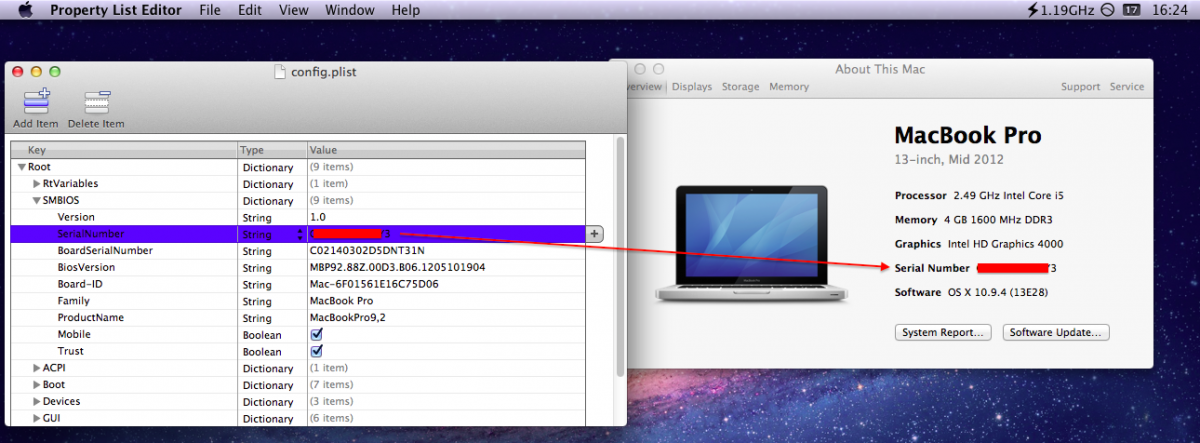

Can somebody help me, please? If I "install" AppleACPIPlatform kext with kext wizard to get battery information on my notebook, no serial number is inside about my mac anymore. How can I fix that?

Thanks to this thread and the site of RehabMan I fixed that problem with a DSDT patch. So I don't need any AppleAHCPIPlatform kext anymore, only the ACPIBatteryManager kext :)
/edit: Yes, I could not login to the App Store without serial number ;)

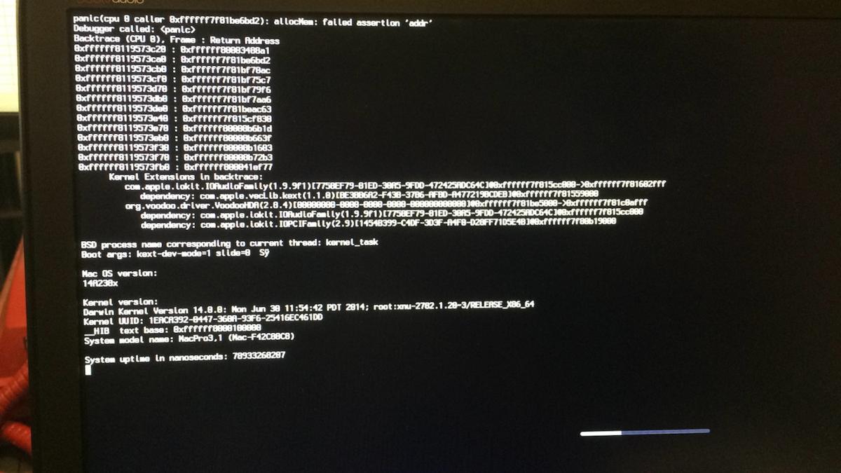

I installed using MacPwn, it was the only thing that worked for my HP Envy laptop, and I installed Yosemite onto an external HD and after installation when I try to boot into the HD this is the error message that I get right before it restarts, any ideas please?

After a lot of trying I was able to boot the installer with Clover +  kext-dev-mode=1 -v GraphicsEnabler=No ncpi=0x2000 USBBusFix=1
Let's see if the installation will work now :)
