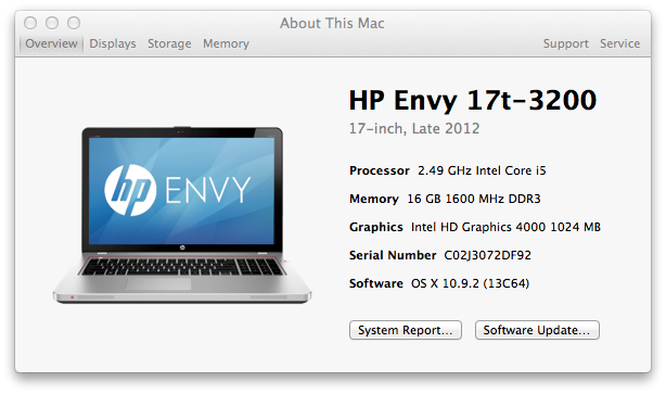

Installation is becoming quite routine for 10.9.2.  After the initial installation and before the first reboot, I need to boot into another installation of OS X on a 10 GB partition.  Once there, I need to patch the kernel, use prior versions of AppleACPIPlatform.kext, AppleIntelCPUPowerManagement.kext, AppleSmartBatteryManager.kext, and IOPlatformPluginFamily.kext.  Then, repair permissions.  Reboot and complete installation.
If I don't do these things, I can still boot up but I get no battery detection and I lose speedstepping.  One of these days, I will fix those problems without resorting to using older kexts.  For now, it works like a charm.
