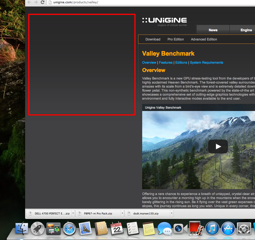

Alex009988 Posted March 22, 2013 Share Posted March 22, 2013 Hello. I have a little problem with ATICard. It doesn't metter on what I look at site, programe, or picture. When I have lines which located very close by each other, I see the glimmer. Am I can try to correct it? Or there is unfounded waste of time? There is my video bios Last login: Sat Jun 23 21:04:12 on ttys000 imac-admin:~ admin$ sudo -s Password: bash-3.2# /Users/admin/Desktop/redsock_bios_decoder </Users/admin/Desktop/vgabios.dmp BR35516.001 : BROADWAY Pro with DDR3 800m/625e Subsystem Vendor ID: 1025 Subsystem ID: 30a Object Header Structure Size: 258 Connector Object Table Offset: 3e Router Object Table Offset: 0 Encoder Object Table Offset: c6 Display Path Table Offset: 12 Connector Object Id [14] which is [LVDS] encoder obj id [0x1e] which is [iNTERNAL_UNIPHY (osx txmit 0x10 [duallink 0x0] enc 0x0)] linkb: false Connector Object Id [19] which is [DISPLAY_PORT] encoder obj id [0x21] which is [iNTERNAL_UNIPHY2 (osx txmit 0x12 [duallink 0x2] enc 0x4)] linkb: false Connector Object Id [12] which is [HDMI_TYPE_A] encoder obj id [0x20] which is [iNTERNAL_UNIPHY1 (osx txmit 0x11 [duallink 0x1] enc 0x2)] linkb: false Connector Object Id [5] which is [VGA] encoder obj id [0x15] which is [iNTERNAL_KLDSCP_DAC1 (osx txmit 0x00 enc 0x10?)] linkb: false bash-3.2# mac-admin:~ admin$ /Users/admin/Downloads/radeon_bios_decode < /Users/admin/Desktop/Turks.bin ATOM BIOS Rom: SubsystemVendorID: 0x1025 SubsystemID: 0x030a IOBaseAddress: 0x2000 Filename: BR35516.001 BIOS Bootup Message: BROADWAY Pro with DDR3 800m/625e PCI ID: 1002:68a1 Connector at index 0 Type [@offset 45414]: LVDS (7) Encoder [@offset 45418]: INTERNAL_UNIPHY (0x1e) i2cid [@offset 45506]: 0x93, OSX senseid: 0x4 Connector at index 1 Type [@offset 45424]: DisplayPort (10) Encoder [@offset 45428]: INTERNAL_UNIPHY2 (0x21) i2cid [@offset 45529]: 0x91, OSX senseid: 0x2 Connector at index 2 Type [@offset 45434]: HDMI-A (11) Encoder [@offset 45438]: INTERNAL_UNIPHY1 (0x20) i2cid [@offset 45556]: 0x90, OSX senseid: 0x1 Connector at index 3 Type [@offset 45444]: VGA (1) Encoder [@offset 45448]: INTERNAL_KLDSCP_DAC1 (0x15) i2cid [@offset 45583]: 0x92, OSX senseid: 0x3 mac-admin:~ admin$ There is native vervet 0000000 00 04 00 00 00 04 00 00 00 71 00 00 12 04 04 02 0000010 04 00 00 00 14 00 00 00 00 71 00 00 01 12 01 04 0000020 00 02 00 00 14 00 00 00 00 71 00 00 00 00 06 03 0000030 00 08 00 00 00 02 00 00 00 71 00 00 22 05 05 01 And it is patched vervet 02 00 00 00 40 00 00 00 09 00 00 00 10 00 00 04 00 04 00 00 04 07 00 00 00 00 00 00 12 04 01 02 00 08 00 00 04 02 00 00 00 00 00 00 11 02 02 01 10 00 00 00 10 00 00 00 00 00 00 00 00 10 03 03 When I have something like this with little stipes I see shimmering. Link to comment https://www.insanelymac.com/forum/topic/287289-blinking-strips-of-ati-card/ Share on other sites More sharing options...

Alex009988 Posted March 22, 2013 Author Share Posted March 22, 2013 maybe edit Alouatta instead since it's mobile with LVDS already? Thank you that your answer me but the problem remained with Alouatta as well.(I checked it on this link http://unigine.com/products/valley/) Namely checked it on site, not programe Attached my DSDT just in case(replaced Vervet to Alouatta). My DSDT is injector for Graphics. Any suggestions else? DSDT.aml.zip Link to comment https://www.insanelymac.com/forum/topic/287289-blinking-strips-of-ati-card/#findComment-1899813 Share on other sites More sharing options...

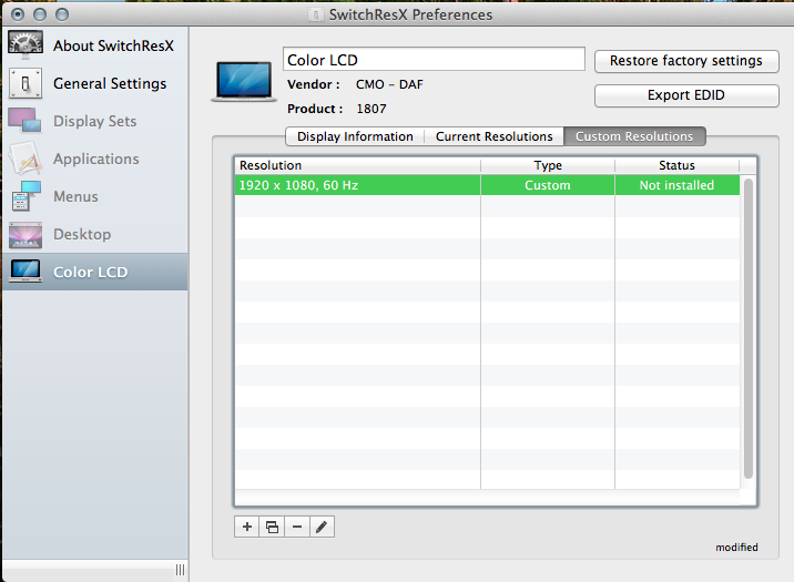

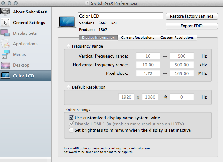

Alex009988 Posted April 23, 2013 Author Share Posted April 23, 2013 I think that I took a trace. The problem is that some of the parameters don't coincide that Windows has. And it seem's that problem can be solved by the program called SwitchResX. But I could save profile, but unfortunately I couldn't install it. How to install profile of SwitchRexX? This information have taken by Windows 8 EDID ( Extended Display Identification Data) Report Vendor/Product Identification: Monitor Name : Monitor Serial Number : Manufacturer Name : CMO Product Id : 1807 Serial Number : 0 Week Of Manufacture : 2 Year Of Manufacture : 2009 EDIDVersion : V1.3 Number Of Extension Flag : 0 Display parameters: Video Input Definition : Digital Signal DFP1X Compatible Interface : False Max Horizontal Image Size : 410 mm Max Vertical Image Size : 230 mm Max Display Size : 18,5 Inches Power Management and Features: Standby : Not Supported Suspend : Not Supported ActiveOff : Not Supported Video Input : 1 sRGB Default ColorSpace : False Default GTF : Not Supported Prefered Timing Mode : True Gamma/Color and Etablished Timings: Display Gamma : 2,2 Red : x = 0,624 - y = 0,361 Green : x = 0,337 - y = 0,607 Blue : x = 0,164 - y = 0,086 White : x = 0,313 - y = 0,329 Etablished Timings : Display Type : RGB Color Display Standard Timing: Preferred Detailed Timing: Pixel Clock : 138,65 Mhz Horizontal Active : 1920 pixels Horizontal Blanking : 160 pixels Horizontal Sync Offset : 48 pixels Horizontal Sync Pulse Width : 32 pixels Horizontal Border : 0 pixels Horizontal Size : 408 mm Vertical Active : 1080 lines Vertical Blanking : 31 lines Vertical Sync Offset : 3 lines Vertical Sync Pulse Width : 5 lines Vertical Border : 0 lines Vertical Size : 230 mm Input Type : Digital Separate Interlaced : False VerticalPolarity : False HorizontalPolarity : False Monitor Range Limit: Maximum Vertical Frequency : 0 Hz Minimum Vertical Frequency : 0 Hz Maximum Horizontal Frequency : 0 KHz Minimum Horizontal Frequency : 0 KHz Maximum Pixel Clock : 0 MHz Stereo Display: Stereo Display : Normal display (no stereo) RAW Data: 0x00 00 FF FF FF FF FF FF 00 0D AF 07 18 00 00 00 00 0x10 02 13 01 03 80 29 17 78 0A E6 05 9F 5C 56 9B 2A 0x20 16 50 54 00 00 00 01 01 01 01 01 01 01 01 01 01 0x30 01 01 01 01 01 01 29 36 80 A0 70 38 1F 40 30 20 0x40 35 00 98 E6 10 00 00 18 00 00 00 FE 00 4E 31 38 0x50 34 48 36 2D 4C 30 32 0A 20 20 00 00 00 FE 00 43 0x60 4D 4F 0A 20 20 20 20 20 20 20 20 20 00 00 00 FE 0x70 00 4E 31 38 34 48 36 2D 4C 30 32 0A 20 20 00 35 Help me, please! I can't find a solution of this issue. Link to comment https://www.insanelymac.com/forum/topic/287289-blinking-strips-of-ati-card/#findComment-1909883 Share on other sites More sharing options...
