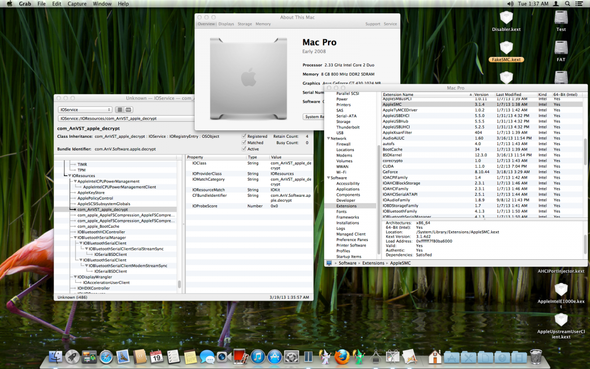

hmmm, it only shows up in the bootlog, not in ioregistry, not in loaded extensions either...where is that little bugger hiding?(i have rebuilt caches...also deleted the caches and let os rebuild them) no waiting for dsmos...just arrived....and earlier in the boot process than with dsmos loaded :smoke:
Good. So the kext arrives.
It should work thus. ;)

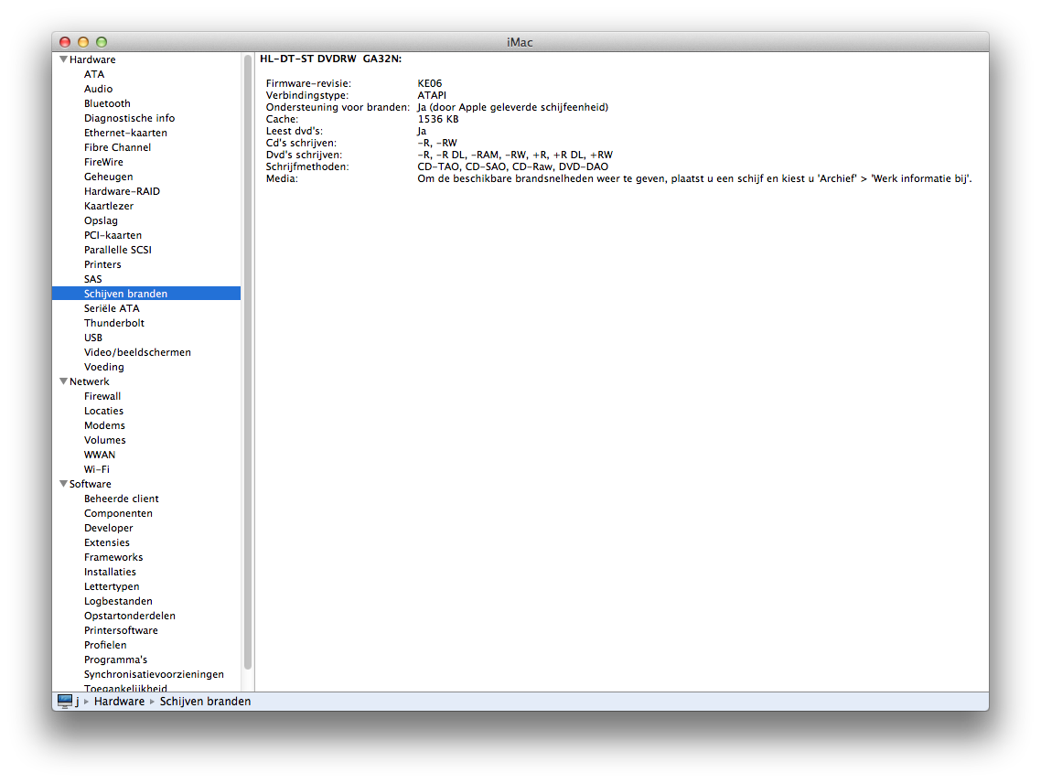

I reworked the old driver of me and now it works on AHCI.
You need to edit the Info.plist as follows:
Open IORegistryExplorer.
Open Info.plist inside kext.
Look up your SATA controller and look under IOAHCISerialATAPI.
Copy the model data.
Paste it into the plist under AHCI ID injection instead of:
TSSTcorp CDDVDW SH-222BB
One level lower in IORegistryExplorer you have IOSCSIPeripheralDeviceNub, look under it.
Copy the Vendor Identification and paste it instead of:
TSSTcorp
Copy the Product Identification and paste it instead of:
CDDVDW SH-222BB
Save the plist and install the driver.
Enjoy ;)

Thanks for this Andy. When I upgraded to a motherboard without IDE I had to replace my trusty old Pioneer DVR-111D and the drive I got (DVR-219L) wasn't detected as a SuperDrive. I tried to find some way to inject the model but couldn't find where OS X stores its list of SuperDrive models.
With a few extra edits I've now renamed it to a DVR-117D and it shows up as a SuperDrive :)
