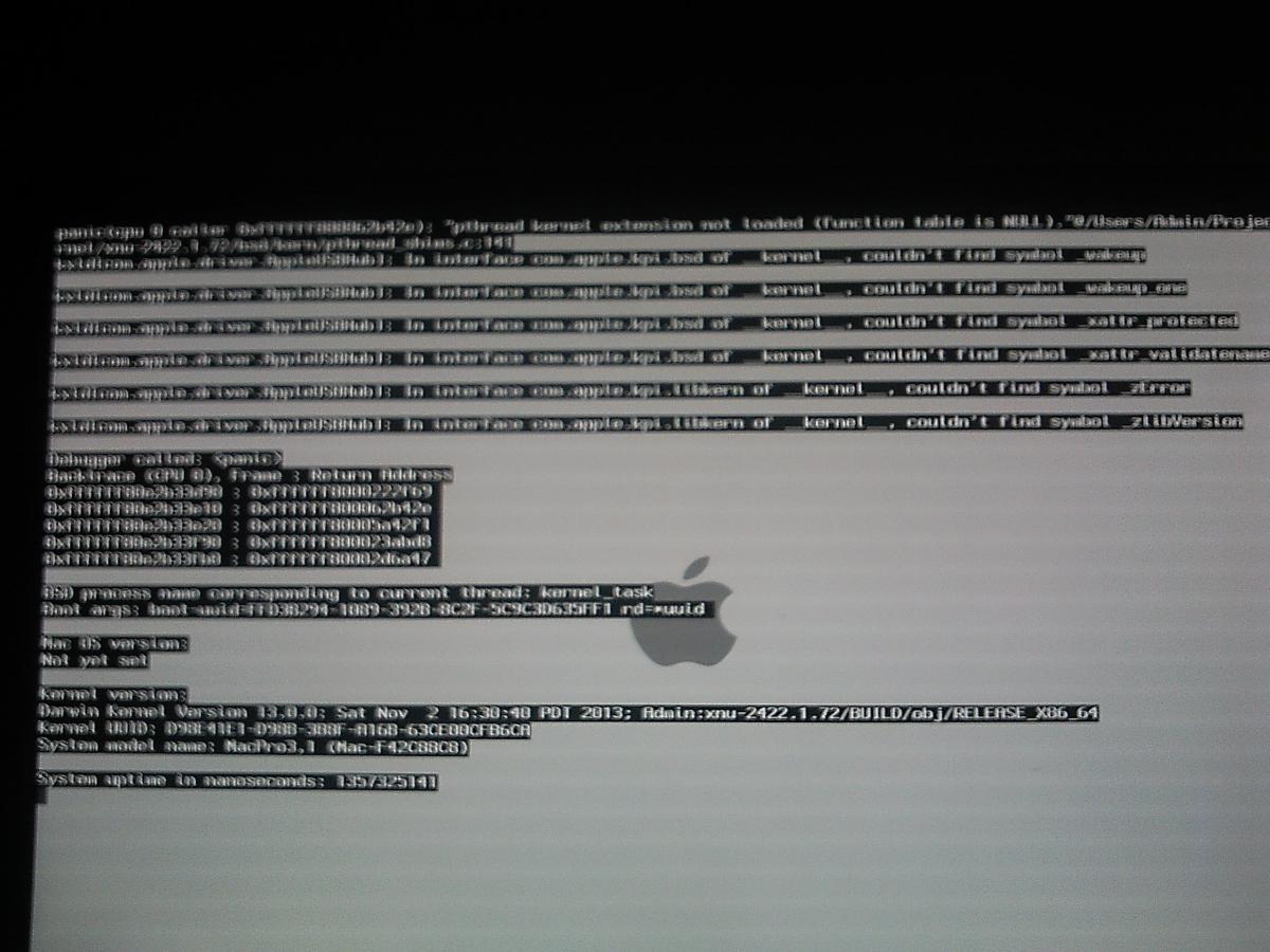

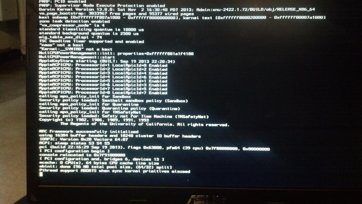

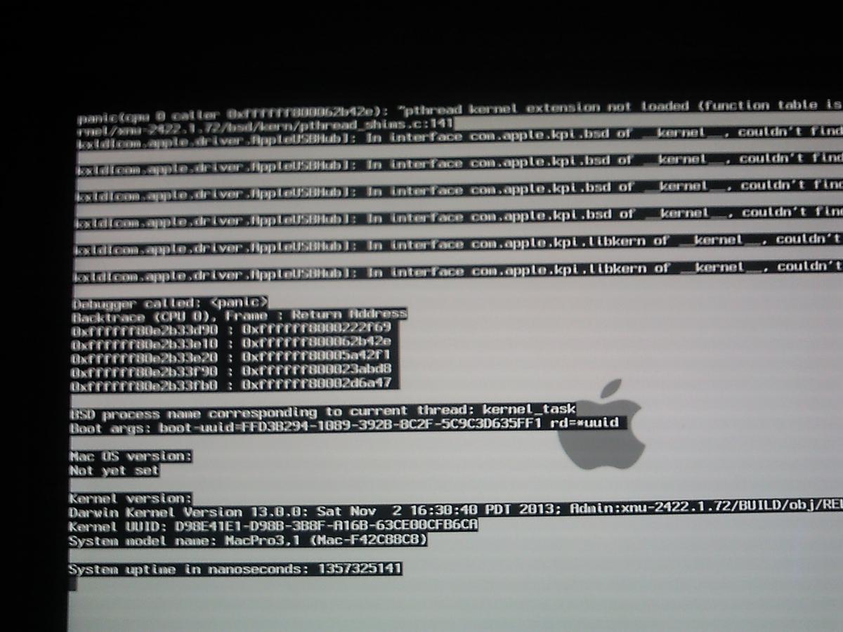

Having problem installing mavericks 10.9.1 on ASUS G75 Series G750JW-DB71 Intel Core i7 4700HQ  with NVIDIA GeForce GTX 765M
Initailly I was getting a quick reboot when it looked like it was enabling the graphics screen.. I replaced the kernal with the one you had at the beginning of this thread.. It now hangs as below (definitely farther than before) any suggestions..
FYI I built my boot image using myhack 3.3.1  I removed all the apple intel graphics drivers as I was told that was an issue..
Thanks for any help..
I've never used myhack and don't recommend it. Do a vanilla install instead, so you know what the heck you have...
Since your laptop has nvidia optimus (not supported), you will probably need to remove the nvidia kexts.
Hello jradomski, I tried using myhack as well and so far it has only left to problems. I was able to boot into the installer, but with an error message stating that I must restart my computer.
I am not sure what was missing, but just as Rehab stated, we are better off using a vanilla install to make sure we have all essentials in-place
Try using various bootflags such as npci=0x2000 and npci=0x3000. graphicsenabler=no and delete NVidia kexts
