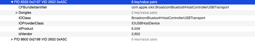

I tried to updated the IOProviderClass IOUSBDevice to IOUSBHostDevice in several injectors and none of them work (in /S/L/E, and in Efi/C/...)
Can you share one that is working for you ?
(for information I've got a BCM94352 ...)
Some bt needs a bluetooth firmware uploader to work. If it's your case (in 10.10 you need brcmpatchram or btformwareuploader), you have to wait until developer update the code, or try modifying the info.plist. Lisai9093 has success with modified btformwareuploader, hope he can post the kext.
You need to change it in both places for BTFirmwareUploader.kext
AppleBroadcomBTUSBController_xxxx and Info- BCM - xxxxx
For WifiInjector to use with vanilla BTFirmwareUploader.kext, I need to add a new key for my DW1560-NGFF

u can try inject something like this
or use rehab new injector kext for el cap
https://bitbucket.org/RehabMan/os-x-brcmpatchram/downloads
only use the injector

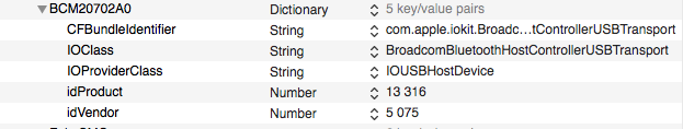

Mine is the Asus version of the AzureWave AW-CE 123H.  (PID 6095 VID 2821)  I modified the injector kext myself.  Here is what is working for me.
BCM20702A0Injector.kext.zip
For 10.10 and prior: BrcmPatchRAM.kext
For 10.11: BrcmBluetoothInjector.kext.
Both available here: https://github.com/RehabMan/OS-X-BrcmPatchRAM
Hint: 10.11 seems to have Broadcom bluetooth firmware uploader built-in. No need for firmware uploader kext, only injector kext for IOKitPersonality needed.

I just checked. That vid/pid combo is already in BrcmBluetoothInjector.kext (and BrcmPatchRAM.kext).

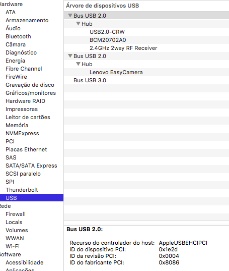

Check ioreg to see if your USB controllers are working correctly.
Note: http://www.insanelymac.com/forum/topic/306777-guide-usb-fix-el-capitan-1011/
No chance of USB bluetooth device working if USB controllers aren't fully working.

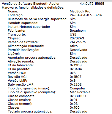

My Bluetooth is vid 0930 pid 0223 and the new kexts that inject id doesn't work. Actually it works, but the firmware version is c4096, and on windows it's 5545. So there's an icon but it can't do anything.
Is there any kext that can upload the right firmware? BTFirmwareuploader tried, no effect. On 10.10 it works.

So I was able to fix the bluetooth with your FakePCIID kexts, FakePCIID_XHCIMux.kext and the BrcmBluetoothInjector.kext and applied kext patch for the handoff from here http://www.insanelym...mini/?p=2143521
Nothing else worked, but even before I used those kexts the USB was seemingly working, so not sure why the bluetooth didn't show up.

No bluetooth device on the USB bus in this ioreg. Likely USB problem.
