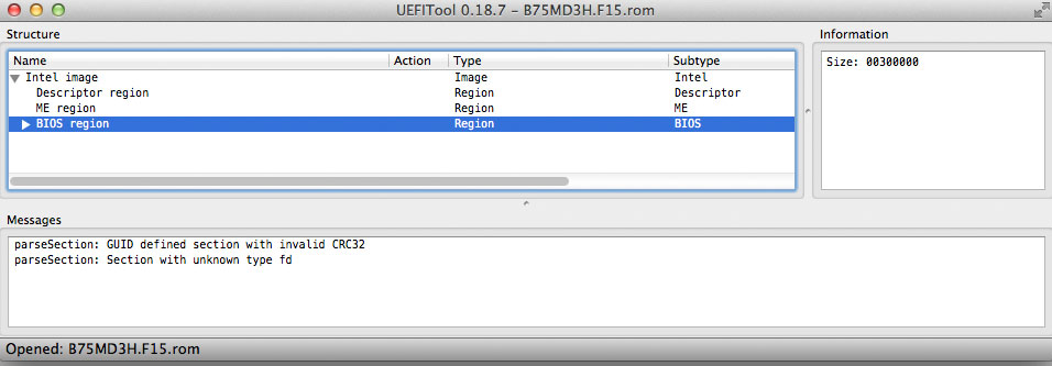

I failed update 1479 latest version,
I attached B75M-D3H.F15 BIOS.
I success 828, but, I can not continue using latest version,
Please, check my BIOS,
http://rghost.net/58140237
Opening your bios image using Coderush's UEFITool 0.18.7 in OS X shows invalid CRC32 and unknown type fd messages.
Maybe that's the problem?
