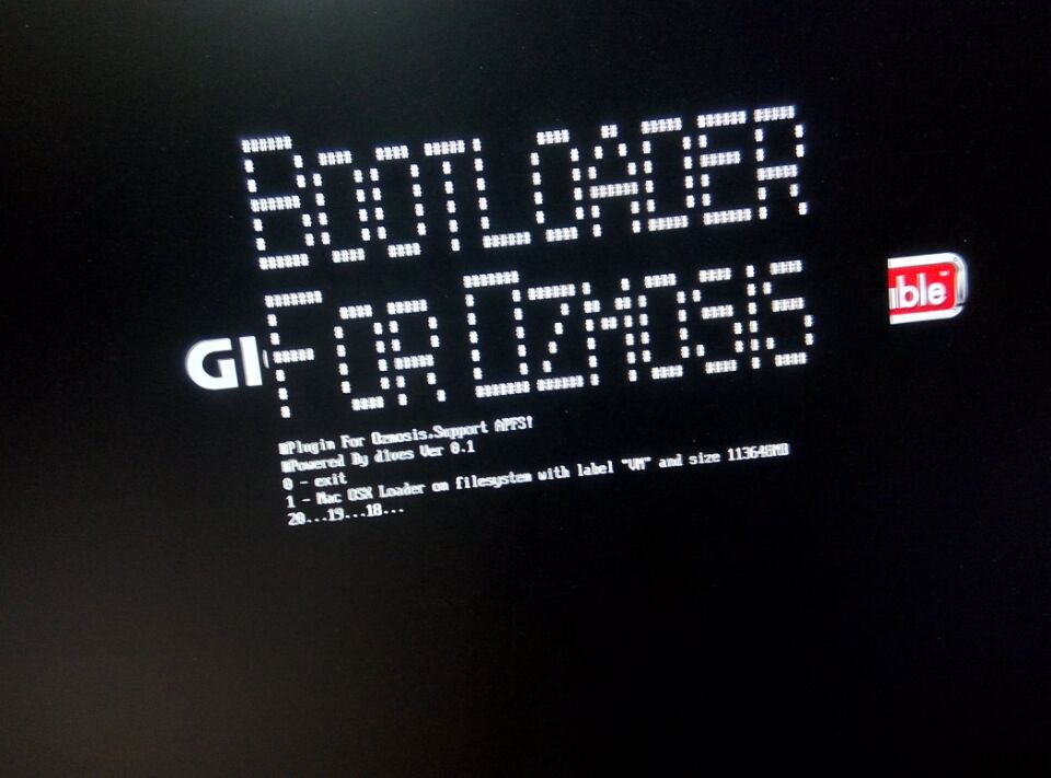

hey bros,i made a litte plug,so that i can boot with apfs,
BootLoader.efi.zip
apfs2.ffs.zip
USAGE:
insert apfs.ffs to your rom,and flash it.
copy to the EFI partition,use easyuefi to add boot items,or rename it to bootx64.efi,copy to EFI\BOOT\,cover original.
PRESS F12 when power on,chose the boot item or ORIGINAL UEFI item
PS:this plug is Non originality by me
