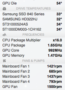

Riley Freeman Posted October 28, 2013 Share Posted October 28, 2013 My GTX 660 works out of the box on my Hack in 10.9, though for some reason I don't have QE/CI when booting my installer partition. You also don't have power management. If you check you'll see the card is running in it's highest power state from boot. Link to comment Share on other sites More sharing options...
Gringo Vermelho Posted October 28, 2013 Share Posted October 28, 2013 I don't have hwmonitor installed yet but the Heaven benchmark shows GPU temp. Letting it run, it'll reach 82 degrees after a while (as it always has), but if I stop it by clicking the menu bar temps quickly drop down below 60 degrees. AFAIR idle temp was about 35 degrees in Mountain Lion. Let me grab hwmonitor and I'll see what I can see. /EDIT yep Riley you're right..it seems to be cooking at full throttle: On Windows, only Firefox open, it jumps around a bit but temps stay reasonable:GPU 324-744-769 MHzMEM 162-405-1502 MHzTMP 37-38CFAN 30% - 1230 RPM Link to comment Share on other sites More sharing options...
