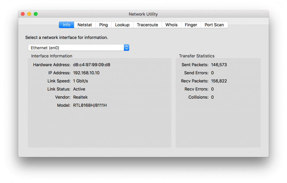

macky1 Posted August 13, 2019 Share Posted August 13, 2019 On 4/9/2019 at 5:05 PM, macky1 said: Thank you for your suggestion will try it out. I've got a feeling it is the network stack and thus possibly Mojave bug. So far in testing of beta RealtekRTL8111-V2.3.0d5 it works good. Whatever the issue was with the driver v2.2.2 using RTL8111H on Mojave it has disappeared in this version. Internet starts up every time now. Thanks Mieze for the updated driver. On 8/5/2019 at 7:52 PM, Roran90 said: I have the same issue, how did you solve the issue? I tried a clear cmos, I changed the cable but still have the problem and it is very annoying Try beta version RealtekRTL8111-V2.3.0d5 and see how it goes. So far for me it works good. Link to comment https://www.insanelymac.com/forum/topic/287161-new-driver-for-realtek-rtl8111/page/56/#findComment-2685750 Share on other sites More sharing options...

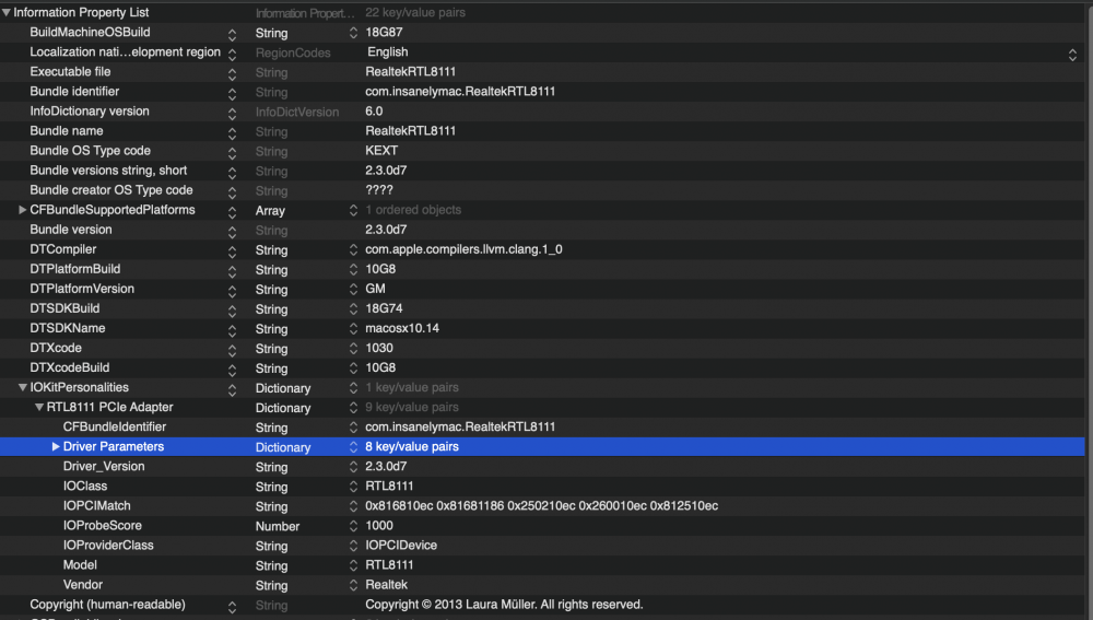

Mieze Posted August 14, 2019 Author Share Posted August 14, 2019 (edited) @toperloid This one is especially for you but all users are encouraged to test it! Here is version 2.3.0d7 in which I added an option to supply a fallback MAC being used in situations when retrieving a valid MAC address fails. In the driver's Info.plist I added the option "fallbackMAC" to "Driver Parameters". "fallbackMAC" is a string which may be used to supply your original MAC address. It is used only if retrieving a valid MAC address fails. In the default configuration, the string is empty. In case you need it, please fill in your MAC with the following syntax "xx:xx:xx:xx:xx:xx" in which every x represents exactly one hexadecimal digit. Warning: This is not an option for MAC address customization and I won't add such an option because it would be stupid to do so. Use with care because MAC addresses have to be unique. Using another machine's MAC address may produce unexpected results! PS: Could anybody be so nice to test test WoL with this built because it doesn't work on my test machine and I have reasons to beliefe that it's not the driver's responsibility. RealtekRTL8111-V2.3.0d7.kext.zip Edited August 14, 2019 by Mieze 1 1 Link to comment https://www.insanelymac.com/forum/topic/287161-new-driver-for-realtek-rtl8111/page/56/#findComment-2686166 Share on other sites More sharing options...

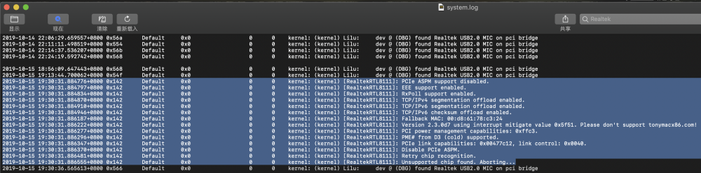

Leoyzen Posted October 15, 2019 Share Posted October 15, 2019 Hello, I have MSI X570 Ace board which has an nic r8125. I try beta7 kext but no luck. I found 0x812510ec not in info.plist so I manually add it but the kext can't find my ethernet. Here is info.plist of this kext: and here is the log: full log: r8125.log Link to comment https://www.insanelymac.com/forum/topic/287161-new-driver-for-realtek-rtl8111/page/56/#findComment-2693689 Share on other sites More sharing options...
Mieze Posted October 15, 2019 Author Share Posted October 15, 2019 @Leoyzen Sorry but this chip isn't supported by the driver! Mieze Link to comment https://www.insanelymac.com/forum/topic/287161-new-driver-for-realtek-rtl8111/page/56/#findComment-2693738 Share on other sites More sharing options...

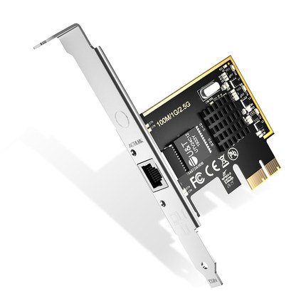

Henry2010 Posted October 17, 2019 Share Posted October 17, 2019 (edited) Just my two cents in case any of us decides to get one. There is a RTL8125 card on Aliexpress. And this https://www.realtek.com/en/component/zoo/category/network-interface-controllers-10-100-1000m-gigabit-ethernet-pci-express-software Edited October 17, 2019 by Henry2010 Link to comment https://www.insanelymac.com/forum/topic/287161-new-driver-for-realtek-rtl8111/page/56/#findComment-2693891 Share on other sites More sharing options...
Roran90 Posted October 18, 2019 Share Posted October 18, 2019 Hi @Mieze, with the latest driver my ethernet works fine but sometimes when I turn on my hackintosh, it has a self-assigned ip and I need to unplug the cable from router then plug in again and a new IP is assigned.Could this be a driver issue or it depends from something else in the configuration? thanks Link to comment https://www.insanelymac.com/forum/topic/287161-new-driver-for-realtek-rtl8111/page/56/#findComment-2694063 Share on other sites More sharing options...
Mieze Posted October 18, 2019 Author Share Posted October 18, 2019 (edited) @Roran90 Sounds more like a DHCP related problem. Anyway, check the kernel logs to see what's going on! @Henry2010 Yesterday I ordered one of these RTL8125 add-on cards on aliexpress but it won't be delivered before mid of November. Edited October 18, 2019 by Mieze 5 Link to comment https://www.insanelymac.com/forum/topic/287161-new-driver-for-realtek-rtl8111/page/56/#findComment-2694106 Share on other sites More sharing options...
