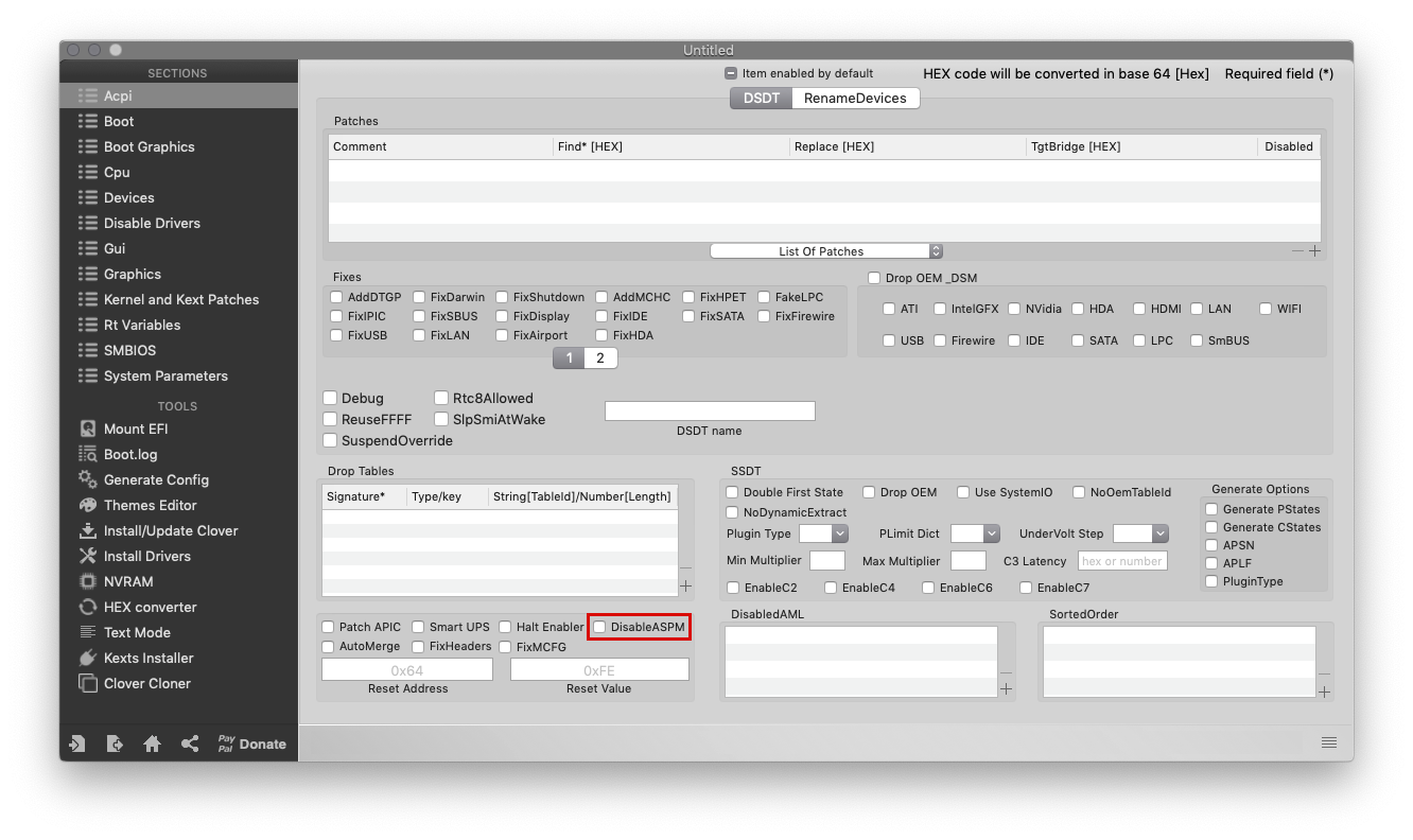

On 2/11/2019 at 3:53 PM, pharic said:
Having problems with RTL8111H on High Sierra. Adapter appears, but only works a few times. Usually I have to restart 3 times the computer to get it working, the rest of times It doesn't works or It works too slowly. I can't find any ASPM option in my B350M Bazooka bios.
Did it work before? Could you, please, add your complete hardware information to your signature? It might help. I'm guessing this is an AMD system, right?
Also, if you don't have an ASPM option in BIOS (which not all motherboard manufacturers add to their BIOS), you have one in Clover config, in ACPI -> Disable ASPM.
Also, this might help:
"Use the debug version to collect log data when trying to track down problems. The kernel log messages can be found in /var/log/system.log. For Sierra and above use "log show --predicate "processID == 0" --debug" in order to retrieve kernel logs. Include the log data when asking for support or giving feedback. I'm an engineer, not a clairvoyant." LOL, Mieze. :))
 483486844_Screenshot2019-02-14at11_15_08.thumb.png.112eaa42bb85b60f2b8cf2c4e3eab9d1.png
I'm on RTL8111G, using this kext for I don't even remember how many years, with 0 issues whatsoever, from day one. What I'm trying to say is that this is one of the best works I've ever seen. So, my guess is that, whatever the issue is here, it's probably a very specific issue related to your hardware or setup. Or both. :)

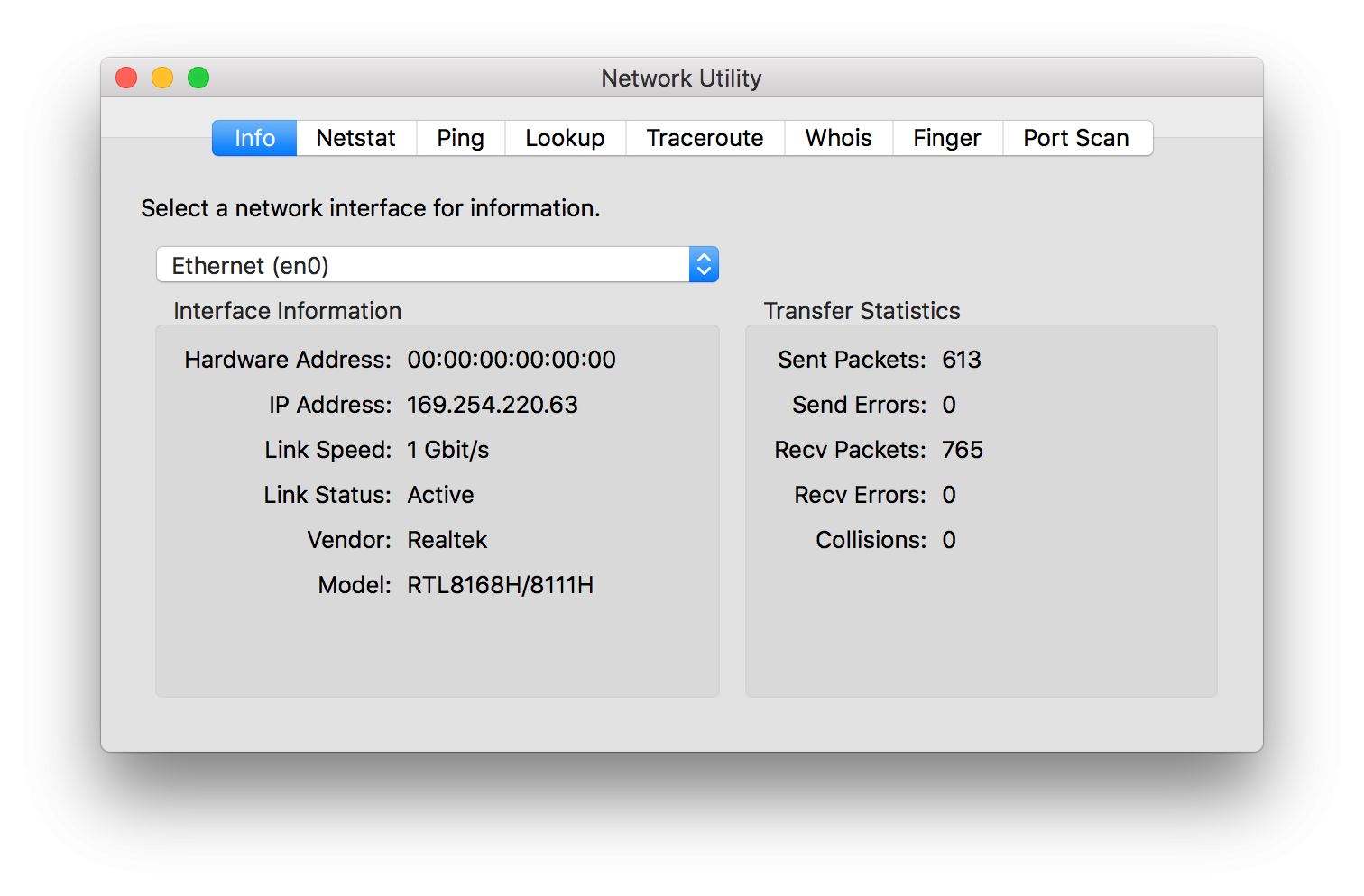

Hello Mieze, is the 8168H supported?
I tried this but the driver somehow doesn't get the Hardware Address, defaulting to 00:00:00:00:00:00.
Thanks
kernel_log.rtf
