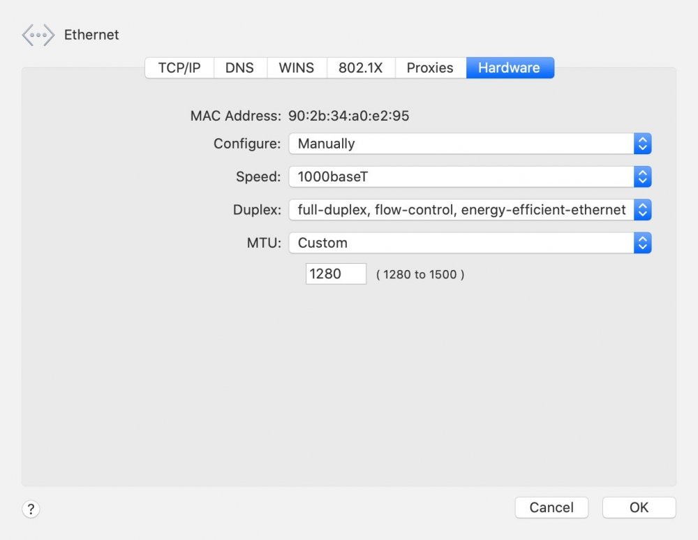

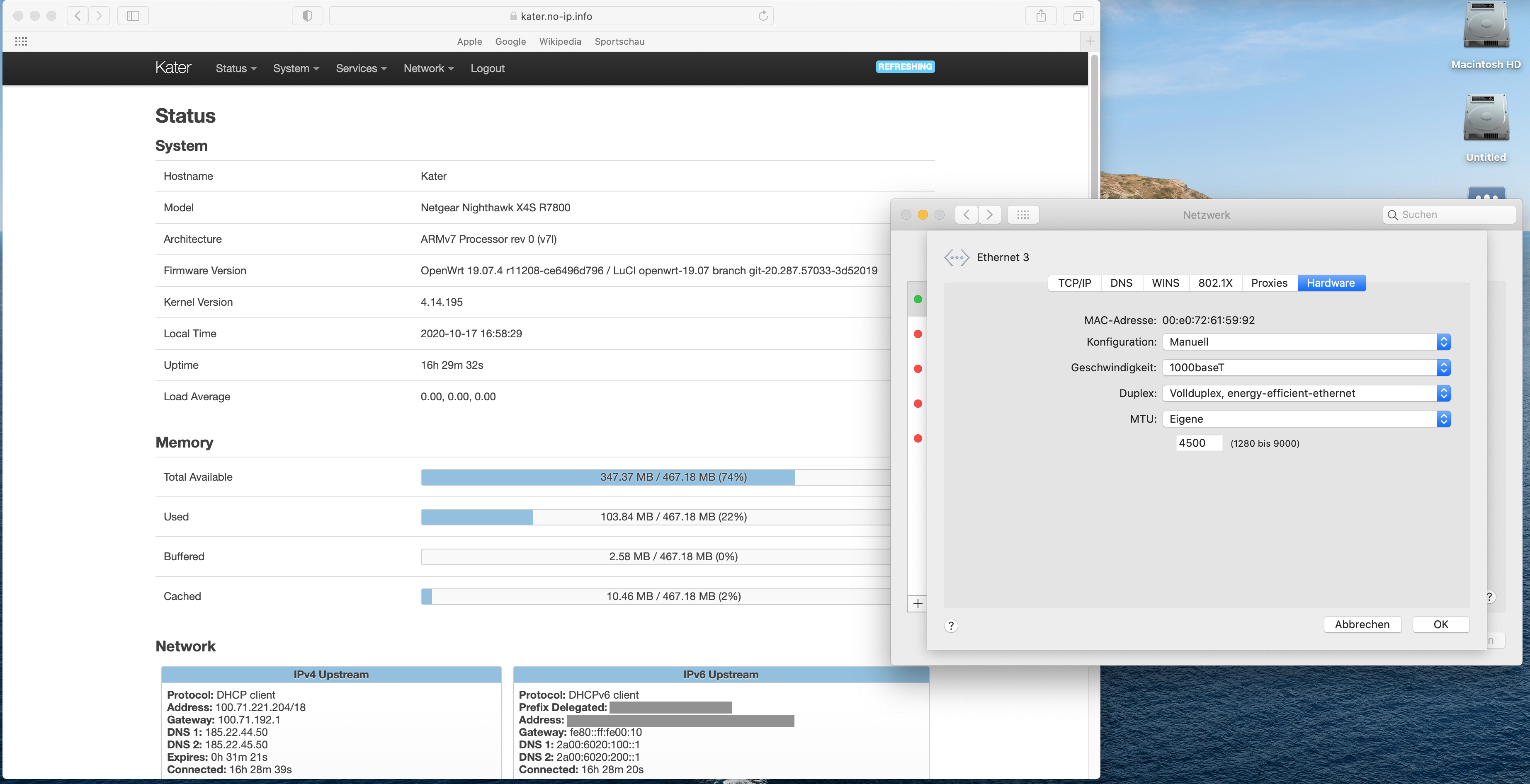

I'm using OpenWRT on my Netgear R7800 router too but I can't confirm the issue. See screenshot below. Keep in mind that in case you are using jumbo frames, all devices involved with communication must support them. It might also be a problem with your router?
Does it work when you disable jumbo frames?

/targets/ramips/mt7620/ here.

No, that doesn't work either. Maybe related to the 100baseTX mode. The router only offers that speed.
Plus, SSH-ing into the router always gets "client_loop: send disconnect: Broken pipe" and breaks up the connection.

Duplex and EEE shouldn't have any effect. Try disabling jumbo frames (MTU 1500) first and see if it works. I case of yes, increase MTU step by step, e.g. 2000, 4500, 9000, and check the result. By the way, which Realtek chipset do you use?

Gigabyte's website says 8111F.
And here only 1280 to 1500 is allowed...
The router only offers 100Mbps.
If possible, you probably need to limit jumbo frames for 1000Mbps only.
Edited by Henry2010

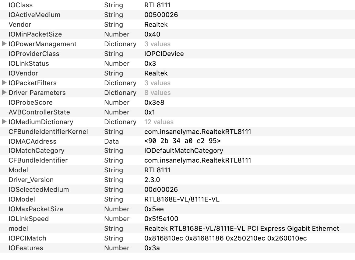

@Henry2010 Please send me you kernel logs, or take a look at the driver's entry in IORegistry in order to identify the exact chipset. Unfortunately it's not possible to limit jumbo frames to gigabit connections because of the way the configuration interface works.
Am I right to assume that everything is working fine with MTU 1500 in your network? Have you tried jumbo frames with a gigabit connection to another device in your network which is known to support jumbo frames?

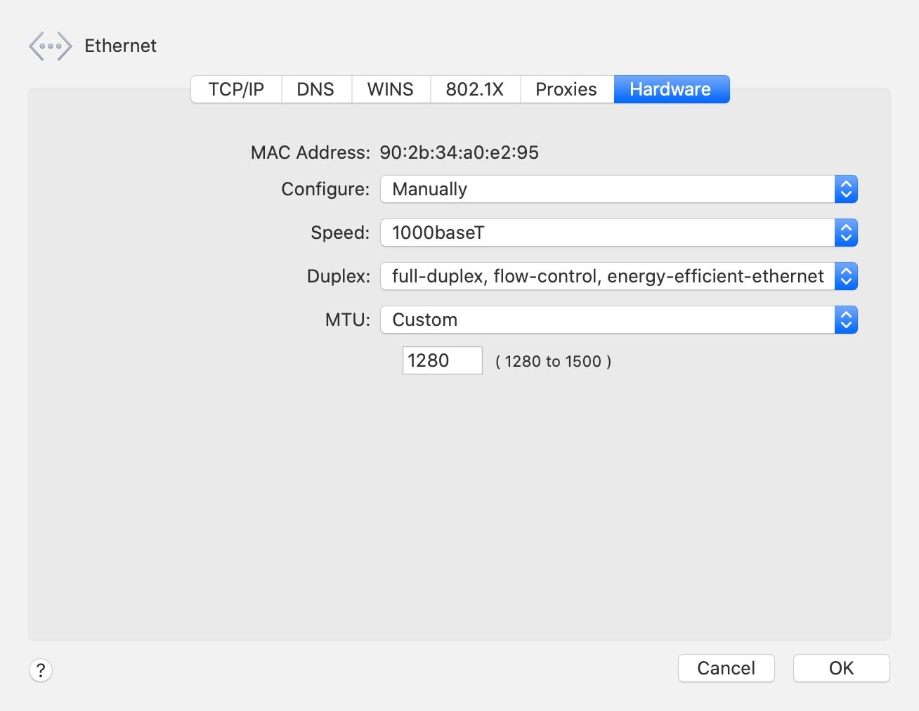

12 hours ago, Mieze said:
@Henry2010 According to your IOReg screenshot you are running version 2.3.0 which doesn't support jumbo frames.
Mieze :cat:
Before I took the pic, I changed it from 2.4.0.d5 back to 2.3.0 in order to fix my router, because when it was 2.4.0.d5, I thought it was broken and flashed 19.07.4 and several snapshots. And as I said, even SSH-ing did not work.
Also, 1000Mbps does NOT work. I set it to show you MTU cannot be more than 1500 here. The router only offers 100Mbps.
Edited by Henry2010

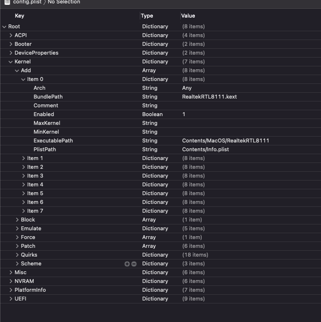

Switched to OpenCore,  install and boot no problem,  LAN driver will not load.
Rollback to 10.15.7 with OpenCore, not loading,  => OpenCore andOr Plist problem.
I do not know what parameters/patches, needed to be added to plist.
But, driver still work, by manually,  install it onto Library Extension.
this tool, make it easy: chris1111
https://github.com/chris1111/Kext-Droplet
Add 1 entry on plist, fixed the Lan Loading thing:
Edited by aww

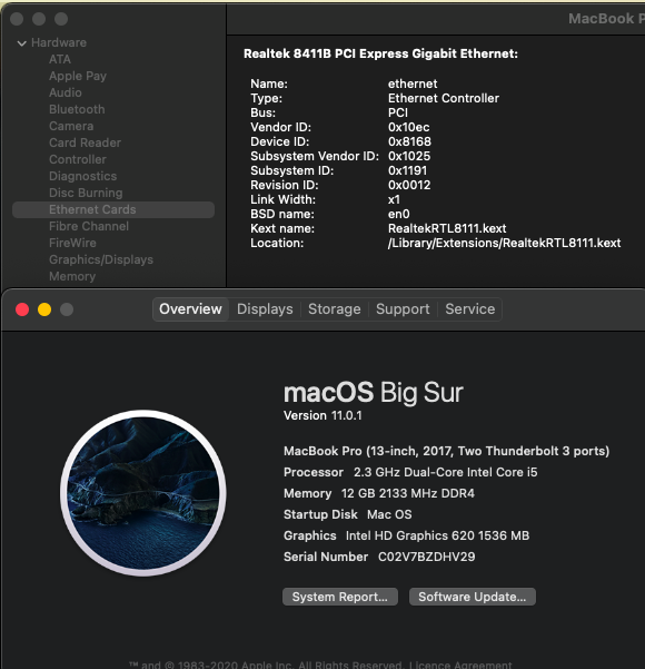

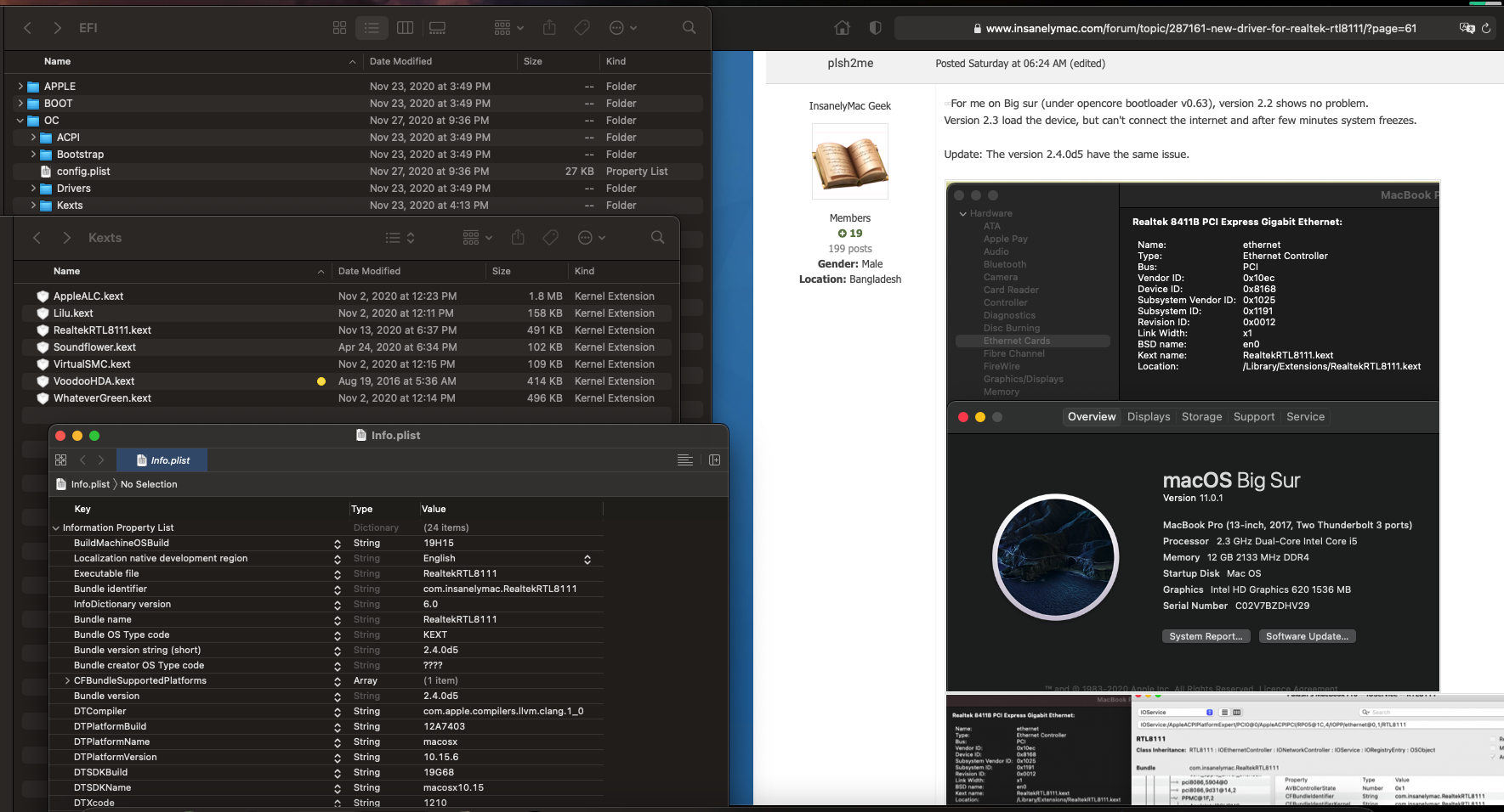

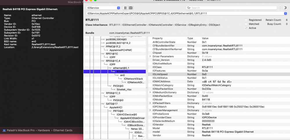

For me on Big sur (under opencore bootloader v0.63), version 2.2 shows no problem.
Version 2.3 load the device, but can't connect the internet and after few minutes system freezes.
Update: The version 2.4.0d5 have the same issue.
Edited by plsh2me
@plsh2me
looking at your uploaded image,  your kext were installed on LE,
OpenCore will not rebuild the kext cache, may need to reinstall it.(the kext)
The installer will rebuild it,
for me, sometime, i have to do it 3 times,
see my other post for install RTL8111.(in OpenCore's Folder)
Edited by aww
