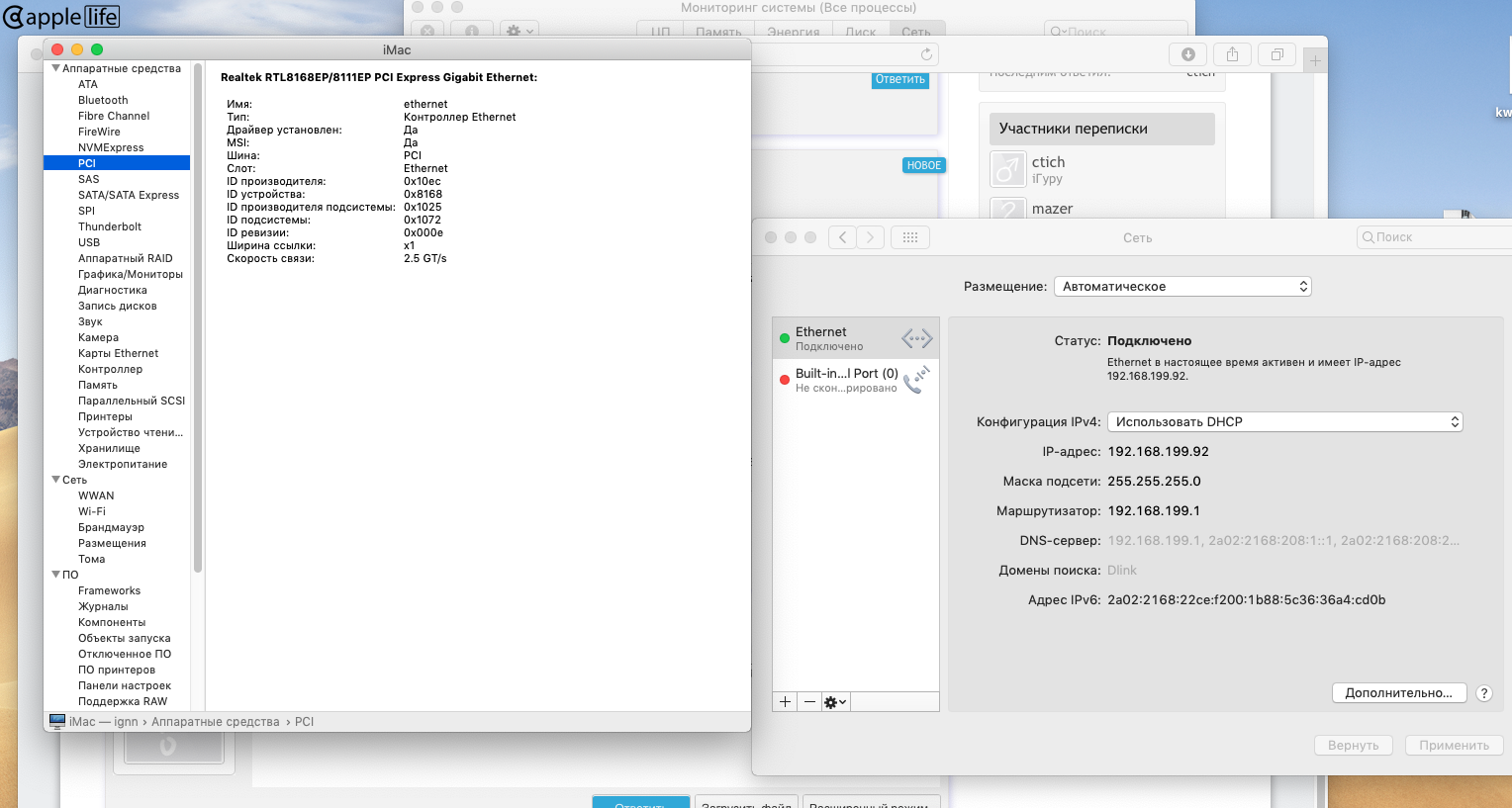

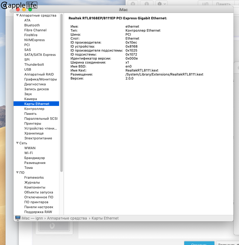

ignn Posted October 30, 2018 Share Posted October 30, 2018 Hello dears! Help with solving the problem please! I have RTL8111. Kext from Rehab leads to panic. Kext from Mieze works, but: After the computer restarts, the adapter disappears from the system, is missing from the system information, and therefore there is no network. That most strange! In Windows he, too, disappear! That is, in fact as if there is no network adapter. But the link indicator is lit)) When i reset Bios to default and setting him again - the adapter appears again. Any ideas friends Thanks in advance! Hardware: ACER Veriton Z4640G: Mac OS X 10.14; Clover; CPU: Intel Core i3-6100; GPU: Intel HD Graphics 530 438831_438765_myhackreg.zip Link to comment https://www.insanelymac.com/forum/topic/287161-new-driver-for-realtek-rtl8111/page/54/#findComment-2643990 Share on other sites More sharing options...
