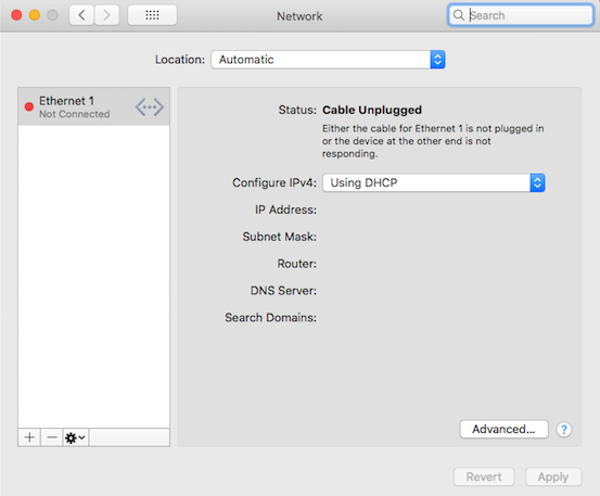

mlodociany Posted February 23, 2020 Share Posted February 23, 2020 OpenCore here, i've tested also beta builds of this kext. I manage to boot into MacOS by creating full system USB installer. However still no ethernet connection with those kexts, MAC address 00:00:00:00.... Link to comment https://www.insanelymac.com/forum/topic/287161-new-driver-for-realtek-rtl8111/page/58/#findComment-2709510 Share on other sites More sharing options...
AnthologyJS Posted March 7, 2020 Share Posted March 7, 2020 On 2/23/2020 at 7:30 AM, mlodociany said: OpenCore here, i've tested also beta builds of this kext. I manage to boot into MacOS by creating full system USB installer. However still no ethernet connection with those kexts, MAC address 00:00:00:00.... same issue on OpenCore for me too. When I plug in ethernet cable, the status lights light up for about 5 seconds and then turn off, and come back a few seconds later. In System Preferences, it fluctuates between saying that there's a cable connected but no DHCP assigned, and disconnected. Probably just going to swap out for an Intel card. Link to comment https://www.insanelymac.com/forum/topic/287161-new-driver-for-realtek-rtl8111/page/58/#findComment-2711570 Share on other sites More sharing options...

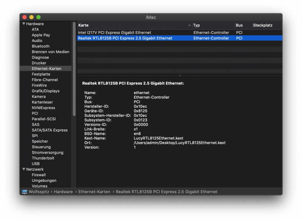

Mieze Posted April 17, 2020 Author Share Posted April 17, 2020 I wanted to share this with you because I just got the first working version of LucyRTL8125Ethernet.kext. See for yourself: Mieze 5 Link to comment https://www.insanelymac.com/forum/topic/287161-new-driver-for-realtek-rtl8111/page/58/#findComment-2717751 Share on other sites More sharing options...
buki Posted April 17, 2020 Share Posted April 17, 2020 @Mieze Very good news, bravo! Link to comment https://www.insanelymac.com/forum/topic/287161-new-driver-for-realtek-rtl8111/page/58/#findComment-2717816 Share on other sites More sharing options...
Iblass11 Posted April 19, 2020 Share Posted April 19, 2020 @Mieze that sounds great! PS: I can support you in testing Link to comment https://www.insanelymac.com/forum/topic/287161-new-driver-for-realtek-rtl8111/page/58/#findComment-2718180 Share on other sites More sharing options...
Mieze Posted April 19, 2020 Author Share Posted April 19, 2020 (edited) I already pushed the source code to GitHub and will open up a new topic here in the LAN & Wireless section of the IM forum soon. Attached to this post you'll also find a prebuilt binary. I haven't got any kernel panics while testing but be prepared to recover your system in case there is a problem. That's the reason why it's best to load a driver manually with "kextload" in Terminal during early stages of development instead of a proper installation in /L/E or injection by Clover. Jumbo frame support is implemented and working but I disabled TSO. Do not expect everything to work perfectly, in particular performance might be lousy in early versions of a network driver. In case you run into a KP, it's best to clean system caches after that as many KPs are caused by linker problems which are quite frequent when you change the code without changing version numbers. Good luck testing! Mieze LucyRTL8125Ethernet-V1.0.0d1.zip Edited April 19, 2020 by Mieze 1 Link to comment https://www.insanelymac.com/forum/topic/287161-new-driver-for-realtek-rtl8111/page/58/#findComment-2718190 Share on other sites More sharing options...

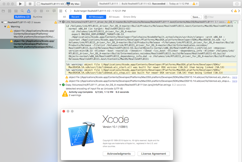

hardcorehenry Posted May 7, 2020 Share Posted May 7, 2020 (edited) 41 minutes ago, Mieze said: Provided you use an appropriate version of Xcode and select the deployment target according to your macOS version, there should be nothing which prevents it from working with High Sierra or even Sierra. Target deployment changed to 10.13(built with such remarks) Target deployment 10.14 no remarks both builds end up like this: Re-plugging doesn't help. 2.3.0d7 built from source with target deployment 10.14 works perfect. Edited May 7, 2020 by hardcorehenry Link to comment https://www.insanelymac.com/forum/topic/287161-new-driver-for-realtek-rtl8111/page/58/#findComment-2721338 Share on other sites More sharing options...
Mieze Posted May 7, 2020 Author Share Posted May 7, 2020 I didn't mention it explicitly but it's been posted in this thread several times before. When you build for an older macOS version, you have to use a version of Xcode which was published for this OS version, select the matching deployment target and the correct SDK, e.g for Mojave Xcode 10, deployment target 10.14, and macOS 10.14 SDK! If you fail to do so, you'll get a link error at runtime and the driver won't load. Mieze 1 Link to comment https://www.insanelymac.com/forum/topic/287161-new-driver-for-realtek-rtl8111/page/58/#findComment-2721397 Share on other sites More sharing options...
Henry2010 Posted May 8, 2020 Share Posted May 8, 2020 18 hours ago, Mieze said: @Henry2010 It also works when injected by Clover, I personally verified this on my test machine, but as I used latest Xcode version to build, the binary only works on Catalina. For Mojave you need to build from source. I will also provide a prebuilt binary for Mojave ASAP. Mieze Thanks. I'll wait for the official release then. Link to comment https://www.insanelymac.com/forum/topic/287161-new-driver-for-realtek-rtl8111/page/58/#findComment-2721442 Share on other sites More sharing options...
