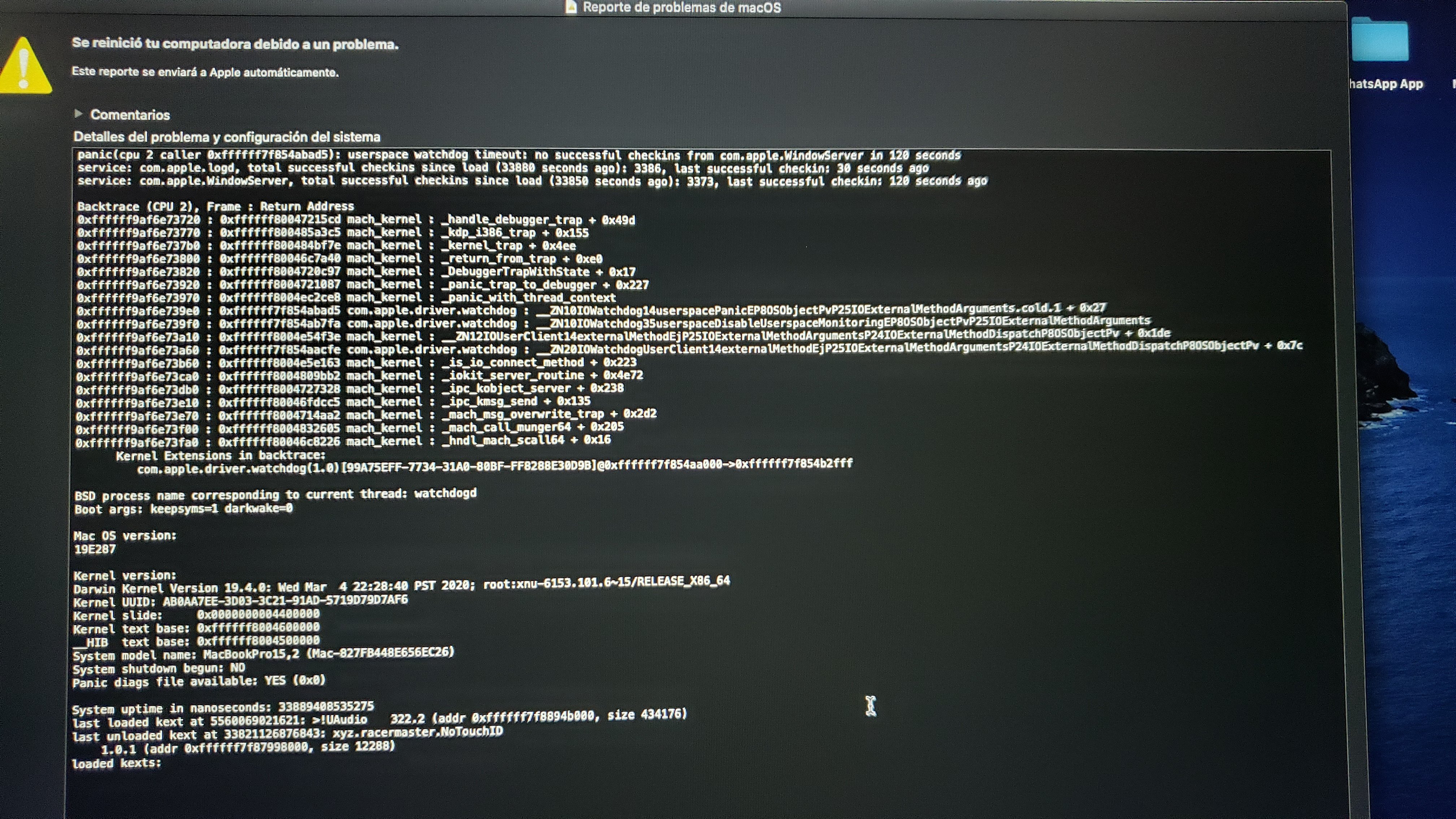

haroldju Posted May 11, 2020 Share Posted May 11, 2020 dear mieze could you provide me with information about this bug that occurs when I have bluetooth headphones connected to music, after a while without touching the equipment it goes into standby mode automatically, then it crashes and restarts. I appreciate your collaboration, thanks! I use an ACER Nitro 5 AN515-52 series model (N17C1) laptop. Link to comment https://www.insanelymac.com/forum/topic/287161-new-driver-for-realtek-rtl8111/page/59/#findComment-2721872 Share on other sites More sharing options...
Mieze Posted May 11, 2020 Author Share Posted May 11, 2020 @haroldju It's off-topic but your KP is most likely the result of a link error. You should clean system caches as described in post#1 of this thread. Go to /System/Library/Caches and delete all the files inside (including those in it's subdirectories) but leave the subdirectories and symbolic links untouched. After that, reboot and recreate the kernel cache. Mieze 1 Link to comment https://www.insanelymac.com/forum/topic/287161-new-driver-for-realtek-rtl8111/page/59/#findComment-2721926 Share on other sites More sharing options...

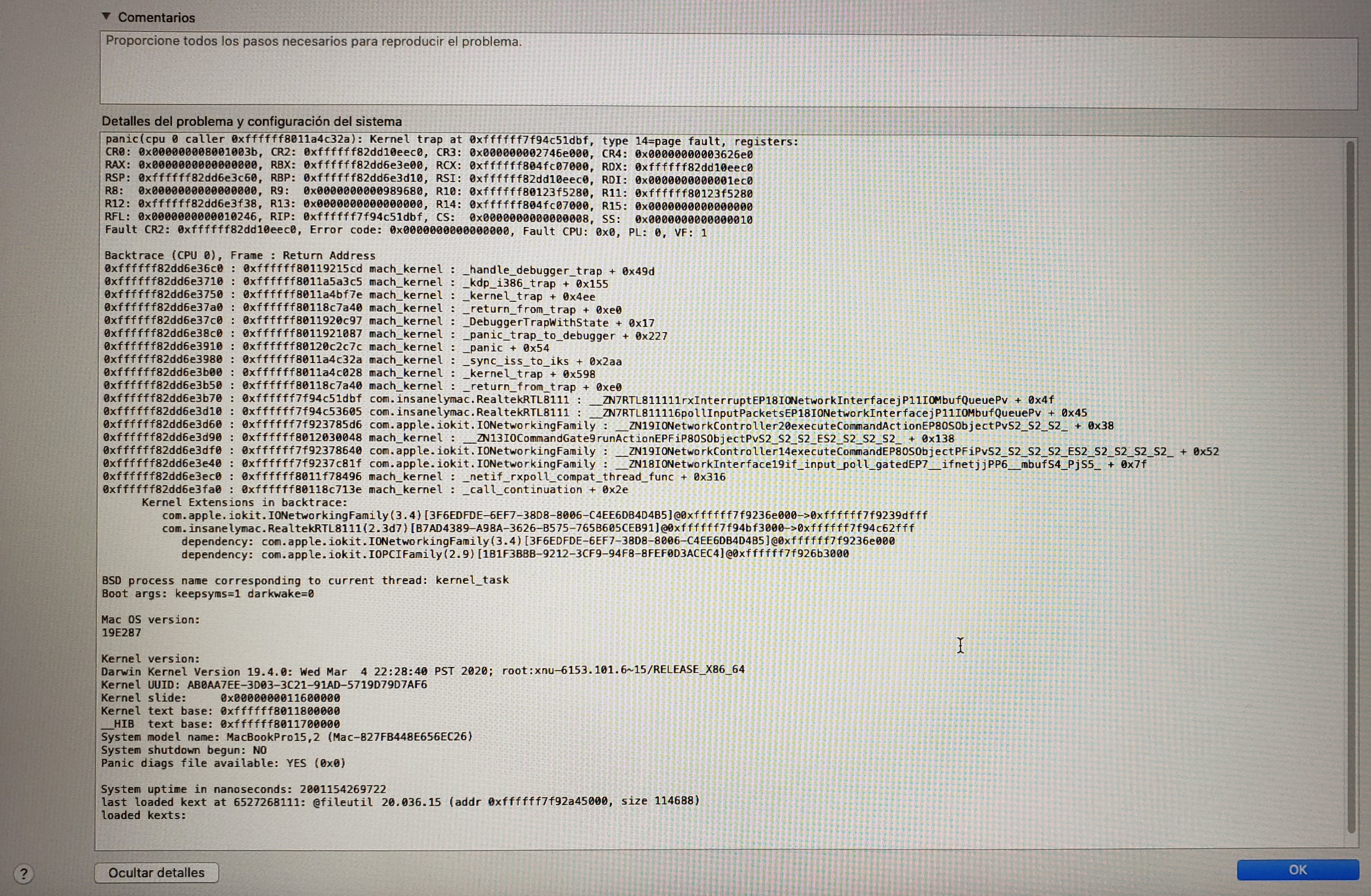

kocoman Posted May 23, 2020 Share Posted May 23, 2020 (edited) My ethernet wil sometimesl say "no route to host", with ping.. but I can fix it with setting the speed from 1000mbps to 100 then to 1000, then it will work again. how to fix? I am on 10.15 rtl8111 complied from github with xcode thanks edit: I am getting this panic, no idea why, any ideas, thanks edit2: added pci-aspm-default 0 in opencore to disable aspm I think worked.., don't know why the Info.plist existing disableaspm true is not working? panic(cpu 2 caller 0xffffff801004c32a): Kernel trap at 0xffffff7f92dd0ded, type 14=page fault, registers: CR0: 0x000000008001003b, CR2: 0xffffff81999e8cf0, CR3: 0x0000000025231000, CR4: 0x00000000003626e0 RAX: 0x0000000000000000, RBX: 0xffffff8db1e63e00, RCX: 0xffffff81999e8cf0, RDX: 0x00000000000001cf RSP: 0xffffff8db1e63c70, RBP: 0xffffff8db1e63d10, RSI: 0x0000000000001cf0, RDI: 0xffffff803a8b5000 R8: 0x0000000000000000, R9: 0x0000000000989680, R10: 0xffffff80109f5900, R11: 0xffffff80109f5280 R12: 0xffffff8db1e63f38, R13: 0x0000000000000000, R14: 0xffffff803a8b5000, R15: 0x0000000000000000 RFL: 0x0000000000010246, RIP: 0xffffff7f92dd0ded, CS: 0x0000000000000008, SS: 0x0000000000000000 Fault CR2: 0xffffff81999e8cf0, Error code: 0x0000000000000000, Fault CPU: 0x2, PL: 0, VF: 1 Backtrace (CPU 2), Frame : Return Address 0xffffff8db1e63590 : 0xffffff800ff215cd mach_kernel : _handle_debugger_trap + 0x49d 0xffffff8db1e635e0 : 0xffffff801005a3c5 mach_kernel : _kdp_i386_trap + 0x155 0xffffff8db1e63620 : 0xffffff801004bf7e mach_kernel : _kernel_trap + 0x4ee 0xffffff8db1e63670 : 0xffffff7f92cbfa8f as.vit9696.VirtualSMC : __ZN18VirtualSMCProvider10kernelTrapI22x86_saved_state_1010_tEEvPT_Pm + 0x44f 0xffffff8db1e63710 : 0xffffff800fec7a40 mach_kernel : _return_from_trap + 0xe0 0xffffff8db1e63730 : 0xffffff800ff20c97 mach_kernel : _DebuggerTrapWithState + 0x17 0xffffff8db1e63830 : 0xffffff800ff21087 mach_kernel : _panic_trap_to_debugger + 0x227 0xffffff8db1e63880 : 0xffffff80106c2c7c mach_kernel : _panic + 0x54 0xffffff8db1e638f0 : 0xffffff801004c32a mach_kernel : _sync_iss_to_iks + 0x2aa 0xffffff8db1e63a70 : 0xffffff801004c028 mach_kernel : _kernel_trap + 0x598 0xffffff8db1e63ac0 : 0xffffff7f92cbfa8f as.vit9696.VirtualSMC : __ZN18VirtualSMCProvider10kernelTrapI22x86_saved_state_1010_tEEvPT_Pm + 0x44f 0xffffff8db1e63b60 : 0xffffff800fec7a40 mach_kernel : _return_from_trap + 0xe0 0xffffff8db1e63b80 : 0xffffff7f92dd0ded com.insanelymac.RealtekRTL8111 : __ZN7RTL811111rxInterruptEP18IONetworkInterfacejP11IOMbufQueuePv + 0x4d 0xffffff8db1e63d10 : 0xffffff7f92dd262a com.insanelymac.RealtekRTL8111 : __ZN7RTL811116pollInputPacketsEP18IONetworkInterfacejP11IOMbufQueuePv + 0x3a 0xffffff8db1e63d60 : 0xffffff7f9086f5d6 com.apple.iokit.IONetworkingFamily : __ZN19IONetworkController20executeCommandActionEP8OSObjectPvS2_S2_S2_ + 0x38 0xffffff8db1e63d90 : 0xffffff8010630048 mach_kernel : __ZN13IOCommandGate9runActionEPFiP8OSObjectPvS2_S2_S2_ES2_S2_S2_S2_ + 0x138 0xffffff8db1e63df0 : 0xffffff7f9086f640 com.apple.iokit.IONetworkingFamily : __ZN19IONetworkController14executeCommandEP8OSObjectPFiPvS2_S2_S2_S2_ES2_S2_S2_S2_S2_ + 0x52 0xffffff8db1e63e40 : 0xffffff7f9087381f com.apple.iokit.IONetworkingFamily : __ZN18IONetworkInterface19if_input_poll_gatedEP7__ifnetjjPP6__mbufS4_PjS5_ + 0x7f 0xffffff8db1e63ec0 : 0xffffff8010578496 mach_kernel : _netif_rxpoll_compat_thread_func + 0x316 0xffffff8db1e63fa0 : 0xffffff800fec713e mach_kernel : _call_continuation + 0x2e Kernel Extensions in backtrace: com.apple.iokit.IONetworkingFamily(3.4)[3F6EDFDE-6EF7-38D8-8006-C4EE6DB4D4B5]@0xffffff7f90865000->0xffffff7f90894fff as.vit9696.VirtualSMC(1.1.1)[2977E4CA-1294-33A0-AF79-85B74CFC89A0]@0xffffff7f92cb0000->0xffffff7f92cd6fff dependency: as.vit9696.Lilu(1.4.2)[FAF6CD32-2270-31AB-A8F0-824543A16A88]@0xffffff7f92c2e000 dependency: com.apple.iokit.IOACPIFamily(1.4)[9D1FF279-C4A2-3344-902F-E0B22B508689]@0xffffff7f910a7000 com.insanelymac.RealtekRTL8111(2.3d10)[5A31221B-80DB-3CD2-BD0A-D20B516D674E]@0xffffff7f92d73000->0xffffff7f92de7fff dependency: com.apple.iokit.IONetworkingFamily(3.4)[3F6EDFDE-6EF7-38D8-8006-C4EE6DB4D4B5]@0xffffff7f90865000 dependency: com.apple.iokit.IOPCIFamily(2.9)[1B1F3BBB-9212-3CF9-94F8-8FEF0D3ACEC4]@0xffffff7f9096a000 BSD process name corresponding to current thread: kernel_task Boot args: -v keepsyms=1 Mac OS version: 19E266 Kernel version: Darwin Kernel Version 19.4.0: Wed Mar 4 22:28:40 PST 2020; root:xnu-6153.101.6~15/RELEASE_X86_64 Kernel UUID: AB0AA7EE-3D03-3C21-91AD-5719D79D7AF6 Kernel slide: 0x000000000fc00000 Kernel text base: 0xffffff800fe00000 __HIB text base: 0xffffff800fd00000 System model name: iMac18,1 (Mac-4B682C642B45593E) System shutdown begun: NO Panic diags file available: YES (0x0) System uptime in nanoseconds: 49240220576276 last loaded kext at 1771338334180: >!UAudio 322.2 (addr 0xffffff7f92f6f000, size 434176) loaded kexts: org.virtualbox.kext.VBoxNetAdp 6.1.6 org.virtualbox.kext.VBoxNetFlt 6.1.6 org.virtualbox.kext.VBoxUSB 6.1.6 org.virtualbox.kext.VBoxDrv 6.1.6 com.paragon-software.filesystems.extfs 30.3.11 com.paragon-software.lvm-for-mac 1 com.insanelymac.RealtekRTL8111 2.3.0d10 as.vit9696.VirtualSMC 1.1.1 com.rehabman.driver.USBInjectAll 0.6.2 as.vit9696.WhateverGreen 1.3.7 as.vit9696.Lilu 1.4.2 @filesystems.smbfs 3.4.2 >!AUpstreamUserClient 3.6.8 >!AMCCSControl 1.11 @fileutil 20.036.15 @filesystems.autofs 3.0 >!AGraphicsDevicePolicy 5.1.16 @AGDCPluginDisplayMetrics 5.1.16 >!AHV 1 |IOUserEthernet 1.0.1 |IO!BSerialManager 7.0.4f6 >!A!ISKLGraphics 14.0.5 >!A!IPCHPMC 2.0.1 >pmtelemetry 1 @Dont_Steal_Mac_OS_X 7.0.0 >!AFIVRDriver 4.1.0 >!A!ISlowAdaptiveClocking 4.0.0 >!A!ISKLGraphicsFramebuffer 14.0.5 >ACPI_SMC_PlatformPlugin 1.0.0 |SCSITaskUserClient 422.101.1 @private.KextAudit 1.0 @filesystems.apfs 1412.101.1 >!AFileSystemDriver 3.0.1 >!AVirtIO 1.0 @filesystems.hfs.kext 522.100.5 @!AFSCompression.!AFSCompressionTypeDataless 1.0.0d1 @BootCache 40 @!AFSCompression.!AFSCompressionTypeZlib 1.0.0 >!AAHCIPort 341.0.2 >!ARTC 2.0 >!AACPIButtons 6.1 >!AHPET 1.8 >!ASMBIOS 2.1 >!AAPIC 1.7 $!AImage4 1 @nke.applicationfirewall 303 $TMSafetyNet 8 @!ASystemPolicy 2.0.0 |EndpointSecurity 1 >!UAudio 322.2 >usb.!UHub 1.2 >usb.cdc.acm 5.0.0 >usb.serial 6.0.0 >usb.cdc.ecm 5.0.0 >usb.cdc.ncm 5.0.0 >!UMergeNub 900.4.2 >!ASMBus!C 1.0.18d1 |IOSMBus!F 1.1 |IOUSBUserClient 900.4.2 @kext.triggers 1.0 >!AGraphicsControl 5.1.16 |IOAVB!F 840.3 >!ASSE 1.0 |IO!B!F 7.0.4f6 |IO!BPacketLogger 7.0.4f6 |IONDRVSupport 575.1 @!AGPUWrangler 5.1.16 >!ASMBusPCI 1.0.14d1 >!AHDA!C 283.15 |IOHDA!F 283.15 |IOSlowAdaptiveClocking!F 1.0.0 @!AGraphicsDeviceControl 5.1.16 |IOAccelerator!F2 438.4.5 |IOGraphics!F 575.1 >IOPlatformPluginLegacy 1.0.0 >IOPlatformPlugin!F 6.0.0d8 @plugin.IOgPTPPlugin 840.3 |IOEthernetAVB!C 1.1.0 |IOSkywalk!F 1 |IOAHCISerialATAPI 268 >!AXsanScheme 3 |IOAHCIBlock!S 316.100.5 >usb.IOUSBHostHIDDevice 1.2 >usb.cdc 5.0.0 >usb.networking 5.0.0 >usb.!UHostCompositeDevice 1.2 |IOAudio!F 300.2 @vecLib.kext 1.2.0 |IOSerial!F 11 |IOSurface 269.11 @filesystems.hfs.encodings.kext 1 |IOAHCI!F 290.0.1 >!A!ILpssGspi 3.0.60 >usb.!UXHCIPCI 1.2 >usb.!UXHCI 1.2 >usb.!UHostPacketFilter 1.0 >!AEFINVRAM 2.1 |IOUSB!F 900.4.2 >!AEFIRuntime 2.1 |IOHID!F 2.0.0 $quarantine 4 $sandbox 300.0 @kext.!AMatch 1.0.0d1 >DiskImages 493.0.0 >!AFDEKeyStore 28.30 >!AEffaceable!S 1.0 >!AKeyStore 2 >!UTDM 489.101.1 |IOSCSIBlockCommandsDevice 422.101.1 >!ACredentialManager 1.0 >KernelRelayHost 1 >!ASEPManager 1.0.1 >IOSlaveProcessor 1 |IOUSBMass!SDriver 157.101.3 |IOSCSIArchitectureModel!F 422.101.1 |IO!S!F 2.1 |IOUSBHost!F 1.2 >!UHostMergeProperties 1.2 >usb.!UCommon 1.0 >!ABusPower!C 1.0 |CoreAnalytics!F 1 >!AMobileFileIntegrity 1.0.5 @kext.CoreTrust 1 |IOTimeSync!F 840.3 |IONetworking!F 3.4 |IOReport!F 47 >!AACPIPlatform 6.1 >!ASMC 3.1.9 >watchdog 1 |IOPCI!F 2.9 |IOACPI!F 1.4 @kec.pthread 1 @kec.corecrypto 1.0 @kec.Libm 1 Edited May 24, 2020 by kocoman Link to comment https://www.insanelymac.com/forum/topic/287161-new-driver-for-realtek-rtl8111/page/59/#findComment-2723491 Share on other sites More sharing options...

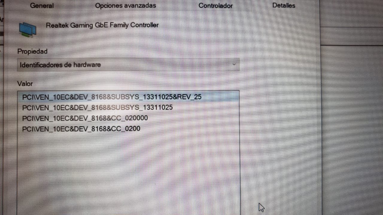

haroldju Posted June 12, 2020 Share Posted June 12, 2020 @Mieze hello dear Mieze, you have worked with this model of network card (Realtek Gaming GbE Family Controller) I have this device in my new laptop, but your RTL8111 controller version d10 does not recognize it in macos. Thank you very much beforehand for your help ! Annex photo with id. device hardware. Link to comment https://www.insanelymac.com/forum/topic/287161-new-driver-for-realtek-rtl8111/page/59/#findComment-2725581 Share on other sites More sharing options...
