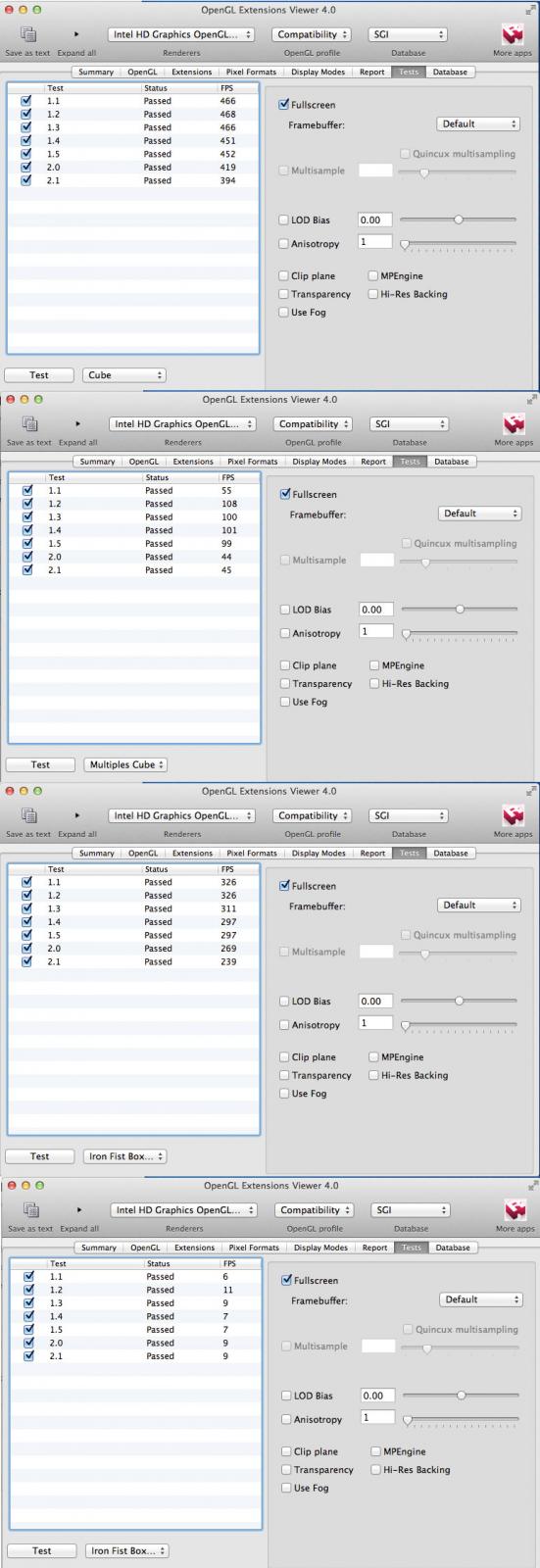

Chaitanya_cr8 Posted July 6, 2013 Share Posted July 6, 2013 Whenever I run OpenGL Extension Viewer, it crashes. Overall graphics performance is nice but I cant play chess i.e. OpenGL FPS must be in the 5-10 FPS range. Can this occur because I am using 3GB RAM? Link to comment https://www.insanelymac.com/forum/topic/286092-guide-1st-generation-intel-hd-graphics-qeci/page/15/#findComment-1930519 Share on other sites More sharing options...

ABuseTHeMAc Posted July 7, 2013 Share Posted July 7, 2013 Whenever I run OpenGL Extension Viewer, it crashes. Overall graphics performance is nice but I cant play chess i.e. OpenGL FPS must be in the 5-10 FPS range. Can this occur because I am using 3GB RAM? Hey what version see the comment under yours for help. I can say from experience your not going to go anywhere above the 15fps range with intel hd graphics. Just not possible. Even i tried running games like wizard101 for my son and i got overheat. I can only run in 15fps with a fan. Though this is true i dont really see a big difference on windows and mac. I am actually getting a better graphics preformance on mac than on windows. So its not a mac issue more of a overall cpu and graphics Link to comment https://www.insanelymac.com/forum/topic/286092-guide-1st-generation-intel-hd-graphics-qeci/page/15/#findComment-1930635 Share on other sites More sharing options...
andrio.b Posted July 8, 2013 Share Posted July 8, 2013 Whenever I run OpenGL Extension Viewer, it crashes. Overall graphics performance is nice but I cant play chess i.e. OpenGL FPS must be in the 5-10 FPS range. Can this occur because I am using 3GB RAM? RAM does no matter. I have 3Gb RAM, too. Link to comment https://www.insanelymac.com/forum/topic/286092-guide-1st-generation-intel-hd-graphics-qeci/page/15/#findComment-1930888 Share on other sites More sharing options...
GhostRaider Posted July 8, 2013 Author Share Posted July 8, 2013 There are people here that have OpenGL issues here, but for some reason most issues are being reported by users with an Intel Core i3. I'm not sure what is causing the problem. For example, it is odd that the Iron Fist Boxer Head has a constant 6 FPS for all test. Maybe there is some sort of sync issue that is throttling the performance? I'm one of the few people who don't have any issues with OpenGL or is it because I have a Core i5?. Anybody found the hex values that enable VGA out or HDMI? Anybody experimented with that? Link to comment https://www.insanelymac.com/forum/topic/286092-guide-1st-generation-intel-hd-graphics-qeci/page/15/#findComment-1931009 Share on other sites More sharing options...
andrio.b Posted July 9, 2013 Share Posted July 9, 2013 There are people here that have OpenGL issues here, but for some reason most issues are being reported by users with an Intel Core i3. I'm not sure what is causing the problem. For example, it is odd that the Iron Fist Boxer Head has a constant 6 FPS for all test. Maybe there is some sort of sync issue that is throttling the performance? I'm one of the few people who don't have any issues with OpenGL or is it because I have a Core i5?. Anybody found the hex values that enable VGA out or HDMI? Anybody experimented with that? It does not depend on processor type/name. Recently, I've installed ML on Acer with core i3 370m (2.4GHz) as same as mine one! However, Acer has no issues, mine notebook has. SO it does NOT matter what processor. Acer has 0046 8086 rev. 18 dev id. Mine is rev. 02. Is there anybody with intel HD graphics dev id 8086 0046 rev.02 ??? if you have performance issue, what's you Rev? Link to comment https://www.insanelymac.com/forum/topic/286092-guide-1st-generation-intel-hd-graphics-qeci/page/15/#findComment-1931153 Share on other sites More sharing options...
warraisraw Posted July 9, 2013 Share Posted July 9, 2013 It does not depend on processor type/name. Recently, I've installed ML on Acer with core i3 370m (2.4GHz) as same as mine one! However, Acer has no issues, mine notebook has. SO it does NOT matter what processor. Acer has 0046 8086 rev. 18 dev id. Mine is rev. 02. Is there anybody with intel HD graphics dev id 8086 0046 rev.02 ??? if you have performance issue, what's you Rev? Hello, Yes, I think the problem is rev version, is the "detail" that make the difference. My rev version is 02 and my performance is low compared another rev in the same Intel HD Graphics. Core i3 370m Intel HD Graphics (0046) Regards. Link to comment https://www.insanelymac.com/forum/topic/286092-guide-1st-generation-intel-hd-graphics-qeci/page/15/#findComment-1931218 Share on other sites More sharing options...
andrio.b Posted July 10, 2013 Share Posted July 10, 2013 Hello, Yes, I think the problem is rev version, is the "detail" that make the difference. My rev version is 02 and my performance is low compared another rev in the same Intel HD Graphics. Core i3 370m Intel HD Graphics (0046) Regards. Thanks, warraisraw, we've finally found out the reason (I hope). Can you please provide your lspci -xxx for comparing with my values... I'll try to get these values from my friend's Acer that having no issues at all to look through the difference. I'll upload all materials in this topic asap for further testing and developing this problem... Any help appreciated. Thank you. Link to comment https://www.insanelymac.com/forum/topic/286092-guide-1st-generation-intel-hd-graphics-qeci/page/15/#findComment-1931321 Share on other sites More sharing options...

juanerson Posted July 10, 2013 Share Posted July 10, 2013 Hardware Rev 02 here. Just in case, I tried patching "revision-id" (12 or 18) from the DSDT, and didn't help. Link to comment https://www.insanelymac.com/forum/topic/286092-guide-1st-generation-intel-hd-graphics-qeci/page/15/#findComment-1931425 Share on other sites More sharing options...

warraisraw Posted July 10, 2013 Share Posted July 10, 2013 Thanks, warraisraw, we've finally found out the reason (I hope). Can you please provide your lspci -xxx for comparing with my values... I'll try to get these values from my friend's Acer that having no issues at all to look through the difference. I'll upload all materials in this topic asap for further testing and developing this problem... Any help appreciated. Thank you. Hi, Here is my lspci [Packard Bell EasyNote TK85] Regards. lspci_tk85.txt Link to comment https://www.insanelymac.com/forum/topic/286092-guide-1st-generation-intel-hd-graphics-qeci/page/15/#findComment-1931476 Share on other sites More sharing options...

Hyper_Thread Posted July 11, 2013 Share Posted July 11, 2013 It does not depend on processor type/name. Recently, I've installed ML on Acer with core i3 370m (2.4GHz) as same as mine one! However, Acer has no issues, mine notebook has. SO it does NOT matter what processor. Acer has 0046 8086 rev. 18 dev id. Mine is rev. 02. Is there anybody with intel HD graphics dev id 8086 0046 rev.02 ??? if you have performance issue, what's you Rev? I confirm, mine is rev.02 too Link to comment https://www.insanelymac.com/forum/topic/286092-guide-1st-generation-intel-hd-graphics-qeci/page/15/#findComment-1931575 Share on other sites More sharing options...
