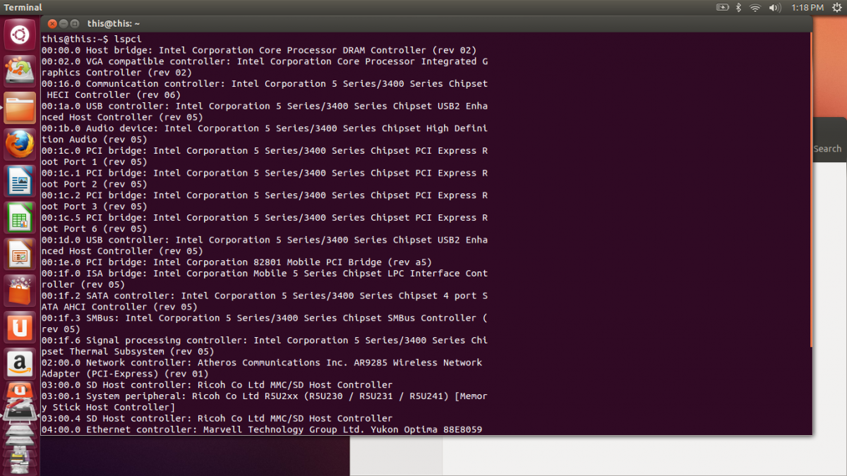

Hello Guys! I have a Sony Vaio VPCEA43EG with core i3 380m. i just want to ask if there is a way to know if my internal monitor is connected via eDP or lvds using Mac OSX.

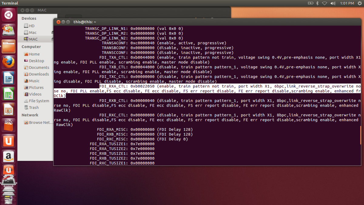

This laptop might be using the LVDS connection according to one of the Sony documentations for this series. I guess if you want to be sure, install any Linux distro (Ubuntu or something) on a USB, boot it up, open terminal and type "sudo intel_reg_dumper". It may ask you to install something in order for the command to work so do it if it says that. Then once the command works, you will get a whole lot of information. You must look for this line:
PCH_LVDS: 0x80308302 (enabled, pipe A, 18 bit, 1 channel)
The most important thing is to have this line say "Enabled". If it says that, then your LCD is using the LVDS connection and supports QE/CI. If it says "Disabled", its using eDP.

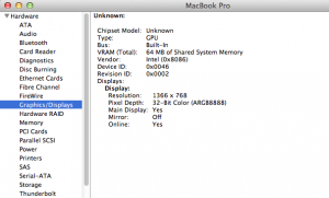

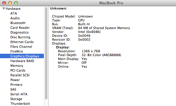

Pic below
The 10.9 framebuffer has some resemblance to the 10.8 framebuffer however with some differences in codes. These values must be patched manually for now. Currently I'm not using Mavericks until final release since there are still bugs so anything can happen.
Confirmed! i have a PCH_LVDS: 0x80308302 (enabled, pipe A, 18 bit, 1 channel) line in the ubuntu terminal when i type sudo intel_reg_dumper.
