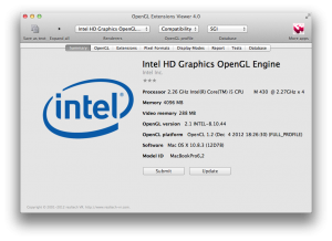

Hi, anyone has solved the performance of graphic card (0046:8086)?
In games and some applications the performance is poor in my laptop (very laggy).
Note: I'm using Natit to inject my graphic card.
Regards.

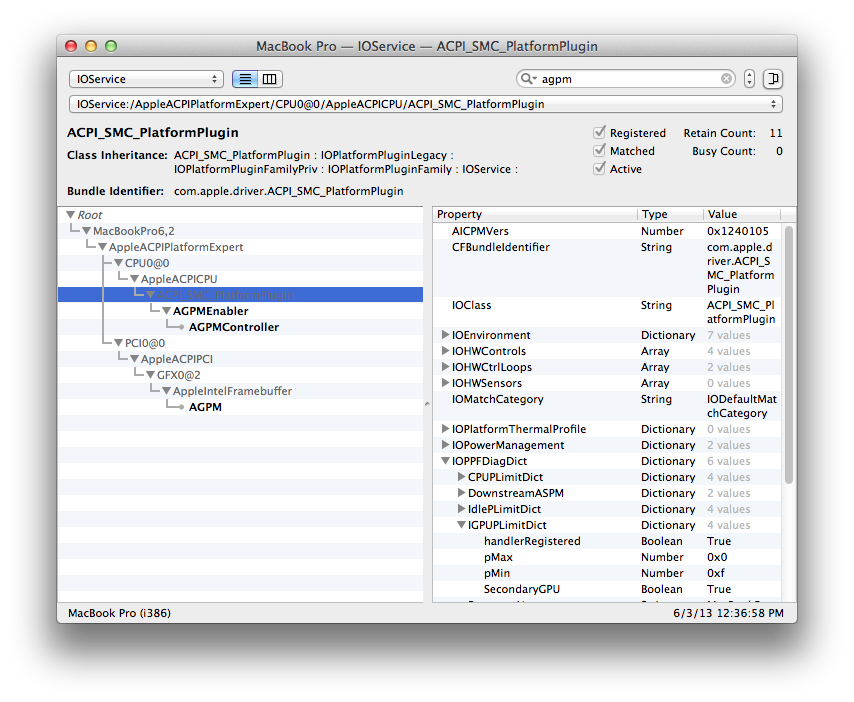

Could you give me your device-id from the Intel HD with System Info.
Maybe setting AGPM.kext will solve the problem.
Editing the AGPM plist might solve the performance issues for Intel HD Graphics IGPU. However I'm not sure if you can get a kernel panic from editing it. I'm also not sure if OS X can boot without it either unless someone can confirm you can boot OS X without AGPM kext.
You don't have to add vendor or device id. It's already there:

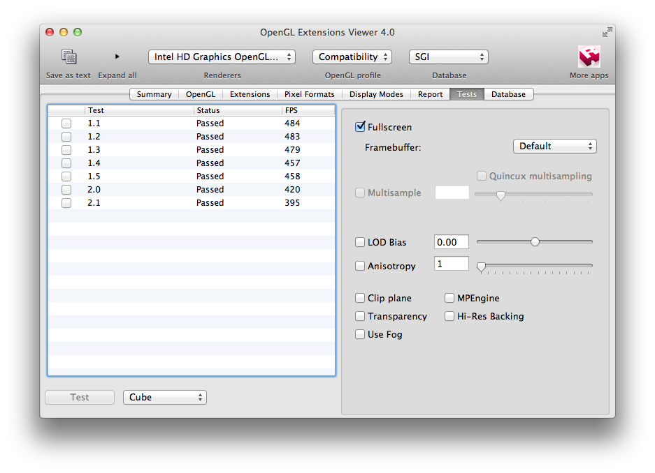

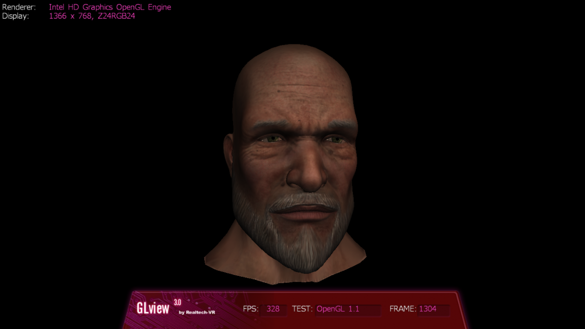

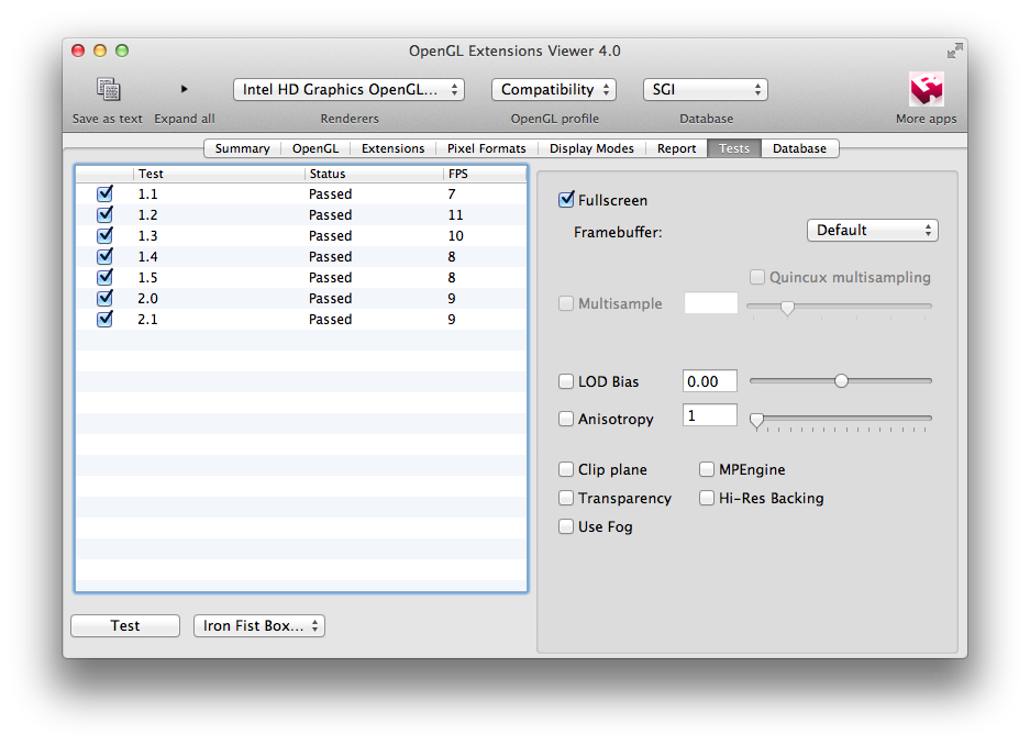

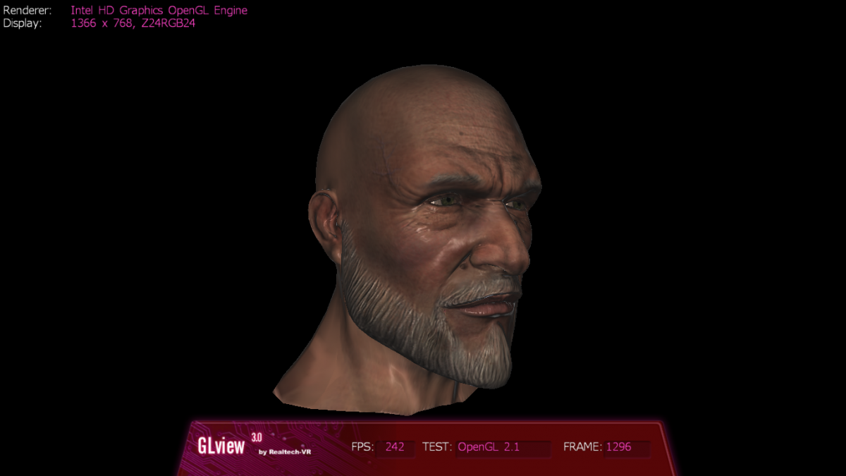

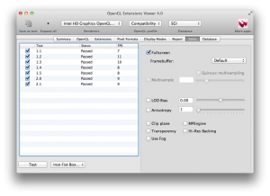

I also did some tests with OpenGL Extensions Viewer and these are my results. Tried with Battery and AC connected. This was a native test, no edits in AGPM kext. Tests were run at full screen (1366x768).
Cube (Battery):
Cube (AC):
MultCube (Battery):
MultCube (AC):
Iron Fist Head (Battery):
Mult Iron Fist Head (AC):
From the results, the Multiple Iron Fist Head killed the Intel HD Graphics. I mean it is an integrated graphics chip so performance will never be good as dedicated graphics cards. There was not much difference whether running in Battery or connected though AC. Also, keep in mind that OS X uses OpenGL in games, not DirectX. Again performances vary.

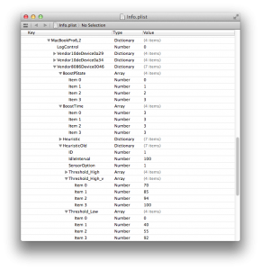

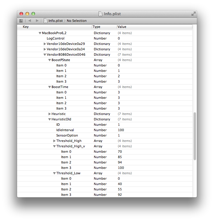

Okay I started investigating the AppleGraphicsPowerManagement.kext (AGPM 10.8.3) and the ordering of the power states don't make sense.
Inside the AGPM plist, there are these values for MacBook Pro (6,2). Well I chose 6,2 because that is the SMBIOS i'm using. MacBook Pro (6,1) also has the same values.
   <key>Vendor8086Device0046</key>

This is the important part we are interested in:
   <key>Threshold_High</key>
   <array>
    <integer>50</integer>
    <integer>75</integer>
    <integer>96</integer>
    <integer>100</integer>
   </array>
   <key>Threshold_High_v</key>
   <array>
    <integer>70</integer>
    <integer>85</integer>
    <integer>94</integer>
   </array>
   <key>Threshold_Low</key>
   <array>
    <integer>0</integer>
    <integer>40</integer>
    <integer>55</integer>
    <integer>92</integer>
   </array>
   <key>Threshold_Low_v</key>
   <array>
    <integer>60</integer>
   </array>
Let me explain. We have 4 power states for the Intel HD Graphics IGPU 0, 1, 2 , 3.
0 = Max Performance
1 = Medium Performance
2 = Low Performance
3 = Max Power Savings
Threshold Low and Threshold High are in idle percentages. The higher the idle percentage, the less performance. The lower the idle percentage, the higher the performance. Maybe this will make sense or not:
Threshold Low Threshold High
0 0% 50%
1 40% 75%
2 55% 96%
3 92% 100%
For example, if the Intel HD Graphics has its idle percentage within 0%-50%, Max performance will be activated. But the percentages overlap, and I find that rather odd. Other InsanelyMac users who have dedicated graphics cards configure their AGPM so that percentages do not overlap. Here is the problem.
If the Intel HD Graphics is 40%-75% idle, then Medium Performance is activated. However Max performance is from 0%-50%. They overlap. Maybe this is why there are performance issues?
Then from 55%-96% idle, low performance is activated and from 92%-100% Max power savings is activated. Again they both overlap.
However I don't know what Threshold_v Low and Threshold_v High are. Not sure what the "v" stands for.
Threshold Low_v Threshold High_v
0 0% 70%
1 50% 85%
2 60% 94%
3 92% 100%
All the information is here to edit the idle values. In theory, if we set level 3 to Threshold Low 99% - Threshold High 100%, then whenever the IGPU is idle at that percentage, max power savings is used. If we set level 2 Threshold Low 97% - Theshold High 98%, then low performance is used. Then if we set level 1 to Threshold Low 70% - Threshold High 96%, medium performance is used. Finally if we set level 0 to Threshold Low 0% - Threshold High 69%, max performance is used.
I'm not sure about Threshold Low_v or Threshold High_v. Anybody willing to try it out?
But here i have poor performance even at single Iron Fist Head test (laptop connected though AC & untouched AGPM kext) !!
This does not make sens ! i'll try to mod some values in AGPM's plist & feedback
Same results for me in this test.... is possible that the GPU didn't goes to full power when render this test.
@Hyper_Thread and tivimac
What does OpenGL Extensions viewer say? Show me a screenshot. This is how mine looks like:
As for the Fist Boxer Head, this is what you should be seeing. From what I remember, I never did anything special that would accelerate the performance of the Intel HD Graphics:
I understand if there is some lag here and there, the X3100 had the same problem but your situation is new. You guys have Quartz Extreme running?

But according to your screenshot, i notice that my OpenGL version is 2.1 APPLE-8.0.61
I don't know if this is updated by 10.8.3 or i'm missing some thing ?!!

You still use 10.8.2? I highly recommend you update to 10.8.3 as I found that there is better performance here. Everyone else that is on 10.8.2 still should upgrade. I mean you should have no problem at all in upgrading. Just remember to delete the Intel HD Graphics kexts before rebooting. Again back up any other modified kext that you use except for the Intel HD Graphics kexts. Those must be deleted.

After playing with AGPM's stings in info.plist, i've been able to gain 50fps in tests.
The best results was given by the following edit :
<key>MacBookPro6,2</key>
<dict>
<key>LogControl</key>
<integer>1</integer>
<dict>
<key>BoostPState</key>
<array>
<integer>2</integer>
<integer>3</integer>
</array>
<key>BoostTime</key>
<array>
</array>
<key>Heuristic</key>
<dict>
<key>ID</key>
<key>IdleInterval</key>
<integer>200</integer>
<key>SensorOption</key>
<array>
</array>
<array>
<integer>80</integer>
</array>
<array>
</array>
<array>
</array>
</dict>
<key>control-id</key>
<integer>16</integer>
<key>max-power-state</key>
<integer>15</integer>
<key>min-power-state</key>
As you can notice, i removed the two other devises & replaced Heuristic keys with HeuristicOld ones (ID changed also to 0)
But as many tests as I do, I do not think that this problem is only caused by AGPM, look at this :
I don't see anything suspicious about that. Looks the same for me too.
I want you to do a little experiment and tell me the result. Go to System>Library>Extensions. Find "Apple Graphics Control" kext and make a backup of it in case something goes wrong. Right click and select "Show Package Contents", then Contents>PlugIns and delete "AppleMuxControl" kext. Then repair kext permissions and cache and reboot.
got same issue as Hyper_Thread.
