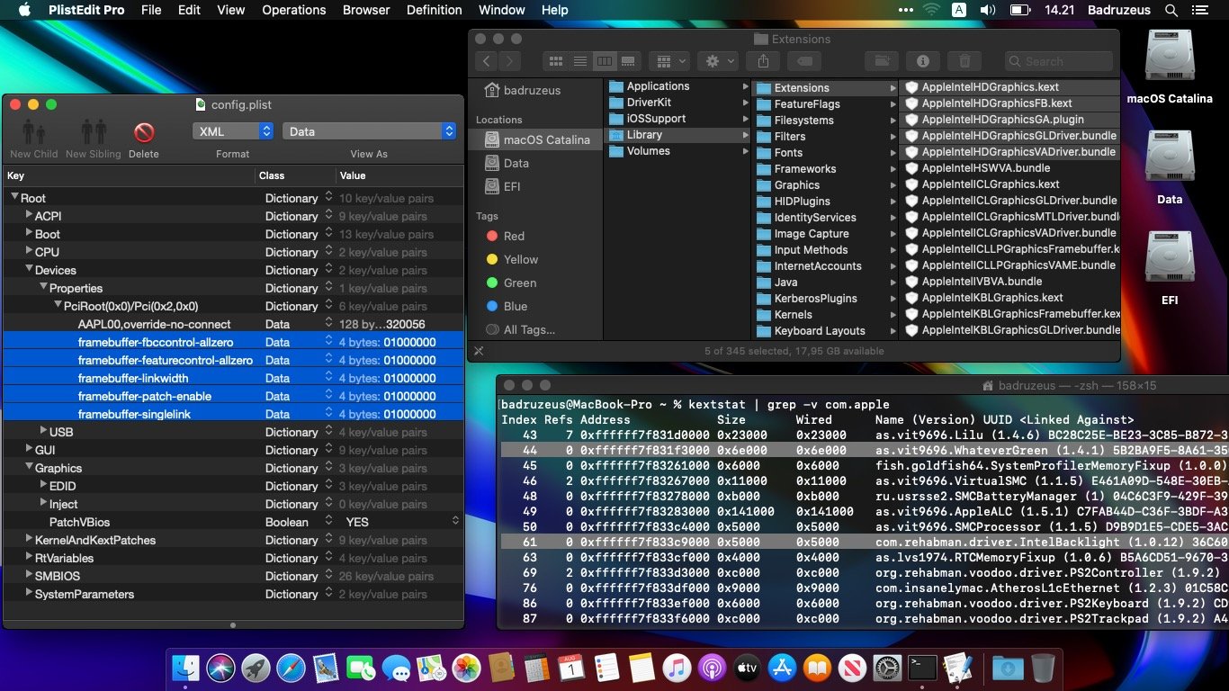

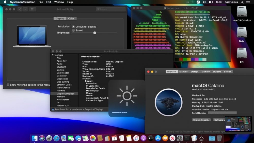

Rikchell Posted November 13, 2020 Share Posted November 13, 2020 On 8/1/2020 at 6:35 AM, Badruzeus said: Good Old Day! Just installed latest macOS Catalina 10.15.6 on Toshiba Satellite L640 with Intel HD 1st Gen (Arrandale): 1. Using dosdude's Catalina Patcher app for creating Bootable USB Installer plus Post Install (rolling back deprecated Graphics kexts, OpenGL frameworks, Platform patch, etc) for unsupported mach << needs 2 x USB Boots for OS Install and then Post-Install 2. config.plist - Devices - FakeID - IntelGfx=0x12345678 for Pre-Install 3. To achieve QE/CI or Graphics Acceleration with WEG (+Lilu) installed, add Properties for Graphics on config.plist - Devices (plz refer to the manual, or see my screenshot & sample below. Thanks to GoldFish64). Remove IntelGfx FakeID on this case 4. For Native (ACPI) Brightness to works, patched DSDT is needed following old mnorthern's guide. Take a look attached DSDT below. For reference, find: LEVL, os-info, LGD018B, PNLF, _WAK. Also, replace DisplayServices.framework from 10.12.4 located on /System/Library/PrivateFrameworks/ and add Rehabman's IntelBacklight.kext v1.0.12 (attached) to \EFI\CLOVER\kexts\Other. On my case, Display Brightness Slider is working (or Fn + Keys if remapped already) with no longer need BergDesign incompat 32-bit app. If you have better idea, then let me know. #SomeHINTS: - Platform patch is needed when using unsupported SMBios (eg. MBP6,x) under Catalina. For me, simply change to MBP10,1 BUT.. hey, there will be few issues with PowerManagement, USB Ports, etc (though I've manually fixed them via ACPI) so.., DWYOR! - Use only one PNLF method, choose between Clover Patch, or ACPI (DSDT / SSDT) - Graphics glitch on some apps is known issue with Legacy OpenGL / Metal incapable Graphics under Catalina (and Mojave), but thanks to @AsentientBot for bringing QE/CI back to unsupported mach anyway (Oops, I have no idea with BigSur, my Beta1 download has not finished yet once later Beta was seeded #LOL) Good luck! config_devices_properties.plist.zip DSDT_Sample_Only.aml.zip DisplayServices.framework_10.12.4.zip IntelBacklight.kext_v1.0.12.zip Hi buddy, you gonna try Big Sur final version ? Link to comment https://www.insanelymac.com/forum/topic/286092-guide-1st-generation-intel-hd-graphics-qeci/page/84/#findComment-2743922 Share on other sites More sharing options...

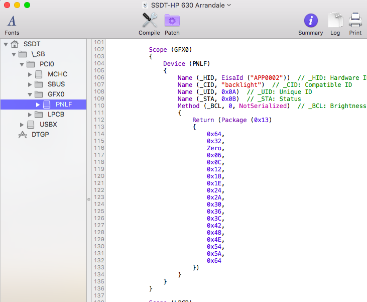

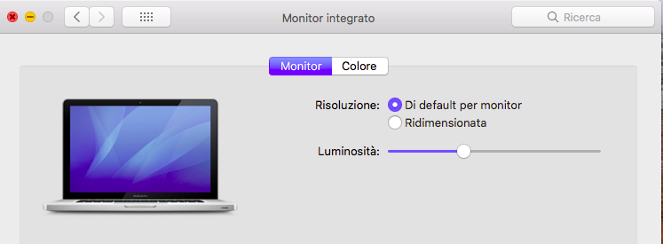

Baio77 Posted December 21, 2020 Share Posted December 21, 2020 (edited) Here in my Github EFI Legacy OC, the brightness control is missing I am working on SSDT Hack EDIT: adding IntelBacklight.kext the brightness bar appears, the control with FN keys works, but does not change the brightness https://github.com/Baio1977/HP-630-CPU-Arrandale-Bios-Legacy- SSDT-HP 630 Arrandale.aml Edited December 22, 2020 by Baio77 2 Link to comment https://www.insanelymac.com/forum/topic/286092-guide-1st-generation-intel-hd-graphics-qeci/page/84/#findComment-2747457 Share on other sites More sharing options...

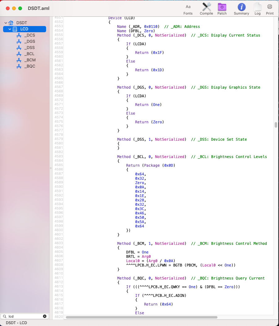

Baio77 Posted December 23, 2020 Share Posted December 23, 2020 @Badruzeus Good morning, I need your help, I hope you will see this message soon. PNLF problem : info https://github.com/daliansky/OC-little/tree/master/05-注入设备/05-2-PNLF注入方法 This section in DSDT origin SSDT-PNLF OC Little.dsl 1 Link to comment https://www.insanelymac.com/forum/topic/286092-guide-1st-generation-intel-hd-graphics-qeci/page/84/#findComment-2747538 Share on other sites More sharing options...

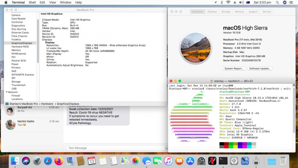

stanleyhalim Posted March 13, 2021 Share Posted March 13, 2021 Asus K52F CPU i3-350m GPU 1st Intel HD Graphic RAM 4gb SSD Lexar WiFi Broadcom Mac OS High Sierra i have issue with glitch screen all the time, been patch vram and core clock but still not fixed. opencore-2021-03-12-144421.txt config.plist Link to comment https://www.insanelymac.com/forum/topic/286092-guide-1st-generation-intel-hd-graphics-qeci/page/84/#findComment-2753013 Share on other sites More sharing options...
Baio77 Posted April 27, 2021 Share Posted April 27, 2021 Good evening has anyone managed to activate PNLF on this graphics model ?? Link to comment https://www.insanelymac.com/forum/topic/286092-guide-1st-generation-intel-hd-graphics-qeci/page/84/#findComment-2756662 Share on other sites More sharing options...

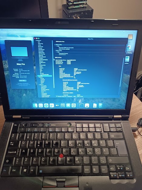

my03 Posted January 6 Share Posted January 6 Never mind. Migrated over to OpenCore and installed (during the last week) Monterey, Ventura and this evening Sonoma on the T410 without a hitch. OCLP to the rescue. Aiming for Sequioa and finally Tahoe as the icing on the cake (literally) Everything works: wifi, graphics acceleration, bluetooth, etc. Love progress... 1 Link to comment https://www.insanelymac.com/forum/topic/286092-guide-1st-generation-intel-hd-graphics-qeci/page/84/#findComment-2845935 Share on other sites More sharing options...

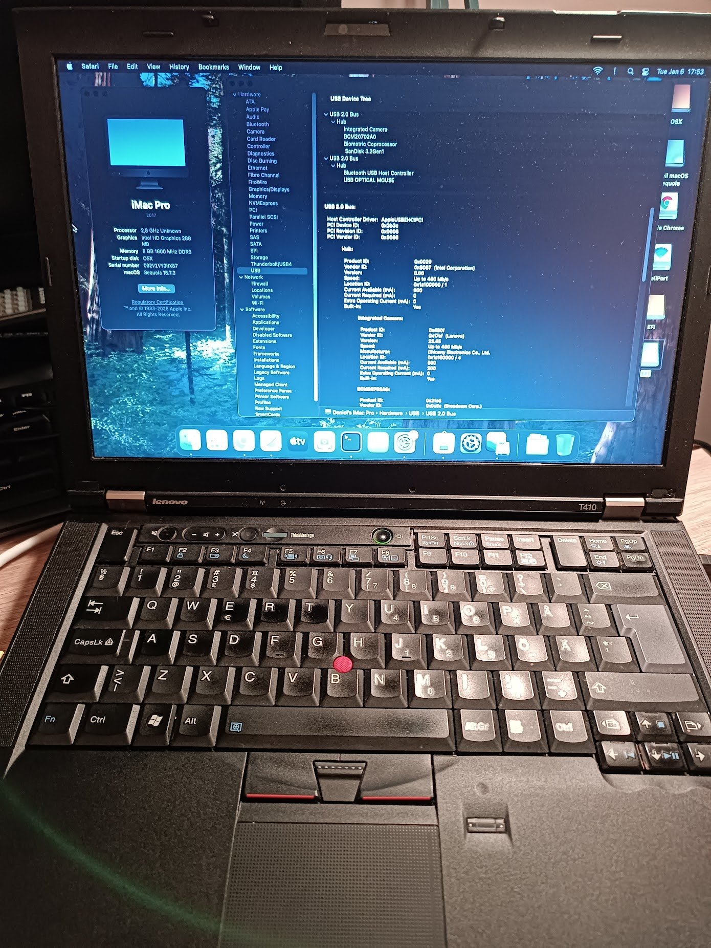

my03 Posted January 7 Share Posted January 7 (edited) On 1/6/2026 at 1:37 AM, my03 said: Never mind. Migrated over to OpenCore and installed (during the last week) Monterey, Ventura and this evening Sonoma on the T410 without a hitch. OCLP to the rescue. Aiming for Sequioa and finally Tahoe as the icing on the cake (literally) Everything works: wifi, graphics acceleration, bluetooth, etc. Love progress... And yesterday I managed to squeeze in Sequioa in there (15.7.3) I'm very happy that everything (*) works inside OSX itself. I do run this AX210 derivative which in combination with BlueToothFirmware 2.50 beta (which i believe is also now part of OCLP 3.0.0) - https://github.com/lshbluesky/IntelBluetoothFirmware/releases/tag/v2.5.0-d2?fbclid=IwY2xjawPLs75leHRuA2FlbQIxMQBzcnRjBmFwcF9pZBAyMjIwMzkxNzg4MjAwODkyAAEeGXafLWroNtEaRNbdYpJDgHnOgkh2JaiUyXvZV1D_D6NCOAQAg-Xfsu2cEhM_aem_UDj6doEh3BR78ZG1spCxOw finally makes LE devices working. (*) My only issue still is that i can't get the OC picker to work with the built in keyboard/trackpoint. I managed once to get i working, but after that its 100% usb mouse to the rescue (perhaps some timing issue, idk). My takeaway from all this is that Monterey works fast, Ventura decently, then Sonoma and Sequioa are a tiny bit sluggish on this machine (not by much, its noticeable). Edit: Got it working with the OC picker in the end. Had to get rid of everything USB (mouse/keyboard) and put PS2 counterparts in there & retract from OC 1.0.6 to 1.0.3 for it to finally work. Edited January 9 by my03 1 Link to comment https://www.insanelymac.com/forum/topic/286092-guide-1st-generation-intel-hd-graphics-qeci/page/84/#findComment-2846033 Share on other sites More sharing options...
my03 Posted January 9 Share Posted January 9 Now all works. Issue was the usb drivers for key + mouse (get rid of them) + use ps2 mouse/key drivers. But most importantly, don't use OC 1.0.6 but revert back to 1.0.3 (otherwise it "will" throw the X64 error with red text at boot). 1 Link to comment https://www.insanelymac.com/forum/topic/286092-guide-1st-generation-intel-hd-graphics-qeci/page/84/#findComment-2846159 Share on other sites More sharing options...
