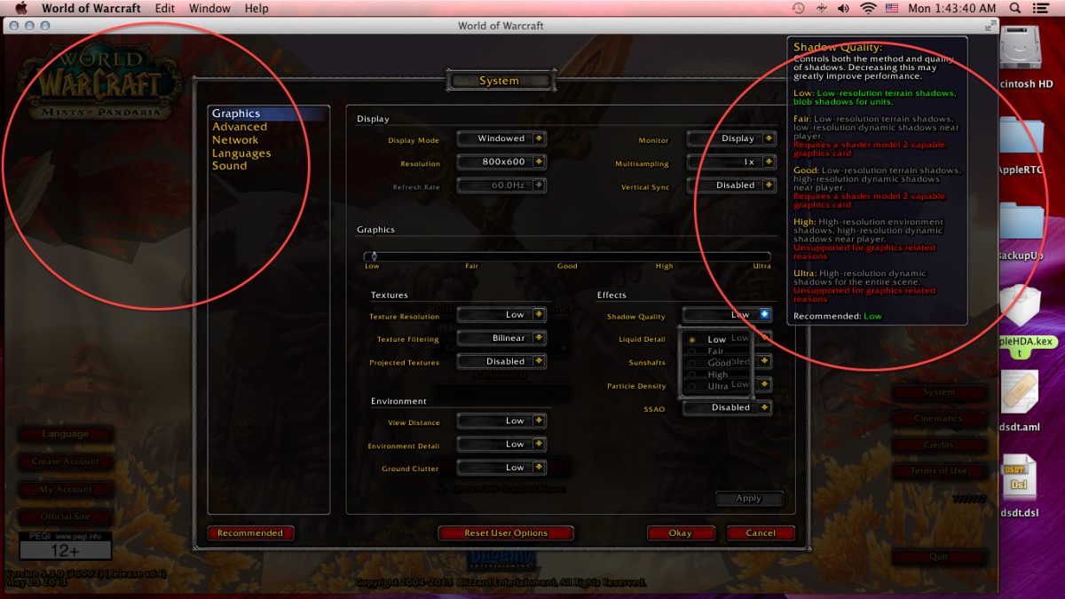

Well, this is my performance:
Anyway playing chess is like playing Battlefield 3 with our card..

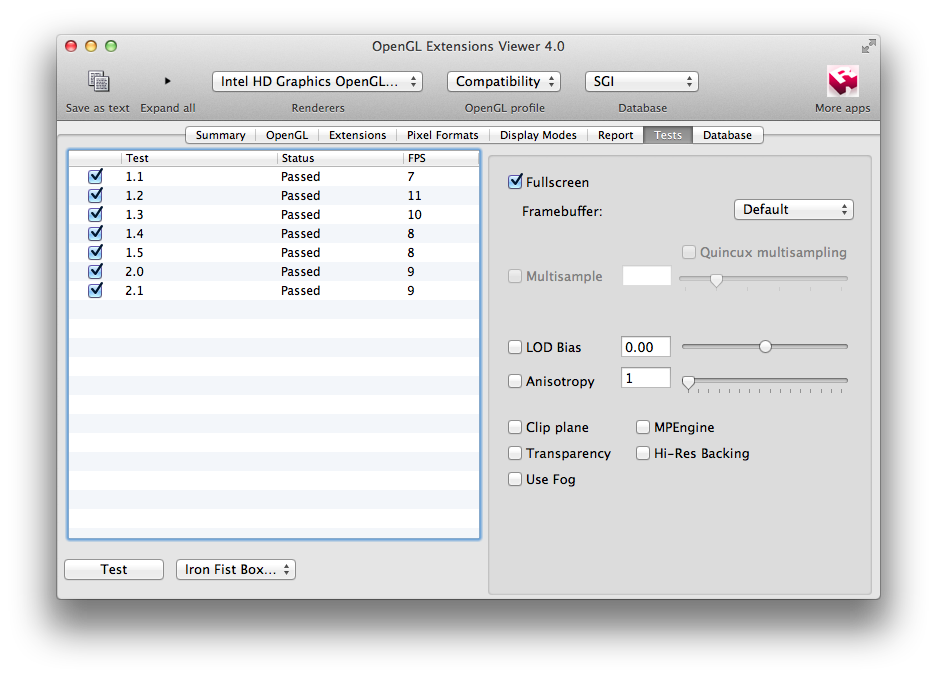

my Iron Fist King gives 6 fps.
I found the problem: Google says our intel HD 1st gen (in particular 5700mhd) supports shader model 4.0. If fact, when i launch WOW and go into settings it says that my video doesn't support shader model 2.0!!!
Please help us, I'm not alone with my problem as I see through this topic...
Look at these square leafs in the corner..
Thanks in advance for any help

It would be great if there was someone here that had a 2010 MacBook Pro and tested games and OpenGL running only on integrated graphics. That way we can compare compatibility problems and FPS issues. If they are the same, then this is Apple's fault. I read an interesting discussion forum on the Apple support forums here and it talks about users using only Intel HD Graphics to save battery life. Same as you guys report, there are issues of lag even on an official Apple product.
They did report that as of 10.8.4, performance and issues have been improved. So far I've seen a bit lag here and there, but even official Apple customers encounter similar issues.

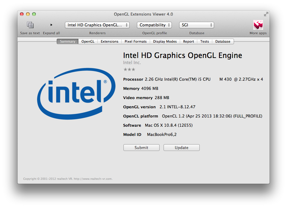

Hi GhostRaider,
Finally I have got the Intel HD to work. It's a bit slow, but I read others also have this issue.
What was needed:
- A patched/modded DSDT. It's important to search for the right Intel HD address. I recommend to do a Darwin Dump to be sure (check with lspci) or you may insert the required data into the wrong GFX0.
- Natit.kext should not be needed when using a patched DSDT
- As smbios I switched to MacBookPro6,2. I don't know if this was required
- Patched with ./hdgraphics_patcher -w 1 -p LVDS+VGA AppleIntelHDGraphicsFB
- Disabled GraphicsInjector
- Edited Info.plist:

I would like to know what the FeatureControl flags do. Anyone more info? (Should I set GPUInterruptHandling?)
A big thanks goes out to all members on this forum. Without their post (in the past) I never wouldn't got it to work. :)

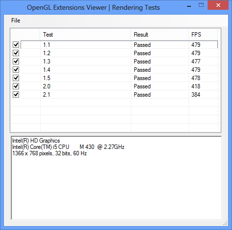

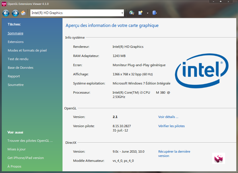

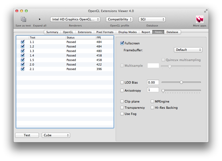

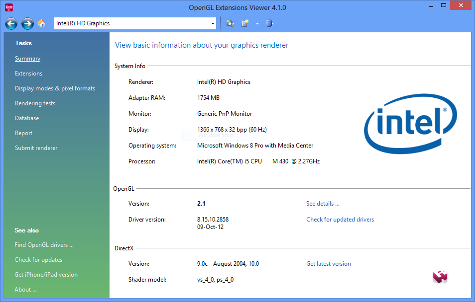

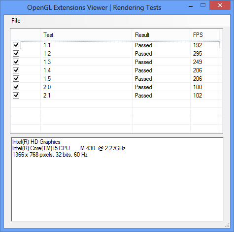

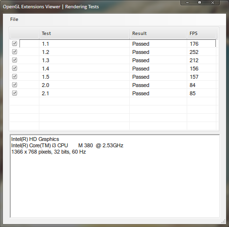

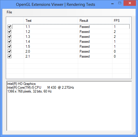

To give you an idea about the actual performance of the Arrandale graphic chip (i3-380M), here is a test with OpenGL Extensions Viewer (v4.1.0) under Windows 7 Ultimate.
I checked the graphics settings for test are the same as on OSX.
The following result can not be compared to that of OSX, and the huge difference confirms that there is indeed something wrong.
According to tests published by GhostRaider and others on the net, I'm sure OSX can perfectly exploit the potential of this iGPU.
It is true that the performance under Windows is still better but this is about 10% or 20% max.

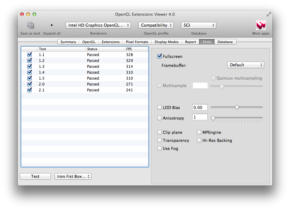

A lot more smoother interface now:

I tested OpenGL on Windows 8 and on OS X and here are the results:
post-620531-0-44495800-1370980260_thumb.png post-620531-0-87342000-1370980425_thumb.png
First is the cube:
post-620531-0-97903800-1370980074_thumb.png post-620531-0-51077100-1370980068_thumb.png
Second is the multiple cube:
post-620531-0-75696700-1370980160_thumb.png post-620531-0-44911000-1370980200_thumb.png
Third is the Iron Fist Boxer head:
post-620531-0-55445800-1370980225_thumb.png post-620531-0-34989000-1370980211_thumb.png
Fourth is multiple Iron Fist Boxer heads:
post-620531-0-72835800-1370980254_thumb.png post-620531-0-84275800-1370980247_thumb.png
Comparing both Windows 8 and OS X Mountain Lion 10.8.4, there are performance differences among the two. The one that stands out more is the multiple Iron Fist Boxer. The test struggles on Windows while on OS X, there is a bit more FPS.
*Again tests were taken on a Intel Core i5 430M at 1366x768 fullscreen.

I want to confirm my hypothesis about performance differences between i3 and i5/i7. Im just 6made some tests... when in a same laptop I use an i3-370m i obtain 6-8 fps in iron fist gl tests... when i put i5-540m the performance is between 270 - 350 fps. No modification of any plist or dsdt... the i3-370m is 2.4ghz and the i5-540m is nominal 2.53ghz.
I get 200-270 fps in Iron Fist Boxing KING (only 1 face spinning) on my i3 370m.
