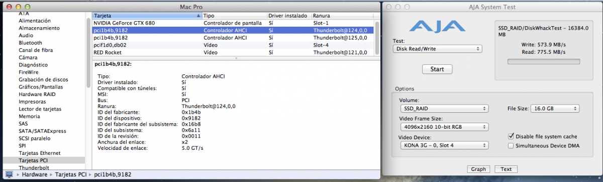

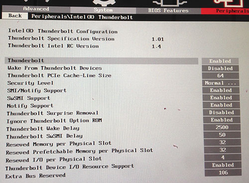

I've changed the Thunderbolt BIOS setting from 32 to 64 bits and I manage to mount (via TB) a Sonnett expansion box equipped with a Kona 3G, a Sonnett card with 2 SSD in RAID 0 or a RedRocket and have the different cards working just fine.

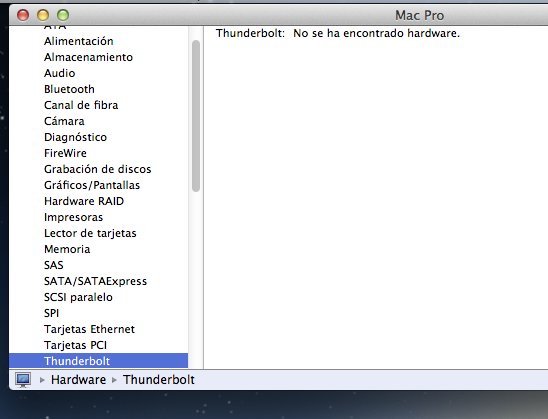

In System Info I see the cards as PCI cards but not TB connected. In the TB tag the system say explicitly that there's nothing attached but cards appears as PCI and they are working fine at TB speed.

As ILL referenced, can you confirm your thunderbolt settings in the BIOS?

I've attached 3 pics:
1&2.
Attached to TB (at boot) PCIe cards in a Sonnett TB expasion works fine but appears in this way in System Info, nothing attached in TB tag and 3 PCIe Cards (really are 2 but one of them with 2 SSD on it)
In the PCI pic you can also see the results of Aja disk test on the 2 SSD RAID0 attached via TB, the same result I get using it attached to a MBPr.
3.TB Bios Settings, I've manually changed TB PCIe Cache-Line size from 32 to 64.
