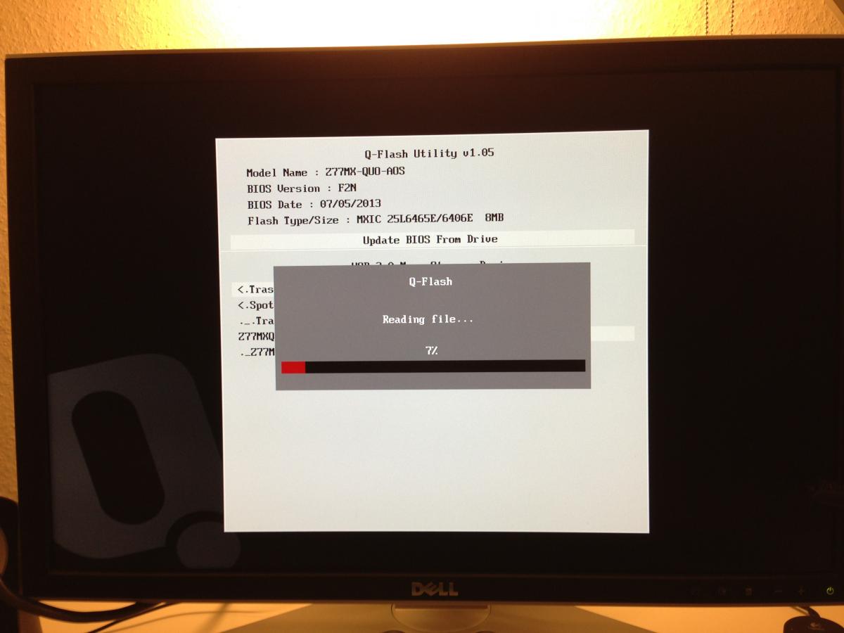

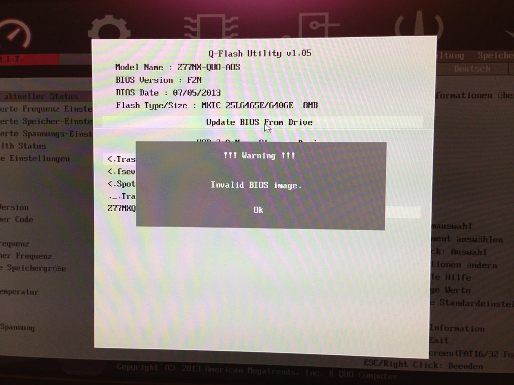

I'm not able to flash the HermitCrab Labs BIOS H3A on the quo motherboard. The Q-Flash installer told me that I have an invalid BIOS image as you can see in the picture...Can anybody help me? I formatted the USB device with MS-DOS under mac OSX.
sTaN,
I had a few bad flashes to begin with. I checked the MD5 on the compressed file but must have had some issues in the decompression.
I would suggest that you check the MD5 of the actual rom.
Open Terminal type "MD5" a space and then drag the ROM to your Terminal window to fill in the path.
MD5 /Users/YOU/Desktop/Z77MXQUOAOS.H3A.739M.ROM
It should resolve:
MD5 (LOCATION/Z77MXQUOAOS.H3A.739M.ROM) = 0075a1008cef8f2dbac913a27ebdc061
If the MD5 checksum doesn't match, try re-downloading.
Thanks for your answer but the problem was not the file but the usb device. I copied the ROM file on an 4GB device first. After formatted a 2GB device the flash worked and now I install OSX Mountain Lion from a 32GB USB device...Hope it works. I guess I only have to install the audio fix and everything is fine including sleep mode and hdmi audio? Isn't it?
sTaN,
Interesting, I didnt think it would even read the USB device without formatting as FAT32.
