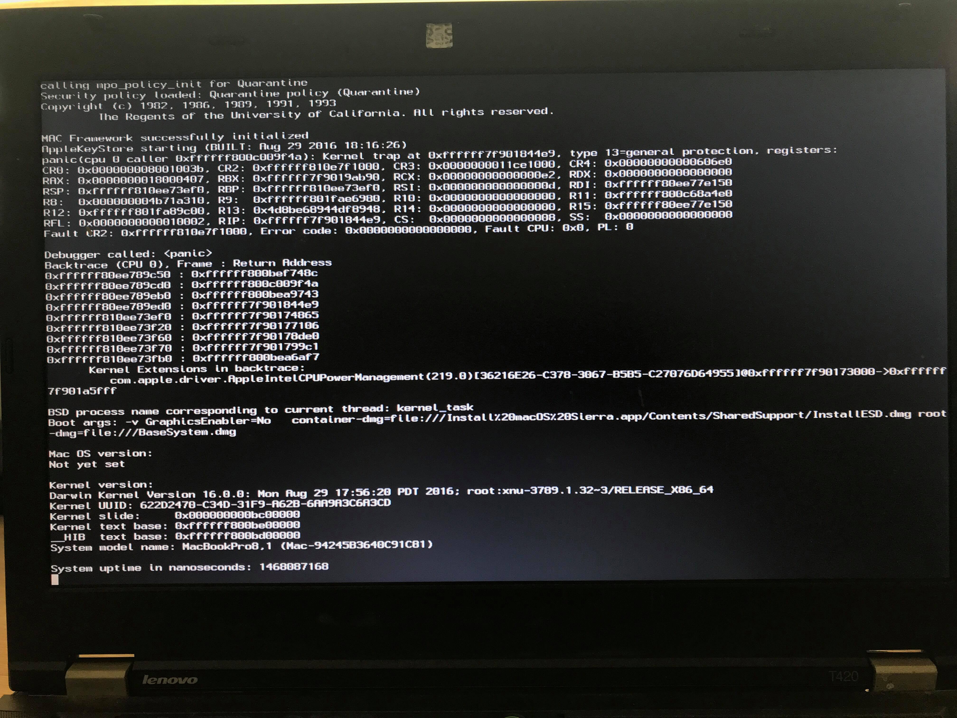

poopsnaggle Posted March 19, 2018 Share Posted March 19, 2018 Im installing Sierra but stuck here. Can you please help me. Thank you! Link to comment https://www.insanelymac.com/forum/topic/285678-lenovo-thinkpad-t420-with-uefi-only/page/162/#findComment-2604055 Share on other sites More sharing options...
Blaggah Posted March 19, 2018 Share Posted March 19, 2018 @poopsnaggle make sure that AppleCPUPM is ticked under kext and patches under clover bootloader.. Otherwise, you'd have to make sure NullCPUPowerManagement kext is inside your installer EFI/Clover/kext/other folder.. 1 Link to comment https://www.insanelymac.com/forum/topic/285678-lenovo-thinkpad-t420-with-uefi-only/page/162/#findComment-2604056 Share on other sites More sharing options...
poopsnaggle Posted March 19, 2018 Share Posted March 19, 2018 6 hours ago, Blaggah said: @poopsnaggle make sure that AppleCPUPM is ticked under kext and patches under clover bootloader.. Otherwise, you'd have to make sure NullCPUPowerManagement kext is inside your installer EFI/Clover/kext/other folder.. Its working now. Thank you so much! Link to comment https://www.insanelymac.com/forum/topic/285678-lenovo-thinkpad-t420-with-uefi-only/page/162/#findComment-2604105 Share on other sites More sharing options...

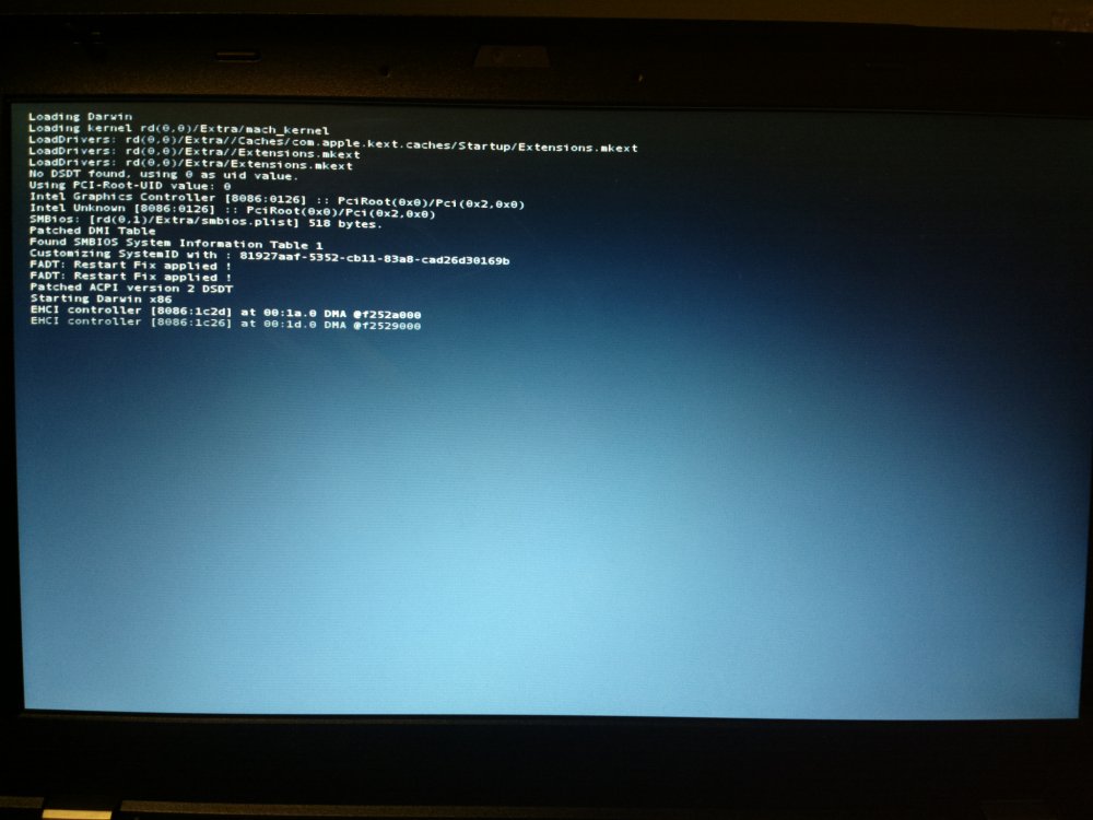

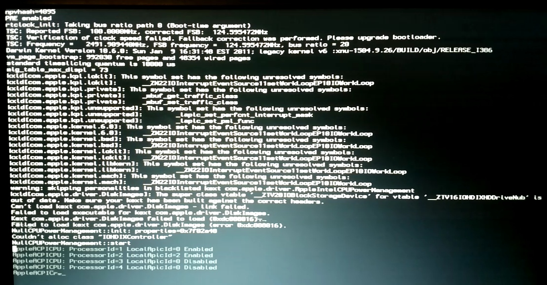

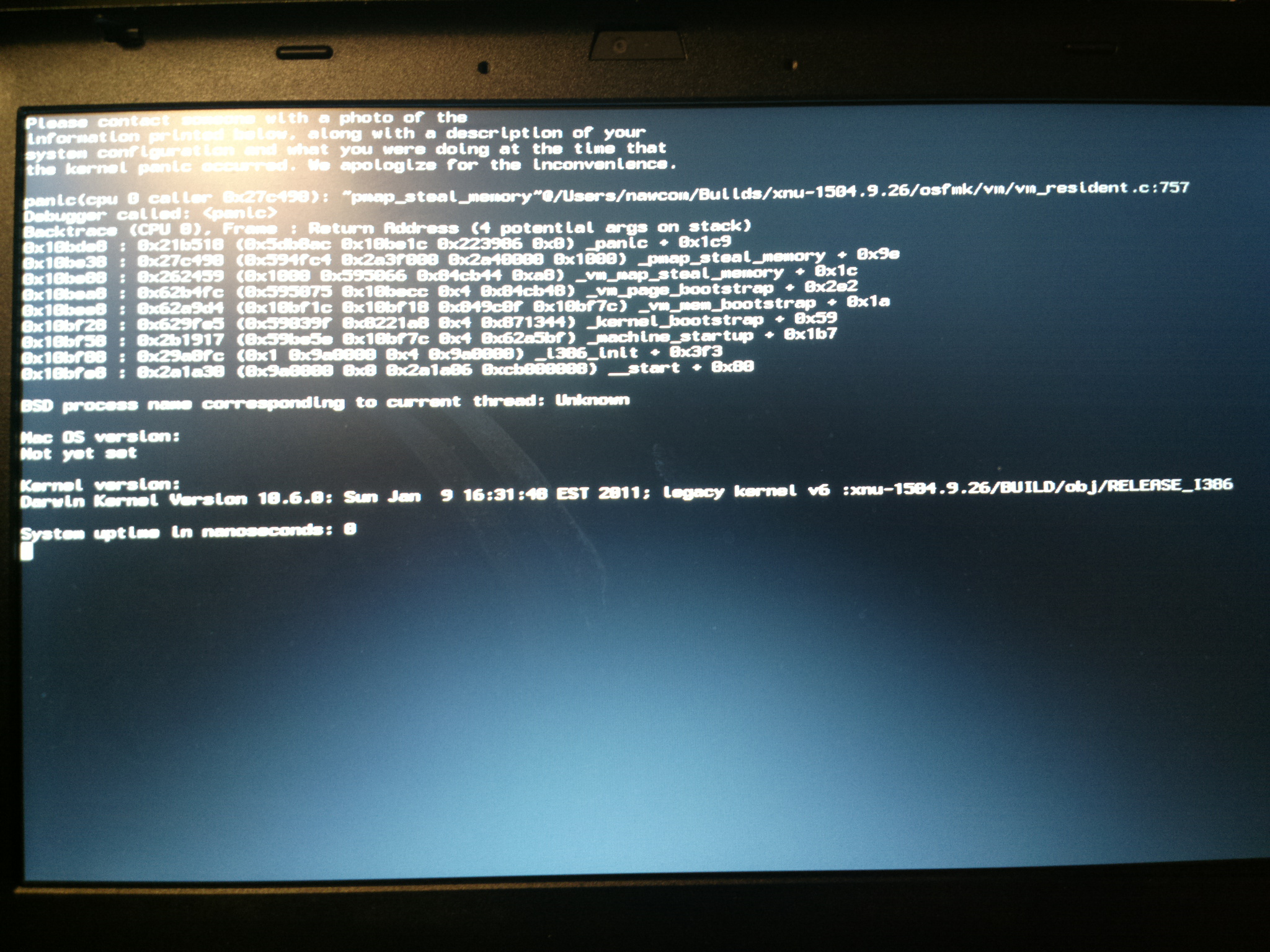

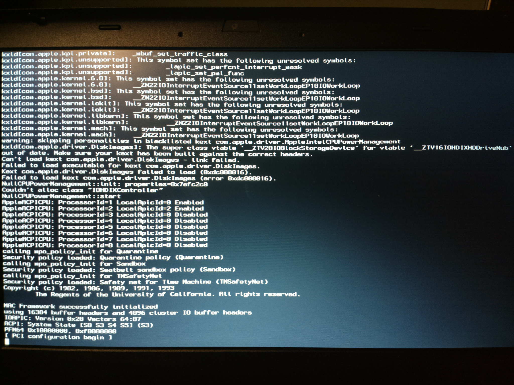

ASROCK_IIfx Posted March 19, 2018 Share Posted March 19, 2018 On 3/16/2018 at 11:36 PM, chris1111 said: Create a MacBook Pro 8.2 SMBIOS with Clover configurator and patch DSDT with MacIasl Neither of these ran in Snow Leopard. Do I need to run them on an up to date Mac ? part way through the 10.6.8 update the system panicked. On reboot I get the following screens. Any ideas ? Link to comment https://www.insanelymac.com/forum/topic/285678-lenovo-thinkpad-t420-with-uefi-only/page/162/#findComment-2604315 Share on other sites More sharing options...
tluck Posted March 19, 2018 Share Posted March 19, 2018 hmm. seems like you are using Chameleon? i see references to loading of config and kexts from /Extra ??? otherwise, maybe you could copy the already installed snow leopard from your real mac to a HD partition for your T420 system? 1 Link to comment https://www.insanelymac.com/forum/topic/285678-lenovo-thinkpad-t420-with-uefi-only/page/162/#findComment-2604320 Share on other sites More sharing options...
ASROCK_IIfx Posted March 20, 2018 Share Posted March 20, 2018 Hi tluck, I'm going to try a different tack. First of all my current drive that has El Capitan on is only a 64Gig SSD which works fine but I have a spare 250 Gig spinning disk and have partitioned that in to two halves. I want to put El Capitan on one half and get that up and running. El Capitan has been running fine so I will use that again. Thing is Insanelymac seems to have changed over the last week or so and I can't find your original pages for putting El Cap on to a T420. Your latter posts refer to packages that are for Sierra or High Sierra. Please could you point me to the post for El Cap on T420 as I can't seem to find it. Once I've got El Cap running on the larger drive I might try and put Snow Leopard on the other half. My T420 is i5 and HD3000 1366x768 , also has broadband 3G module. Not sure if I'd ever get that working under OSX. Thanks. Link to comment https://www.insanelymac.com/forum/topic/285678-lenovo-thinkpad-t420-with-uefi-only/page/162/#findComment-2604437 Share on other sites More sharing options...
tluck Posted March 20, 2018 Share Posted March 20, 2018 (edited) El Cap zip https://www.insanelymac.com/applications/core/interface/file/attachment.php?id=240230 Sierra works quite well too. (current zip supports it). High Sierra is doing great on one of my T420 systems - the one that has an LG display vs not-very-good-at-all AUO display. Edited March 20, 2018 by tluck 1 Link to comment https://www.insanelymac.com/forum/topic/285678-lenovo-thinkpad-t420-with-uefi-only/page/162/#findComment-2604643 Share on other sites More sharing options...
ASROCK_IIfx Posted March 20, 2018 Share Posted March 20, 2018 1 hour ago, tluck said: El Cap zip https://www.insanelymac.com/applications/core/interface/file/attachment.php?id=240230 Sierra works quite well too. (current zip supports it). High Sierra is doing great on one of my T420 systems - the one that has an LG display vs not-very-good-at-all AUO display. Thanks for the zip. Please could you direct me to the instructions page as I can no longer find it. My old bookmarks go up to page 201 for this topic but now it only seems to have 162 pages since insanelymac changed a week or so ago :-( Link to comment https://www.insanelymac.com/forum/topic/285678-lenovo-thinkpad-t420-with-uefi-only/page/162/#findComment-2604668 Share on other sites More sharing options...
