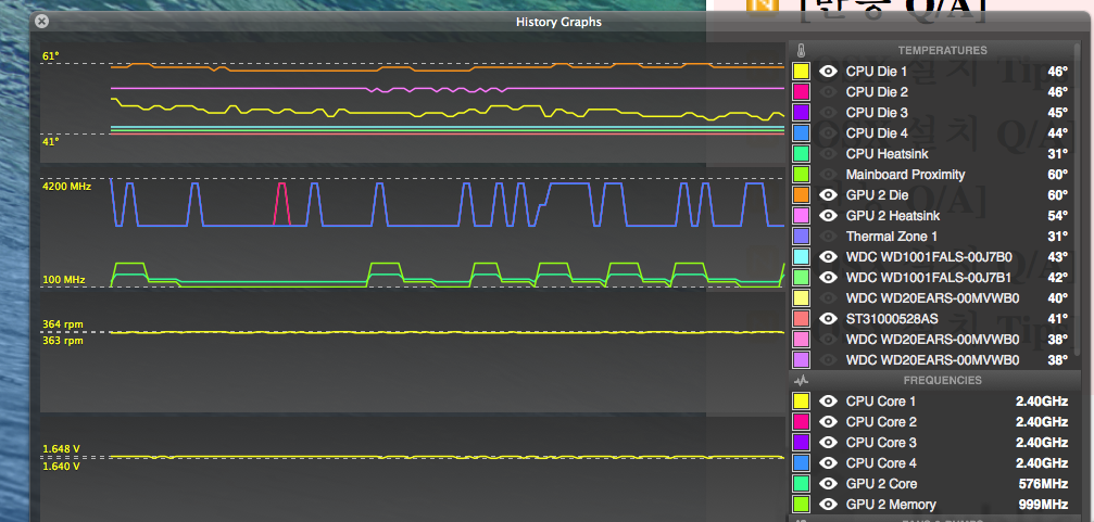

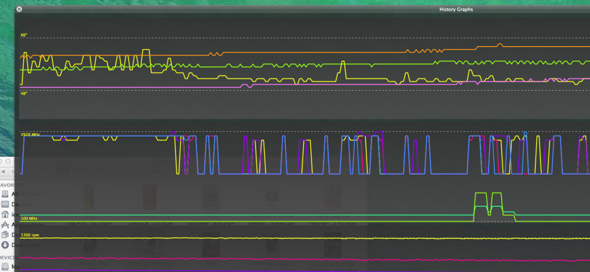

I found that overclock with clover needs ssdt.(without it panic or slow system clock)
When normal clock clover nor chameleon needs ssdt.aml with my x58 board.
post-772374-0-21880200-1377603597_thumb.png normal clock without ssdt
post-772374-0-55205600-1377603700_thumb.pngoverclock with maciasl generic ssdt
same macpro5,1 smbios and show different multipliers.
