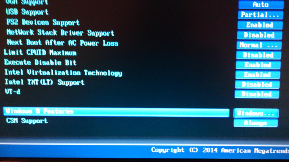

arsradu Posted September 18, 2015 Share Posted September 18, 2015 To have an advantage I have to go to BIOS and find here CSM support. It appears only if I switch OS from Other to Windows 8 WHQL. With WIndows 8 WHQL setting I can disable CSM support. As well full screen logo must be disabled. This information was pure gold! Thank you so much. I would have searched a long time for that option in BIOS, and wouldn't figure out that I need to look under Windows 8 or Windows 8 WHQL to find it. Good news? It's there! And it can be disabled (I just did). 1 Link to comment https://www.insanelymac.com/forum/topic/284656-clover-general-discussion/page/323/#findComment-2168875 Share on other sites More sharing options...
