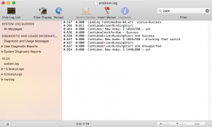

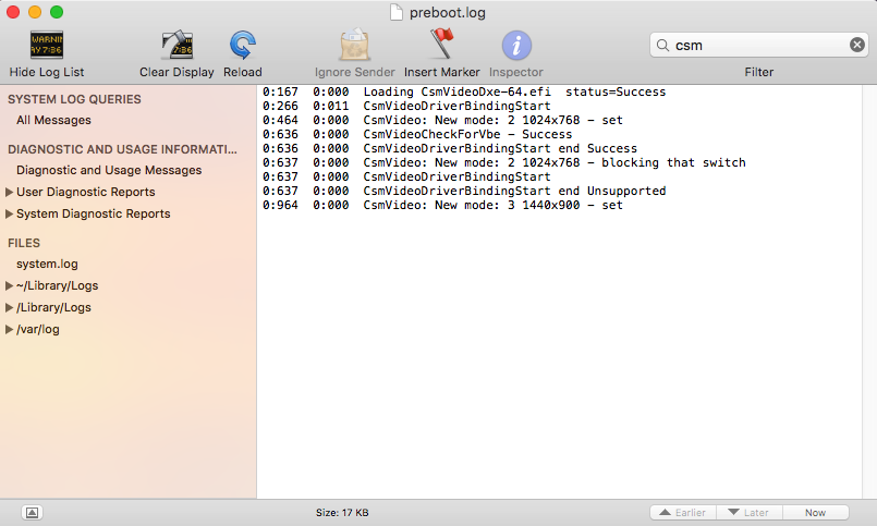

Slice Posted September 17, 2015 Share Posted September 17, 2015 Thanks, Slice! Well, the resolution is specified in the config.plist. And it's also present in the log, as you can see below. Preboot.log attached, as well, in case you want to check out other things. Looks good 2:392 0:003 SetScreenResolution: 1440x900 - setting Mode 3 2:617 0:224 Video mode change to mode #3: Success 2:617 0:000 Console modes reported: 4, available modes: 2:617 0:000 Mode 1: 80x25 (current mode) 2:617 0:000 Mode 3: 100x31 2:617 0:000 Mode 4: 128x30 If you still have an issue use CsmVideoDxe.efi. It is not loaded now. Use fdisk I got this Jianwei:~ jianweiliu$ sudo fdisk /dev/disk0 Password: Disk: /dev/disk0 geometry: 15566/255/63 [250069680 sectors] Signature: 0xAA55 Starting Ending #: id cyl hd sec - cyl hd sec [ start - size] ------------------------------------------------------------------------ 1: EE 1023 254 63 - 1023 254 63 [ 1 - 250069679] 2: 00 0 0 0 - 0 0 0 [ 0 - 0] unused 3: 00 0 0 0 - 0 0 0 [ 0 - 0] unused 4: 00 0 0 0 - 0 0 0 [ 0 - 0] unused There is no Active partition Jianwei:~ jianweiliu$ diskutil list /dev/disk0 #: TYPE NAME SIZE IDENTIFIER 0: GUID_partition_scheme *128.0 GB disk0 1: EFI EFI 209.7 MB disk0s1 2: Apple_HFS Mavericks 64.0 GB disk0s2 3: Apple_Boot Recovery HD 650.0 MB disk0s3 4: Microsoft Reserved 134.2 MB disk0s4 5: Microsoft Basic Data 62.6 GB disk0s5 /dev/disk1 #: TYPE NAME SIZE IDENTIFIER 0: GUID_partition_scheme *31.6 GB disk1 1: EFI EFI 209.7 MB disk1s1 2: Apple_HFS Install OS X Mavericks 31.3 GB disk1s2 /dev/disk2 #: TYPE NAME SIZE IDENTIFIER 0: GUID_partition_scheme *1.0 TB disk2 1: EFI EFI 209.7 MB disk2s1 2: Apple_HFS HDD 999.9 GB disk2s2 It's impossible to have GPT without EFI and ESP in most computer,how could you say I couldn't have ESP?And how could you say boot0ss scan hfs+ when boot0ss boot ESP on my computer.How could you say I have ESP and don't have ESP when I use boot0af and boot0ss?Boot sector doesn't affect ESP exist. This is OK. You have GPT drives with real ESP and have to use boot0af. It will be good as I do the same on my computers. Your question is just language barrier. Link to comment https://www.insanelymac.com/forum/topic/284656-clover-general-discussion/page/322/#findComment-2168590 Share on other sites More sharing options...
magnifico Posted September 17, 2015 Share Posted September 17, 2015 preboot.log will be enough ./bdmesg >boot.log bdmesg.zip This is amazing Link to comment https://www.insanelymac.com/forum/topic/284656-clover-general-discussion/page/322/#findComment-2168600 Share on other sites More sharing options...
arsradu Posted September 17, 2015 Share Posted September 17, 2015 Looks good 2:392 0:003 SetScreenResolution: 1440x900 - setting Mode 3 2:617 0:224 Video mode change to mode #3: Success 2:617 0:000 Console modes reported: 4, available modes: 2:617 0:000 Mode 1: 80x25 (current mode) 2:617 0:000 Mode 3: 100x31 2:617 0:000 Mode 4: 128x30 If you still have an issue use CsmVideoDxe.efi. It is not loaded now. You are correct. It's not loaded now because I removed it. As I said above, with our without it, the issue is still there. I can reinstall that driver and come back with an updated preboot/boot log (cause now I know how to make one ) which will probably show CsmVideoDxe.efi as being loaded. But I'm not sure that will make any difference to the actual problem. I don't know. If you think it's worth it, I'll do it. Slice, is this supposed to happen? I took a fresh new boot.log now and this is what I found. boot.log.zip Link to comment https://www.insanelymac.com/forum/topic/284656-clover-general-discussion/page/322/#findComment-2168604 Share on other sites More sharing options...
liujianwei Posted September 17, 2015 Share Posted September 17, 2015 Looks good 2:392 0:003 SetScreenResolution: 1440x900 - setting Mode 3 2:617 0:224 Video mode change to mode #3: Success 2:617 0:000 Console modes reported: 4, available modes: 2:617 0:000 Mode 1: 80x25 (current mode) 2:617 0:000 Mode 3: 100x31 2:617 0:000 Mode 4: 128x30 If you still have an issue use CsmVideoDxe.efi. It is not loaded now. This is OK. You have GPT drives with real ESP and have to use boot0af. It will be good as I do the same on my computers. Your question is just language barrier. No,it's OK to use boot0af on my SSD because SSD boot0af load ApplePCIIDE.kext,but it's not OK to use boot0af on my USB Flash Drive because USB boot0af doesn't load ApplePCIIDE.kext,but fakesmc.kext load whatever I do.That's my question.Why this happen? Link to comment https://www.insanelymac.com/forum/topic/284656-clover-general-discussion/page/322/#findComment-2168608 Share on other sites More sharing options...
Slice Posted September 17, 2015 Share Posted September 17, 2015 You are correct. It's not loaded now because I removed it. As I said above, with our without it, the issue is still there. I can reinstall that driver and come back with an updated preboot/boot log (cause now I know how to make one ) which will probably show CsmVideoDxe.efi as being loaded. But I'm not sure that will make any difference to the actual problem. I don't know. If you think it's worth it, I'll do it. Slice, is this supposed to happen? I took a fresh new boot.log now and this is what I found. Screen Shot 2015-09-17 at 9.11.29 PM.png This is very rare incompatibility of your nVidia and CsmVideoDxe 0:637 0:000 CsmVideoDriverBindingStart 0:637 0:000 Enable the device status=Unsupported 0:637 0:000 attributes Restored 0:637 0:000 CsmVideoDriverBindingStart end Unsupported May be you have to update VBios? Or live as is. I don't know how to resolve the issue. No,it's OK to use boot0af on my SSD because SSD boot0af load ApplePCIIDE.kext,but it's not OK to use boot0af on my USB Flash Drive because USB boot0af doesn't load ApplePCIIDE.kext,but fakesmc.kext load whatever I do.That's my question.Why this happen? Language barrier. "SSD boot0af load ApplePCIIDE.kext" - I don't understand what it means. Link to comment https://www.insanelymac.com/forum/topic/284656-clover-general-discussion/page/322/#findComment-2168619 Share on other sites More sharing options...
liujianwei Posted September 17, 2015 Share Posted September 17, 2015 This is very rare incompatibility of your nVidia and CsmVideoDxe 0:637 0:000 CsmVideoDriverBindingStart 0:637 0:000 Enable the device status=Unsupported 0:637 0:000 attributes Restored 0:637 0:000 CsmVideoDriverBindingStart end Unsupported May be you have to update VBios? Or live as is. I don't know how to resolve the issue. Language barrier. "SSD boot0af load ApplePCIIDE.kext" - I don't understand what it means. Clover doesn't have CSM,which means doesn't have fully MBR support.You wanna deny yourself? Link to comment https://www.insanelymac.com/forum/topic/284656-clover-general-discussion/page/322/#findComment-2168629 Share on other sites More sharing options...

arsradu Posted September 18, 2015 Share Posted September 18, 2015 This is very rare incompatibility of your nVidia and CsmVideoDxe 0:637 0:000 CsmVideoDriverBindingStart 0:637 0:000 Enable the device status=Unsupported 0:637 0:000 attributes Restored 0:637 0:000 CsmVideoDriverBindingStart end Unsupported May be you have to update VBios?Or live as is. I don't know how to resolve the issue. Yesterday I had to (re)install Windows 10 (which I hate, by the way) on my PC in order to check the VBIOS version and maybe flash a newer one, if available. Not sure there is anything newer than that (although that version seems to be from 2012)... I've seen something on MSi forums here. And that is the exact model of my card, and that is the exact same VBIOS that guy is having (80.07.35.00.04). But I don't understand: is there such a thing as an "UEFI Bios for the video card?". Is this what I should be looking for? And is that one (the one posted as reply) newer than the one I have? And what the hell is UEFI GOP BIOS? What is GOP in this circumstance? Go Pro? ) Anyway, I was thinking...could it really be because of incompatibility with CsmVideoDxe driver, when I have the exact same problem with or without it, once I select Patch VBios? I can also take your advice and leave it as it is, if this proves itself to be harder than it looks to fix, but when I get a higher res monitor, wouldn't this issue persist, making graphics even less appealing, considering the card will be the same one, the CsmVideoDxe driver will be the same one and the patch for Vbios will be the same one? Link to comment https://www.insanelymac.com/forum/topic/284656-clover-general-discussion/page/322/#findComment-2168720 Share on other sites More sharing options...
