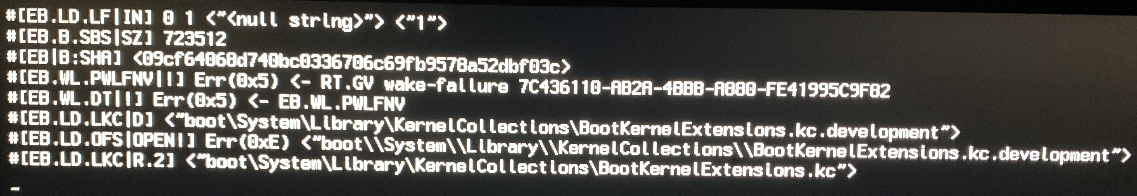

cankiulascmnfye Posted September 4, 2023 Share Posted September 4, 2023 48 minutes ago, Matgen84 said: @jsl2000 @cankiulascmnfye Try latest commit 7d21f54: boot fine here 😊 I did that. It does not work. Same error 1 Link to comment Share on other sites More sharing options...
Matgen84 Posted September 4, 2023 Share Posted September 4, 2023 1 hour ago, cankiulascmnfye said: I did that. It does not work. Same error Do use CloverPKG to update ? Or only copy/past BOOTX64 and CLOVERX64 ? For my part, I use an EFI folder on the desktop to update the two Clover files . Then I mount the ESP partion, delete the existing EFI folder and empty the trash. Finally, I copy the desktop folder to the EFI partition. Because sometimes I have the same problem as you. Link to comment Share on other sites More sharing options...
cankiulascmnfye Posted September 4, 2023 Share Posted September 4, 2023 6 hours ago, Matgen84 said: Do use CloverPKG to update ? Or only copy/past BOOTX64 and CLOVERX64 ? For my part, I use an EFI folder on the desktop to update the two Clover files . Then I mount the ESP partion, delete the existing EFI folder and empty the trash. Finally, I copy the desktop folder to the EFI partition. Because sometimes I have the same problem as you. I update it manually. I don't use Clover on my system's ESP I use a USB flash drive just for testing. I don't see how deleting the EFI folder could resolve issues seemingly related to Clover's way of handling Kernel Collections… weird Link to comment Share on other sites More sharing options...
Slice Posted September 4, 2023 Share Posted September 4, 2023 Clover uses Opencore to handle Kernel Collection. 2 1 Link to comment Share on other sites More sharing options...

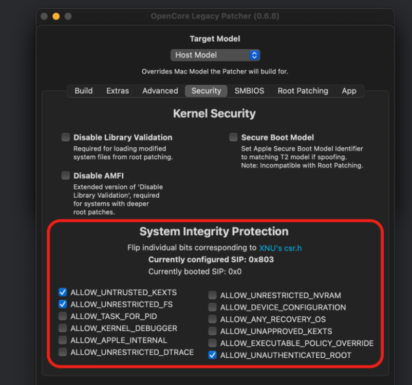

Slice Posted September 4, 2023 Share Posted September 4, 2023 On 9/1/2023 at 8:32 PM, matxpa said: Yes I've already tried it since few days as you could see on this screenshot below (r5155 (2711170) local XCOD8 build) So try r5155 without BlockSkywalk in config.plist, with BlockSkywalk activated, with BlockSkywalk deactivated And the reason why i would try this r5155 release is the BCM94360 Wifi card on this Asus Laptop, i suppose it's a legitimate reason. Reveal hidden contents And to close this topic look in CloverBootloader/rEFIt_UEFI/Settings/ConfigPlist/Config_KernelAndKextPatches.h line code number 318 ... rEFIt_UEFI/Settings/ConfigPlist/Config_KernelAndKextPatches.h:318: XBool dgetBlockSkywalk() const { return BlockSkywalk.isDefined() ? BlockSkywalk.value() : XBool(true); }; ... Regards As I see it is better to set "false" by default? 2 Link to comment Share on other sites More sharing options...
Matgen84 Posted September 5, 2023 Share Posted September 5, 2023 12 hours ago, cankiulascmnfye said: I update it manually. I don't use Clover on my system's ESP I use a USB flash drive just for testing. I don't see how deleting the EFI folder could resolve issues seemingly related to Clover's way of handling Kernel Collections… weird Because sometimes, I have a bad behavior if I copy directly to ESP, BOOTX64 and CLOVERX64 files. Link to comment Share on other sites More sharing options...
jsl2000 Posted September 6, 2023 Share Posted September 6, 2023 On 9/5/2023 at 4:23 AM, Slice said: As I see it is better to set "false" by default? In my M5A hackintosh I can boot Sonoma beta 7 by legacy Clover 5154 with BlockSkywalk=False. If it's True I'll get KP (unable to kext scan) during booting. But in B85M-G hackintosh I got different results which bothered me up to now ! 3 Link to comment Share on other sites More sharing options...

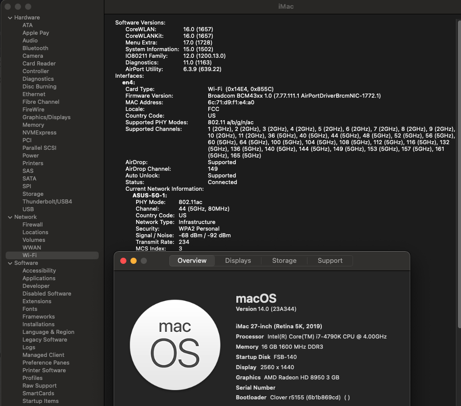

mariosun Posted September 9, 2023 Share Posted September 9, 2023 (edited) @SliceIs it possible to declare in clover bootloader the kext order like it is possible to do in opencore In clover bootloader i cant enable my Broadcom wifi in Sonoma adding the required kext and the bootarg (also disabling sip is a mandatory condition) mandatory steps are in Opencore secureboot disabled (ok also in clover) disabling sip (ok also in clover) bootarg amfi=0x80 (ok also in clover) block com.apple.iokit.IOSkywalkFamily (no sure it is ok in clover kexts order: IOSkywalkFamily.kext IO80211FamilyLegacy.kext IO80211FamilyLegacy.kext/Contents/PlugIns/AirPortBrcmNIC.kext (i put them in kexts/14 folder but i cant give the same opencore order) any advice or info to be able to use this wifi also in your bootloader? thank you edit Clover log: 2023-09-08_06-46_CLOVERX64.efi.log Edited September 9, 2023 by mariosun clover log 1 Link to comment Share on other sites More sharing options...
