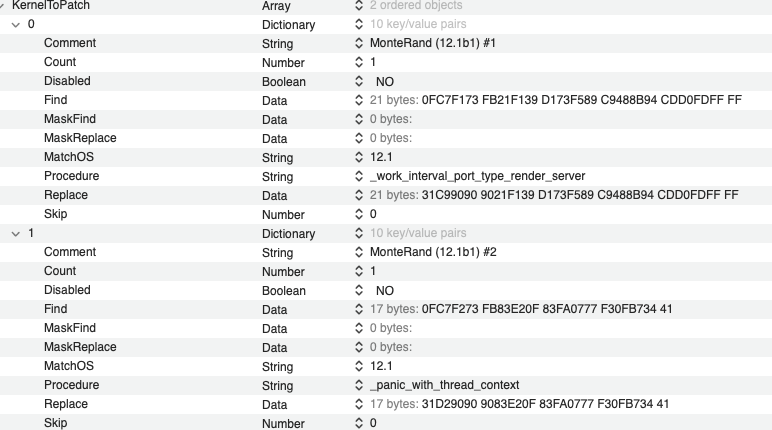

For me, with Clover 5141 to update the latest Beta’s (except RC2) I have needed to use OC to initiate the update then let clover take over after the first reboot. How ever with RC2 I was taught a few things.
HWTarget rtvariable was used to initiate the download process of the new update but I had to delete (not comment out) the HWTarget from rtvariables before the first reboot or else I would get stuck in a reboot loop.
I also only used the ExtendedFirmwareFeatures and it’s Mask and commented out the standard FirmwareFeatures and it’s Mask.
I also had RestrictEvents kext in place.
So I cannot say if all of the above are needed but this is what eventually worked for me.
As usual your mileage may vary but the above worked for me when nothing else would on both my hacks with MacBookPro16,4 and iMacPro1,1 smbios.

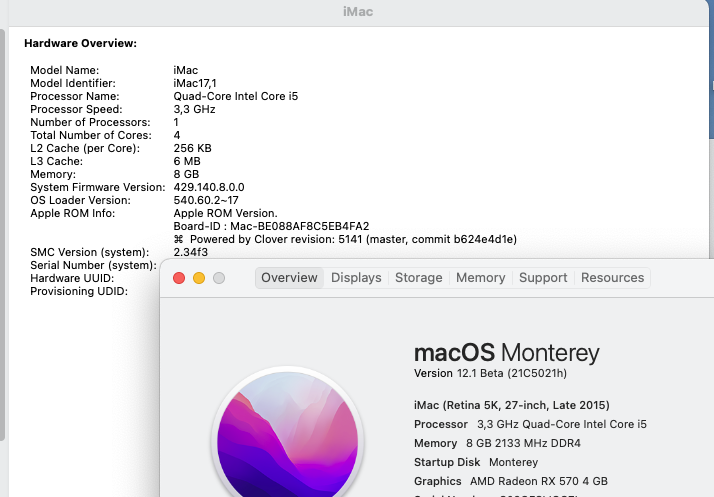

Clover 5141 : update for beta 12.1 OK, (with SMBIOS iMacPro1,1) : kext RestrictEvents (without bootarg), ExtendedFirmwares, no HWTarget key

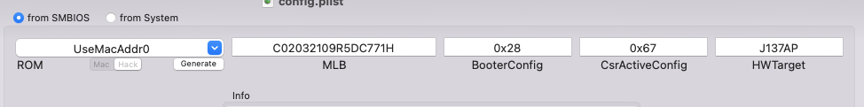

Hey @Slice! As you explained at the Clover Change Explanations about the ExtendedFirmwareFeatures feature, I just need to use only it to install Monterey and gets updates available right?
Like this 👇🏽
Thank you guys
Exactly.

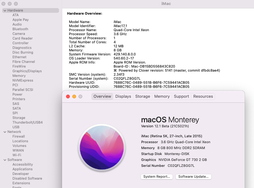

Both are needed IMHO, like previous  ExtendedFirmwareFeatures and ExtendedFirmwareMask (32bits) 🙂
I use them for my Imac19,1 (Z390).

Thanks. And what about HWTarget? Is that needed just for the updates to show them delete them entry before first reboot?
Sent from my iPhone using Tapatalk
I don't know yet. It probably needed only for T2 models. It is not needed for me (iMac17,1).

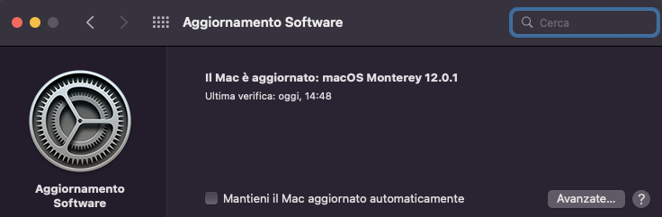

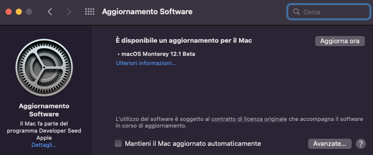

after spending all the installation time, which is 29 minutes at the time it should restart, it will show another error that I'll leave in the next print
after even restarting in force it goes back to the installation of 29 minutes and returns to make the same error and this always
with the OC, the entire phase passes without any problem
the same happens with the update!
Spoiler
250311423_466039231454046_9113517977503578105_n.jpeg.b865ddfa36600299a793ba26954330d9.jpeg
I would just like to try to understand why this happens with Clover and the OC installs well.
Thank you for the time dedicated to the community, past work and longevity.
I am a high supporter of Clover because I find advantages in Clover that I don't have in OpenCore such as managing Dual boot and being more friendly with NVRAM not complicating in Bios
ps:
once again I KNOW that there will be errors in the translation but I don't understand English!
i apologize for that
