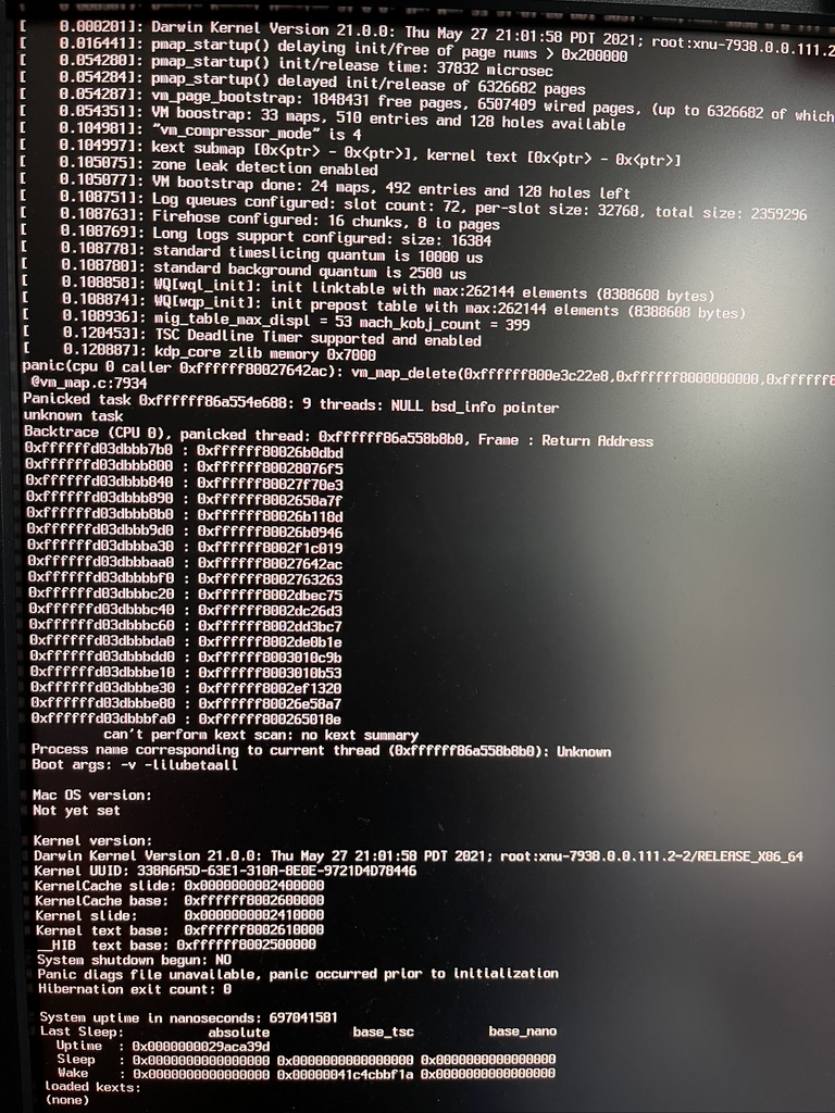

clean install of Monterey
Attempt successful!
Hack Z170 in signature, with Clover 5136 I tried to update high sierra installed in HFS in monterey, the biggest difficulty was that the kexts compiled just before the attempt, one of them immediately sent the system into kernel panic on the first reboot, but using the old catalina kexts, adding boot arg -lilubetall -wegbeta as a precaution then everything went smoothly
PS: I was forgetting, I created folder 12 in Clover for kexts
At the moment the only problem seems to be the BT and wi-fi injector (BluetoothDevBroadcomInjector.kext BroadcomWiFiInjector.kext) they don't work, they block the monterey boot
