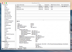

enyson Posted July 19, 2015 Share Posted July 19, 2015 I have a problem my system identify my lan adapter as a bluetooth pan. and i get no wired connection. , i try change the kexts of my ethernet adapter (atheros AR8151) ALXEthernet.kext... AtherosL1cEthernet.kext... Atheros222Ethernet.kext i try remove all bluetooth kexts. disable bluetooth on the bios. but northing works. before i enable the bluetooth everything works perfect. after enable. i can't get working again. Link to comment https://www.insanelymac.com/forum/topic/284119-experimental-atheros-ar813132515261627172-driver-for-107108/page/6/#findComment-2154209 Share on other sites More sharing options...
