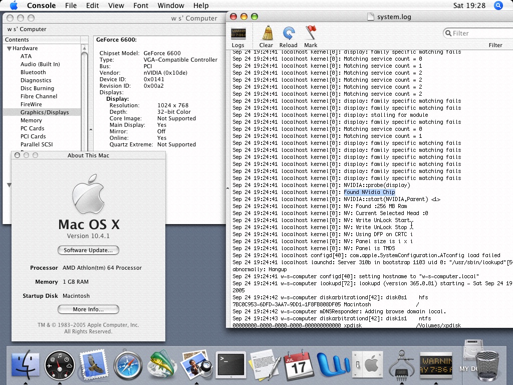

wiebeest Posted September 24, 2005 Share Posted September 24, 2005 {censored}, I can't seem to get it right. NVidia Geforce 6600 PCIe (Leadtek WinFast px6600td 256mb) In Windows: DirectDiag: --------------- Display Devices --------------- Card name: NVIDIA GeForce 6600 Manufacturer: NVIDIA Chip type: GeForce 6600 DAC type: Integrated RAMDAC Device Key: Enum\PCI\VEN_10DE&DEV_0141&SUBSYS_2001107D&REV_A2 Display Memory: 256.0 MB Current Mode: 1024 x 768 (32 bit) (85Hz) Monitor: SONY HMD-A220 Monitor Max Res: 1280,1024 Driver Name: nv4_disp.dll Driver Version: 6.14.0010.7777 (English) DDI Version: 9 (or higher) Driver Attributes: Final Retail Driver Date/Size: 7/20/2005 21:07:00, 3908864 bytes WHQL Logo'd: n/a WHQL Date Stamp: n/a VDD: n/a Mini VDD: nv4_mini.sys Mini VDD Date: 7/20/2005 21:07:00, 3198368 bytes Device Identifier: {D7B71E3E-4201-11CF-AC6D-0B0003C2CB35} Vendor ID: 0x10DE Device ID: 0x0141 SubSys ID: 0x2001107D Revision ID: 0x00A2 Revision ID: 0x00A2 In OS X: Profiler -->Display: Type: VGA-Compatible Controller Bus: PCI Vendor ID: 0x15ad Device ID: 0x0405 Revision ID: 0x0000 Kernel Extension Info: No Kext Loaded So I'd say I should edit the .plist to 0x040515ad --> no show. But then I notice that NVidia = 10de --> I change it to 0x040510de. Still no show. What puzzles me is that under Windows DirectX gives me different ID's than OS X does; VEN_10DE&DEV_0141. Shouldn't ID's be the same in osx & windows (since the ID's are substracted from the GPU's hardware?) What am I doing wrong here? Or perhaps my card not supported yet? Should I try to change it to the windows ID's? Or do I risk OSX no longer booting? Any advice would be very welcome. Link to comment Share on other sites More sharing options...

jordanvanbergen Posted September 24, 2005 Share Posted September 24, 2005 {censored}, I can't seem to get it right. Device Key: Enum\PCI\VEN_10DE&DEV_0141&SUBSYS_2001107D&REV_A2 So I'd say I should edit the .plist to 0x040515ad --> no show. But then I notice that NVidia = 10de --> I change it to 0x040510de. Still no show. What puzzles me is that under Windows DirectX gives me different ID's than OS X does; VEN_10DE&DEV_0141. Shouldn't ID's be the same in osx & windows (since the ID's are substracted from the GPU's hardware?) What am I doing wrong here? Or perhaps my card not supported yet? Should I try to change it to the windows ID's? Or do I risk OSX no longer booting? Any advice would be very welcome. Try: <key>IOPCIMatch</key> <string>0x014110de&0xfff8ffff 0x026d10de&0xfff8ffff 0x017910de 0x018010de&0xfff8ffff 0x018810de 0x018910de 0x020010de&0xfff8ffff 0x025010de&0xfff8ffff 0x028010de&0xfff8ffff 0x030010de&0xfff8ffff 0x031010de&0xfff8ffff 0x031910de 0x034910de</string> After saving the Info.plist from the NVidia.kext Contents directory make sure all directories have the correct user permissions: root:wheel /NVidia.kext/ ... .... After this clear the extension cache, delete the files: /System/Library/Extensions.kextcache /System/Library/Extensions.mkext And reboot. Hopefully it will function now! Regards Jordan Link to comment Share on other sites More sharing options...
wiebeest Posted September 24, 2005 Share Posted September 24, 2005 NVidia Geforce 6600 PCIe (Leadtek WinFast px6600td 256mb) So I'd say I should edit the .plist to 0x040515ad --> no show. But then I notice that NVidia = 10de --> I change it to 0x040510de. Still no show. What puzzles me is that under Windows DirectX gives me different ID's than OS X does; VEN_10DE&DEV_0141. Shouldn't ID's be the same in osx & windows (since the ID's are substracted from the GPU's hardware?) Problem solved: the nvidia.kext only works if you run osx natively. Under MVware: 0x040515ad, same osx natively: 0x014110de, same as under windows and editing the Info.plist to that code lead to this:(see attachment) Link to comment Share on other sites More sharing options...
macgirl Posted September 24, 2005 Share Posted September 24, 2005 Problem solved: the nvidia.kext only works if you run osx natively.Under MVware: 0x040515ad, same osx natively: 0x014110de, same as under windows and editing the Info.plist to that code lead to this:(see attachment) Of course, Video Card in VMWare is emulated and not the real one. If you install windows in VMWare it asks for the VMWare Video Driver. Link to comment Share on other sites More sharing options...
