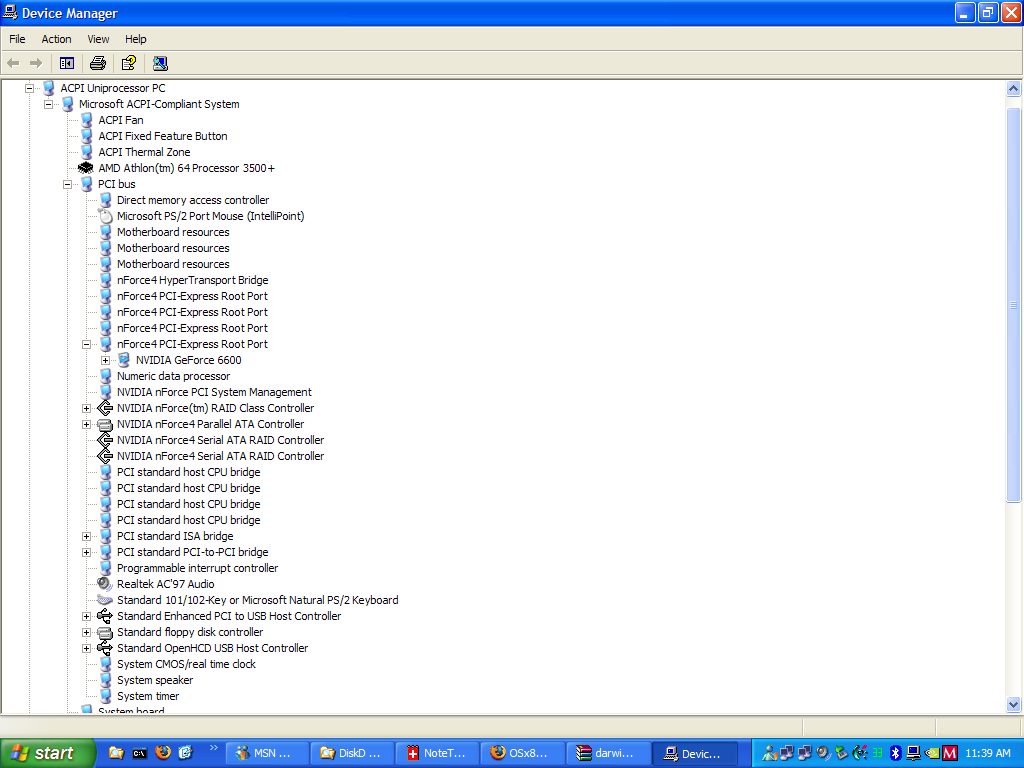

Roland77 Posted October 3, 2005 Share Posted October 3, 2005 I'm confused... I already have the NVidia.kext running, in system profiler my card is detected correctly; 6600GT pci-e BUT It still shows the bus: PCI Now I understand I have to use the AppleI386 kext from the other topic, I know I have to edit the Info.plist inthere, np with all that. I just dont know what Vendor / Device ID to add in there .... I have a nForce4 SLI motherboard from Asus, so there is no PCI-AGP bridge in there. If I understand correctly, I will need to edit it, but which device do I take if I have pci-e and no AGP ?? And if I finally get the right ID, will it show as 6600GT on AGP, even if its on PCI-express ?? help me out here, I'm kinda lost Link to comment Share on other sites More sharing options...
macgirl Posted October 3, 2005 Share Posted October 3, 2005 I'm confused... I already have the NVidia.kext running, in system profiler my card is detected correctly; 6600GT pci-e BUT It still shows the bus: PCI Now I understand I have to use the AppleI386 kext from the other topic, I know I have to edit the Info.plist inthere, np with all that. I just dont know what Vendor / Device ID to add in there .... I have a nForce4 SLI motherboard from Asus, so there is no PCI-AGP bridge in there. If I understand correctly, I will need to edit it, but which device do I take if I have pci-e and no AGP ?? And if I finally get the right ID, will it show as 6600GT on AGP, even if its on PCI-express ?? help me out here, I'm kinda lost Even if you edit the AppleI386 kext it wont show AGP or PCI-E, because at the moment there is no PCI-E cards "supported" by Mac OS X, even the Intel GMA 900 is recognized as PCI. If you read my post http://forum.osx86project.org/index.php?sh...indpost&p=18543 it says the kext can be loaded but no difference in the System Profiler. If you want to add the Device ID of your PCI-E slot look at Windows for PCI2PCI bridge. My Motheboard has 4 PCI-E slots, one of them for the VideoCard Here is a pic of Device Manager in Windows, I select View Devices by connection: Link to comment Share on other sites More sharing options...
