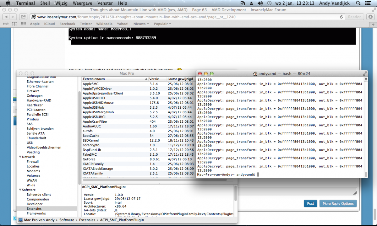

Andy Vandijck Posted January 2, 2013 Share Posted January 2, 2013 It's built and tested... Source is included... This kext will work always on AMD... replacement for Dont steal Mac OS X.kext (move somewhere after install AppleDecrypt.kext) Enjoy Again thx to Sinetek for the decryption algo's Watch closely in the screen cap... (no Dont steal Mac OS X lol) I've made kexts for Lion and ML AppleDecrypt-Sinetek-AnV.zip 1 Link to comment https://www.insanelymac.com/forum/topic/281450-mavericks-kernel-testing-on-amd-formerly-mountain-lion-kernel-testing-on-amd/page/49/#findComment-1877353 Share on other sites More sharing options...

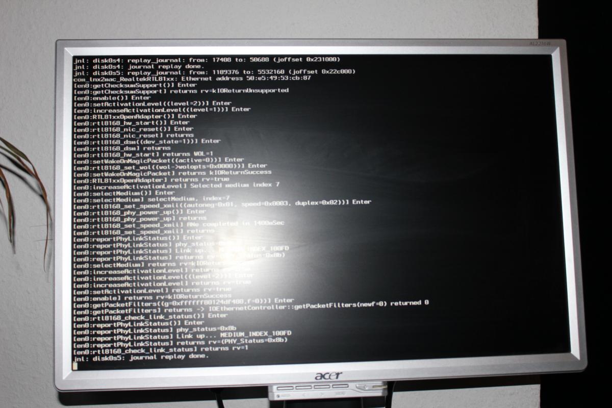

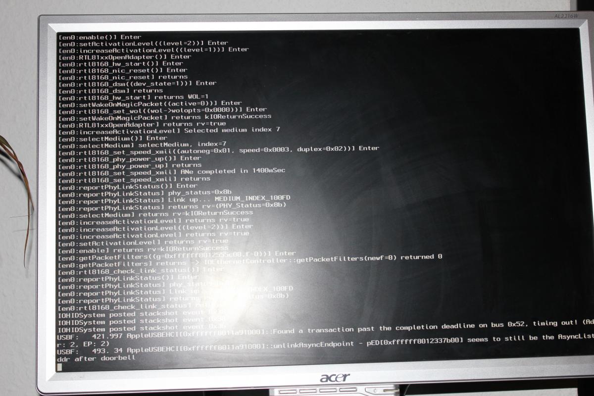

spakk Posted January 2, 2013 Share Posted January 2, 2013 Hello people! The kernel of Sinetek/Andy must be compatible with Phenom II X6. It can only be due to the graphics card, which is why my system will not boot. Yesterday I installed successfully Snow Leopard with the chipset / graphics drivers with Efi string. Then I booted the system with flag: arch = x86_64-v sinetek Than the booting stops at this line: ACPI_SMC_PlatformPlugin: start-wait For Service (resource matching (AppleIntelCPUPowerManagme t) timed out Then I booted in safe mode and removed the AppleSMC.kext, Extensions.mkext from S / L / E and the caches. Then again, booting the system with the same boot flags, the system boots up completely, at the end just before the graph is released, clutter for a moment just a short video, then broke down the system and has rebooted. my guess is that I have problems with the Nvidia GTX550 TI graphics driver. Who can help me with the graphics card problem? that is the reason why I can not get boots Mountain Lion But now I will test the new kernel by Andy and give later my report, here smbios_chamleon boote plist.rar Link to comment https://www.insanelymac.com/forum/topic/281450-mavericks-kernel-testing-on-amd-formerly-mountain-lion-kernel-testing-on-amd/page/49/#findComment-1877410 Share on other sites More sharing options...

spakk Posted January 2, 2013 Share Posted January 2, 2013 (edited) here my test with Phenom II X6 1100T - GA990FXA-UD3 with Mountain Lion 10.8.2 SinetekBronzovkAnVoodoo_test2.diff installed in root AppleDecrypt-Sinetek-AnV installed in S/L/E amd_kernel installed in root boot flag : amd_kernel -v no Kernel Panic, Keyboard is working but its hangs on: PS: when I look at the picture, then I should take the cleaning cloth and make my monitor clean, then the images are better Edited January 2, 2013 by spakk Link to comment https://www.insanelymac.com/forum/topic/281450-mavericks-kernel-testing-on-amd-formerly-mountain-lion-kernel-testing-on-amd/page/49/#findComment-1877422 Share on other sites More sharing options...

spakk Posted January 2, 2013 Share Posted January 2, 2013 Here it is, Andy:dsdt unpatched.zip theconnatic what the is ---> dsdt unpatched.zip ???? Try with extra boot argument -nossse3bit boot with the boot flag: amd_kernel -nossse3bit -v brought no success! no kernel panic, keyboard is working but its hangs on: Link to comment https://www.insanelymac.com/forum/topic/281450-mavericks-kernel-testing-on-amd-formerly-mountain-lion-kernel-testing-on-amd/page/49/#findComment-1877431 Share on other sites More sharing options...
