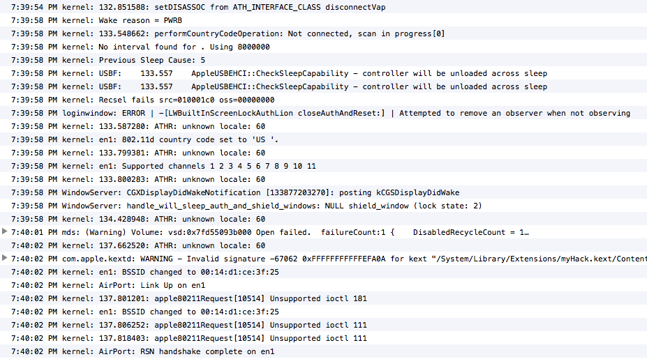

ltooz_audis Posted April 7, 2014 Share Posted April 7, 2014 Hello all, I have a really weird problem with Mavericks 10.9.x and AR5B195 mini-module AR9285 Wifi & AR3011 bluetooth, at boot up, the wifi and bluetooth are on but not active because it can't set to CountryCode US, it can't see any SSIDs at all. Now, when I put it to sleep and wake it up, everything works perfectly, US is set, bluetooth and wifi are active and connected extremely well. It doesn't matter what Chameleon version I use, right now I'm at r2377. I tried clover and it doesn't have a problem connecting at boot up but it has problem of "still waiting for root device" since my HP Envy4-1117nr has 32GB SSD raid with the hard drive. Most of the problems I read about wifi with Mavericks are waking up, not boot up, mine is boot up and work perfectly after wakes up. I had it worked once when I was debugging the installation, but now, it's totally back to failing at boot-up and working after sleep/wake. If someone has any idea on how to fix this please let me know. It's a little frustrating to have to boot-up, put it to sleep (wait a little long for Mavericks ~30 sec), wakes it up and use wifi and bluetooth. Thanks so much, Louis Link to comment Share on other sites More sharing options...

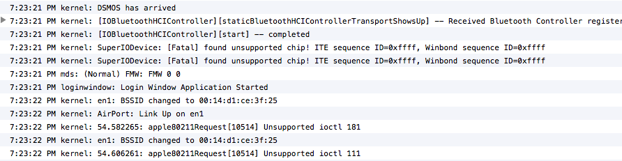

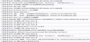

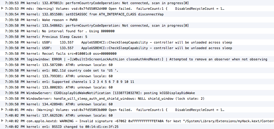

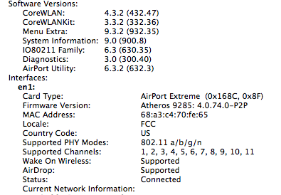

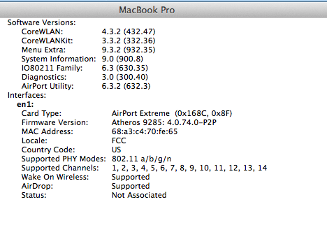

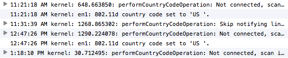

ltooz_audis Posted April 7, 2014 Share Posted April 7, 2014 After sleep/wake 11:21: and 12:47 "US" Boot up after iRepair @1:18:10PM. Hello iFire, Thanks for the file, I ran it and it didn't help. I did try editing dsdt and it didn't help either. This is an amazing problem. The bios sees the card. I wonder how clover bootloader turns on the wifi - I can see it sets channel to 1-11 in verbos mode. What's difference between booting up and waking up from sleep? initialization? Link to comment Share on other sites More sharing options...

ltooz_audis Posted April 8, 2014 Share Posted April 8, 2014 I tried to unload the kext, but it's already loaded, couldn't unload. It doesn't work only at boot up - after sleeps and wakes, it works every time. I think somehow, the boot loader fails to initialize the country code at boot, but from sleep to wake, it initialized and apply "US" code. The way clover boots, it works at boot up without "US" country code. Thanks for your input, Louis Link to comment Share on other sites More sharing options...

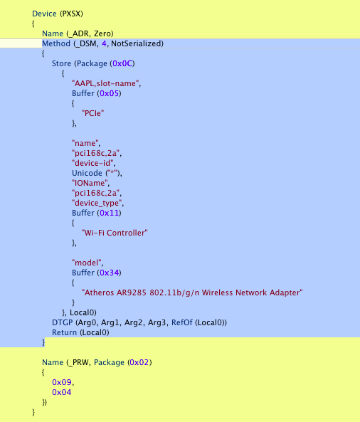

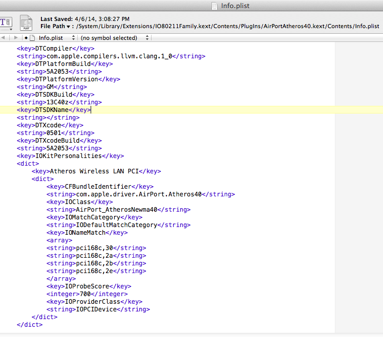

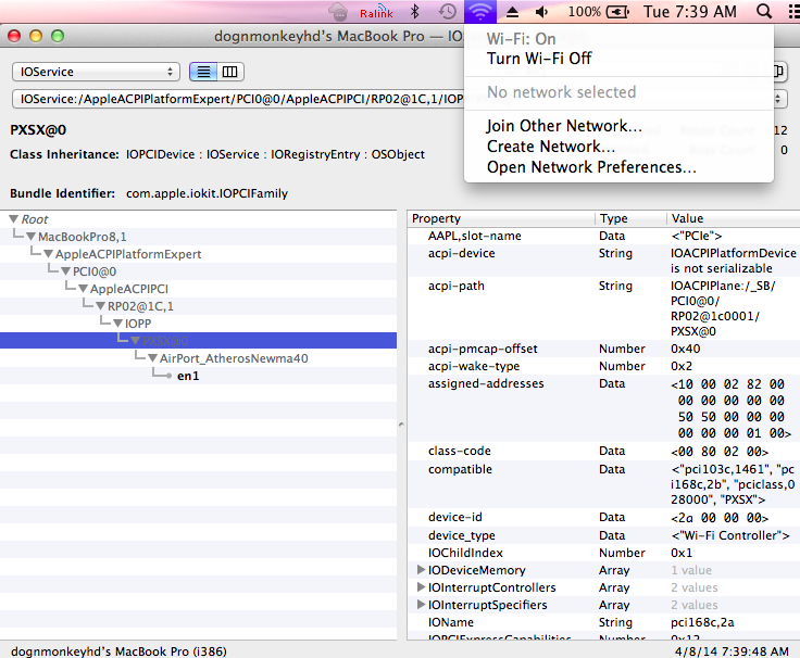

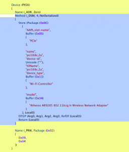

iFIRE Posted April 8, 2014 Share Posted April 8, 2014 here a DSDT patch for this card Method (_DSM, 4, NotSerialized){Store (Package (0x0C){ "AAPL,slot-name", Buffer (0x05) { "PCIe" }, "name", "pci168c,2a", "device-id", Unicode ("*"), "IOName", "pci168c,2a", "device_type", Buffer (0x11) { "Wi-Fi Controller" }, "model", Buffer (0x34) { "Atheros AR9285 802.11b/g/n Wireless Network Adapter" } }, Local0) DTGP (Arg0, Arg1, Arg2, Arg3, RefOf (Local0)) Return (Local0)} and here to patch device id of your card in the kext System/Library/Extensions/IO80211Family.kext/Contents/Plugins/AirPortAtheros40.kext/Contents/Info.plist <key>IONameMatch</key><array><string>pci168c,30</string><string>pci168c,2a</string><string>pci168c,2b</string><string>pci168c,2e</string><string>pci106b,0086</string><string>pci168c,1c</string><string>pci168c,23</string> Link to comment Share on other sites More sharing options...
ltooz_audis Posted April 8, 2014 Share Posted April 8, 2014 Hello iFire, Did all and still nothing changes... Thanks again, Louis Link to comment Share on other sites More sharing options...

Onixs Posted April 8, 2014 Share Posted April 8, 2014 Where do I add that? What's the correct codes and format please? Thanks, Louis Method (_DSM, 4, NotSerialized) { Store (Package (0x0C) { "AAPL,slot-name", Buffer (0x05) { "PCIe" }, "name", "pci168c,2a", "device-id", Unicode ("*"), "IOName", "pci168c,2a", "device_type", Buffer (0x11) { "Wi-Fi Controller" }, "model", Buffer (0x34) { "Atheros AR9285 802.11b/g/n Wireless Network Adapter" } "IO80211Locale", Buffer (0x04) { "FCC" }, "IO80211CountryCode", Buffer (0x03) { "US" } }, Local0) DTGP (Arg0, Arg1, Arg2, Arg3, RefOf (Local0)) Return (Local0) } Link to comment Share on other sites More sharing options...

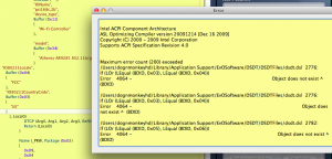

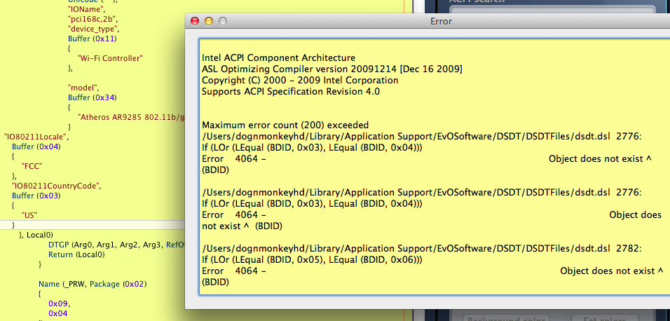

ltooz_audis Posted April 8, 2014 Share Posted April 8, 2014 Add and get error compilation. Thanks, Louis PS: I think the problem is NOT that the kext is NOT working, it's working, but not at BOOT-UP. I checked with clover boot loader today on the external USB, and it assigned "US" without any problem from the first boot up, but it doesn't boot from hard drive "Still Waiting For Root Device". The initialization between Chameleon and Clover is different somehow. How do we put a script for it to simulate sleep/wake at boot up? Link to comment Share on other sites More sharing options...
Onixs Posted April 9, 2014 Share Posted April 9, 2014 Add and get error compilation. dsdterror.png Thanks, Louis PS: I think the problem is NOT that the kext is NOT working, it's working, but not at BOOT-UP. I checked with clover boot loader today on the external USB, and it assigned "US" without any problem from the first boot up, but it doesn't boot from hard drive "Still Waiting For Root Device". The initialization between Chameleon and Clover is different somehow. How do we put a script for it to simulate sleep/wake at boot up? Edit /System/Library/Extensions/IO80211Family.kext/Contents/PlugIns/AirPortAtheros40.kext/Contents/Info.plist and remove these line. <key>OSBundleRequired</key> <string>Network-Root</string> Fix file permissions and reboot. Dont forget to backup the original first. Link to comment Share on other sites More sharing options...
ltooz_audis Posted April 9, 2014 Share Posted April 9, 2014 Hello Rals2007, 1. Removed the lines in info didn't work. 2. loaded the kext, removed the add in ssdt, the locale = FCC and CountryCode=US but it still didn't work at boot-up. Not connected 14 channels Connected 11 channels I think even we force the driver to US and FCC, but the initialization of the kernel fails to connect somehow. Can it be the Lapic patching of Chameleon? I'll try to use cpus=1 and remove the patch. Thanks again, Louis Link to comment Share on other sites More sharing options...

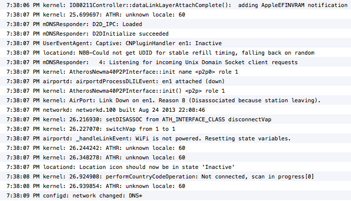

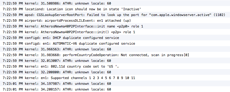

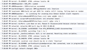

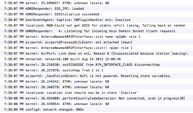

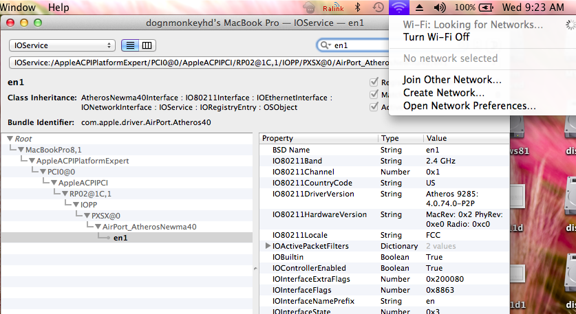

ltooz_audis Posted April 10, 2014 Share Posted April 10, 2014 Thanks Rals2007 but sorry, it didn't help. I did the comparison between the clover boot and chameleon boot is this. Clover boot that works from boot-up - "airportd" is EN1 UP Chameleon boot that doesn't work from boot - up - something about NOT powered "airportd" is EN1 DOWN Chameleon somehow boot the wifi and doesn't see the atheros WIFI NOT powered up? After wake up (chameleon) I don't know much about how the boot loaders boot, but there are differences on the process numbers for clover and chameleon Thanks, Louis Link to comment Share on other sites More sharing options...
