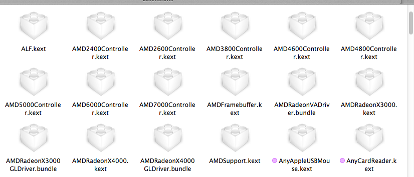

I Recently installed my mavericks following the guide above, everything went fine, but after the install, when i try to boot into the Mavericks HD, the system stucks:
My Gear:
I7 920 - 4gb Ram - GTX 680 - Asus P6TD Deluxe - Mavericks is installed in a guid partition, in a hd with a NTFS partition, but not the one windows is installed.
I did try:  -x -f USBBusFix=Yes GraphicsEnabler=No
Everytime the system says:
usbmsc identifier non-unique
Still waiting for root device
Here some pics:
Everything ok in bios, and i always boot with GraphicsEnabler=No
I Really don't know what's going on.
Are you trying to boot from the hard drive? Or from the USB key?
The "Waiting for root device" error would indicate that the installer cannot see the root partition.
If you're using the USB key to boot the system, try to move the USB key to a different USB port. Especially if you have USB 3.0, move it from a 3.0 port to a 2.0 port and see if that makes a difference. Also, have you done the post install steps of adding FakeSMC and NullCPUPowerManagement kexts? I believe that not having these kexts would result in a kernel panic as opposed to what you're seeing, but it's worth asking the question.
Using this guide, as soon as the build is complete, you still don't have a bootable OS yet, you have to continue with the procedure and follow the immediate steps that take you back to the Mavericks installer USB.
