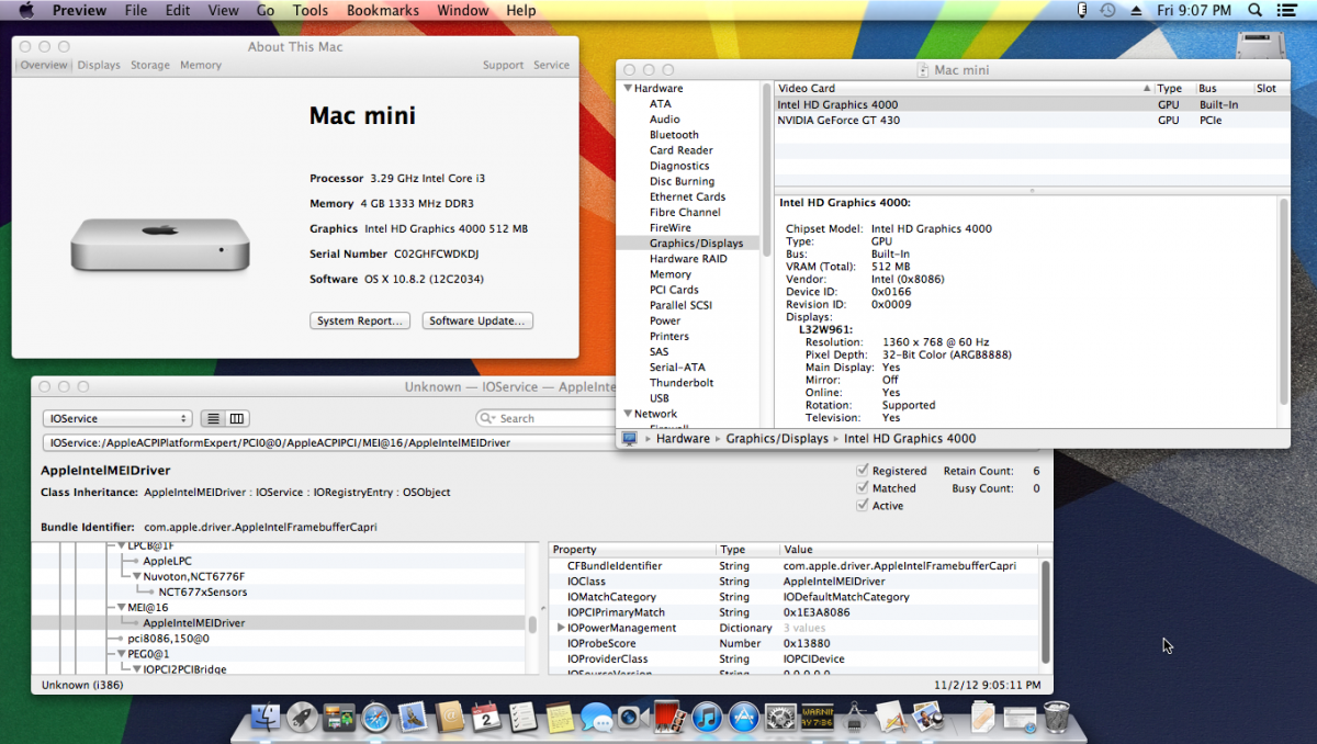

THEHAWKs Posted November 3, 2012 Share Posted November 3, 2012 ZOTAC Z68-ITX WiFi Supreme + Intel Core i3 3225 HDMI = ok DVI to HDMI = ok The Tv i have it hooked up to looks bad Link to comment https://www.insanelymac.com/forum/topic/280372-hd4000-full-acceleration-for-108-1075/page/5/#findComment-1864693 Share on other sites More sharing options...

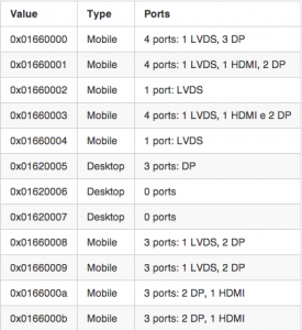

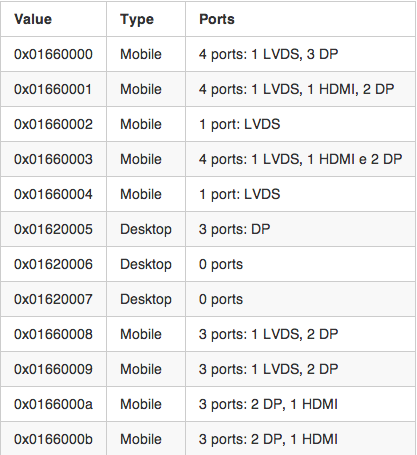

Allan Posted December 18, 2013 Share Posted December 18, 2013 how to find out my ig-platform-id correct? I use this patch in my DSDT. Method (_DSM, 4, NotSerialized) { Store (Package (0x0E) { "device-id", Buffer (0x04) { 0x66, 0x01, 0x00, 0x00 }, "vendor-id", Buffer (0x04) { 0x86, 0x80, 0x00, 0x00 }, "AAPL,snb-platform-id", Buffer (0x04) { 0x00, 0x00, 0x01, 0x00 }, "AAPL,ig-platform-id", Buffer (0x04) { 0x03, 0x00, 0x66, 0x01 }, "hda-gfx", Buffer (0x0A) { "onboard-2" }, "layout-id", Buffer (0x04) { 0x0C, 0x00, 0x00, 0x00 }, "AAPL00,DualLink", Buffer (0x04) { 0x01, 0x00, 0x00, 0x00 } }, Local0) DTGP (Arg0, Arg1, Arg2, Arg3, RefOf (Local0)) Return (Local0) These are the existing values. I understand that my LDVS would be embedded LCD. but what is DP? my notebook has 1 HDMI, 1 VGA and 1 LDVs. what value should I use? and according to this tutorial AppleIntelSNBGraphicsFB.kext not charge. Link to comment https://www.insanelymac.com/forum/topic/280372-hd4000-full-acceleration-for-108-1075/page/5/#findComment-1976950 Share on other sites More sharing options...
