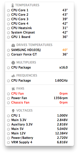

Goron Posted April 8, 2012 Share Posted April 8, 2012 Thanks kozlek! Total reinstall brought some light Now, there only two states: lowest x16 und highest x33! In Bios it´s set to max. multiplier x42 in turbo mode ??? How are the states generated, or are they static values depending on CPU model? Thanks for clearing up! Link to comment https://www.insanelymac.com/forum/topic/275429-hwsensors/page/13/#findComment-1812049 Share on other sites More sharing options...

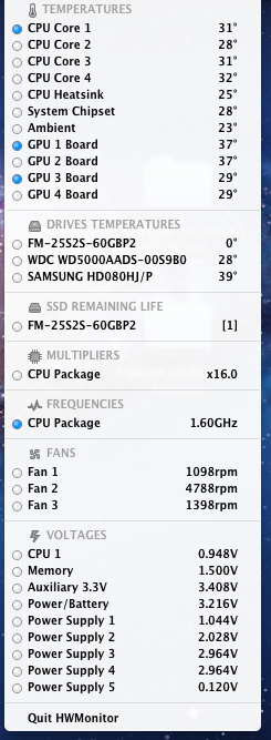

deckert Posted April 9, 2012 Share Posted April 9, 2012 Hi, finally have fans and voltages showing in the latest release Now I am trying to rename them and work out the gain for them in the SuperIOSensors.kext Info.plist Here is the information displayed in the bios: I have started making a new profile for my motherboard in the Nuvotron NCT677X Monitor section above the ASUS motherboards (as it appears all the profiles have been entered in alphabetical order): <key>ASRock</key> <dict> <key>Z68 Pro3-M</key> <dict> <key>FANIN0</key> <string>CPU Fan</string> <key>FANIN1</key> <string>Chassis Fan #1</string> <key>FANIN2</key> <string>Chassis Fan #2</string> <key>FANIN3</key> <string>Power Fan</string> <key>FANIN4</key> <string></string> </dict> </dict> Do I need to add all the keys that are in the other profiles? Or can I build it up as I work out which fan/temp/voltage is which? Also, I have not been able to work out which voltages are the 5v and 12v from the dumps I got from AIDA64 and OpenHarwareMonitor. The following is from the OpenHardwareMonitor dump +- ASRock Z68 Pro3-M (/mainboard) | | | +- Nuvoton NCT6776F (/lpc/nct6776f) | | +- CPU VCore : 0.944 0.944 1.192 (/lpc/nct6776f/voltage/0) | | +- Voltage #2 : 1.864 1.856 1.872 (/lpc/nct6776f/voltage/1) | | +- AVCC : 3.376 3.36 3.376 (/lpc/nct6776f/voltage/2) | | +- 3VCC : 3.36 3.344 3.376 (/lpc/nct6776f/voltage/3) | | +- Voltage #5 : 0.152 0.104 0.248 (/lpc/nct6776f/voltage/4) | | +- Voltage #6 : 1.696 1.696 1.696 (/lpc/nct6776f/voltage/5) | | +- Voltage #7 : 0.864 0.856 0.864 (/lpc/nct6776f/voltage/6) | | +- 3VSB : 3.472 3.472 3.472 (/lpc/nct6776f/voltage/7) How can I find out what each of the unnamed voltages are? Link to comment https://www.insanelymac.com/forum/topic/275429-hwsensors/page/13/#findComment-1812350 Share on other sites More sharing options...

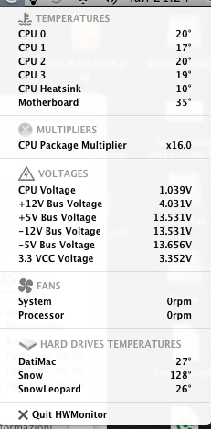

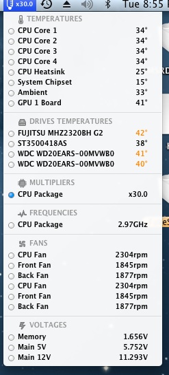

magnifico Posted April 9, 2012 Share Posted April 9, 2012 hi friend , why there is error in voltage? I use Fake smc 4.0 and plug in intelthermal.kext and NuvotonNCT677x.kext Lol Voltage is very strange in +12 +5 -12 -5 where it is error? Link to comment https://www.insanelymac.com/forum/topic/275429-hwsensors/page/13/#findComment-1812426 Share on other sites More sharing options...

kozlek Posted April 10, 2012 Author Share Posted April 10, 2012 Hi, finally have fans and voltages showing in the latest release Now I am trying to rename them and work out the gain for them in the SuperIOSensors.kext Info.plist Here is the information displayed in the bios: I have started making a new profile for my motherboard in the Nuvotron NCT677X Monitor section above the ASUS motherboards (as it appears all the profiles have been entered in alphabetical order): <key>ASRock</key> <dict> <key>Z68 Pro3-M</key> <dict> <key>FANIN0</key> <string>CPU Fan</string> <key>FANIN1</key> <string>Chassis Fan #1</string> <key>FANIN2</key> <string>Chassis Fan #2</string> <key>FANIN3</key> <string>Power Fan</string> <key>FANIN4</key> <string></string> </dict> </dict> Do I need to add all the keys that are in the other profiles? Or can I build it up as I work out which fan/temp/voltage is which? Also, I have not been able to work out which voltages are the 5v and 12v from the dumps I got from AIDA64 and OpenHarwareMonitor. The following is from the OpenHardwareMonitor dump +- ASRock Z68 Pro3-M (/mainboard) | | | +- Nuvoton NCT6776F (/lpc/nct6776f) | | +- CPU VCore : 0.944 0.944 1.192 (/lpc/nct6776f/voltage/0) | | +- Voltage #2 : 1.864 1.856 1.872 (/lpc/nct6776f/voltage/1) | | +- AVCC : 3.376 3.36 3.376 (/lpc/nct6776f/voltage/2) | | +- 3VCC : 3.36 3.344 3.376 (/lpc/nct6776f/voltage/3) | | +- Voltage #5 : 0.152 0.104 0.248 (/lpc/nct6776f/voltage/4) | | +- Voltage #6 : 1.696 1.696 1.696 (/lpc/nct6776f/voltage/5) | | +- Voltage #7 : 0.864 0.856 0.864 (/lpc/nct6776f/voltage/6) | | +- 3VSB : 3.472 3.472 3.472 (/lpc/nct6776f/voltage/7) How can I find out what each of the unnamed voltages are? Good question. We could make a tests, see post #264 kozlek, there are a problem with the last version i lost all the sensors please can you check it thanks As usual I need kernel.log and IOReg dump. Please, provide them. OK I've checked with NVClock Linux port and this is what I got: -- General info -- Card: G92 [GeForce 8800 GS] Architecture: G92 A2 PCI id: 0x0606 Subvendor id: 0x0000 GPU clock: 576.000 MHz Bustype: PCI-Express -- Shader info -- Clock: 1458.000 MHz Stream units: 96 (11110011b) ROP units: 12 (1110b) -- Memory info -- Amount: 384 MB Type: 192 bit DDR3 Clock: 848.568 MHz -- PCI-Express info -- Current Rate: 16X Maximum rate: 16X -- Sensor info -- Sensor: NV50 GPU Internal Sensor (correction=32) GPU temperature: 48C -- VideoBios information -- Version: 62.92.1f.00.09 Signon message: GeForce 8800 GS VGA BIOS Performance level 0: gpu 575MHz/shader 1438MHz/memory 850MHz/0.00V/100% VID mask: 3 Voltage level 0: 0.95V, VID: 0 Voltage level 1: 1.00V, VID: 1 Voltage level 2: 1.05V, VID: 2 Voltage level 3: 1.10V, VID: 3 So my card (Architecture: G92 A2 PCI id: 0x0606) should use nv50 (not g84, not g92) get_temp function to get proper TEMP value I've found that in info.cpp of nvclockx case 0x600: /* G92 */ case 0x610: /* G92 */ arch = G84; //NV50; so adding my device id (0x0606) and arch = nv50 should fix my problem??? can you kozlek make a small change in the code of nvclockx thanks for help , great tool Just added.. Please, give feedback hi friend , why there is error in voltage? I use Fake smc 4.0 and plug in intelthermal.kext and NuvotonNCT677x.kext Lol Voltage is very strange in +12 +5 -12 -5 where it is error? Sorry, I don't support slice's branch I have Nuvoton NCT6775F which is partially working with this. Anything I can do to help bring full support? See this post. 09.04.12 12:29:07,000 kernel: NVClockX: [Warning] it seems your card isn't officialy supported yet 09.04.12 12:29:07,000 kernel: NVClockX: [Warning] please tell the author the pci_id of the card for further investigation 09.04.12 12:29:07,000 kernel: NVClockX: [Warning] continuing anyway 09.04.12 12:29:07,000 kernel: NVClockX: Adding temperature sensors Geräte-ID: 0x1201 Added! Link to comment https://www.insanelymac.com/forum/topic/275429-hwsensors/page/13/#findComment-1812619 Share on other sites More sharing options...

deckert Posted April 11, 2012 Share Posted April 11, 2012 OK, I got some more information from another Windows app (HWinfo32) that corresponds to the information I got from OpenHardwareMonitor OpenHardwareMonitor HWinfo32 CPU VCore : 0.944 0.944 1.192 (/lpc/nct6776f/voltage/0) Vcore 0.952 V Voltage #2 : 1.864 1.856 1.872 (/lpc/nct6776f/voltage/1) +12V 12.355 V AVCC : 3.376 3.36 3.376 (/lpc/nct6776f/voltage/2) AVCC 3.376 V 3VCC : 3.36 3.344 3.376 (/lpc/nct6776f/voltage/3) +3.3V 3.360 V Voltage #5 : 0.152 0.104 0.248 (/lpc/nct6776f/voltage/4) VIN4 0.160 V Voltage #6 : 1.696 1.696 1.696 (/lpc/nct6776f/voltage/5) +5V 5.112 V Voltage #7 : 0.864 0.856 0.864 (/lpc/nct6776f/voltage/6) VIN6 0.992 V 3VSB : 3.472 3.472 3.472 (/lpc/nct6776f/voltage/7) 3VSB 3.472 V So this would mean that 12V will be VIN1 in the Info.plist profile and 5V will be VIN5 correct? These equate to Power Supply 2 and Power Supply 6 in HWMonitor.app right? From my BIOS screenshot I get values of 1.184V, 12.302V, 5.088V and 3.360V for VCore, +12V, +5V and +3.3V So to get the gain for +12V I have Vref=12.302, Vraw=1.864 Gain = (Vref - Vraw) / Vraw = (12.302 - 1.864) / 1.864 = 10.438 / 1.864 = 5.59978540772532 Therefore in the SuperIOSensors.kext Info.plist I would need to enter the following correct? <key>VIN1</key> <dict> <key>gain</key> <integer>5599</integer> <key>name</key> <string>Main 12V</string> <key>offset</key> <integer>0</integer> <key>reference</key> <integer>0</integer> </dict> Link to comment https://www.insanelymac.com/forum/topic/275429-hwsensors/page/13/#findComment-1812807 Share on other sites More sharing options...

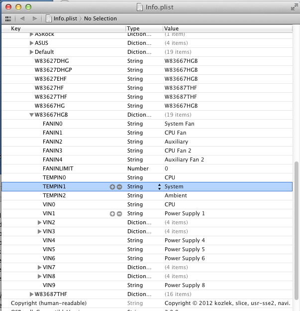

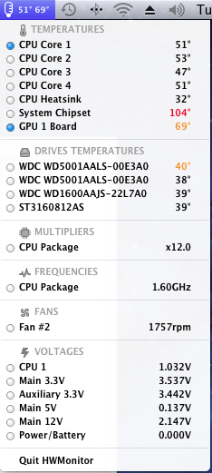

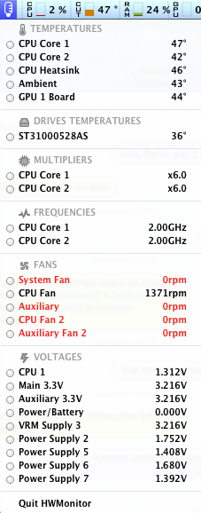

camon Posted April 11, 2012 Share Posted April 11, 2012 ok after reading this post, i get that i need to change Info.plist in SuperIOSensors. The thing that i don't get is the relation between the output of HWMonitor and the labels in Info.plist. I mean the output looks like this: But in Info.plist, i don't have an entry named Main 3.3v, neither Auxiliary 3.3v. I just don't get where this names came from :S and what do i need to change after all. Please Kozlek some help here Link to comment https://www.insanelymac.com/forum/topic/275429-hwsensors/page/13/#findComment-1812895 Share on other sites More sharing options...
Carstiman Posted April 12, 2012 Share Posted April 12, 2012 Hello, thx for your nice work !!! kozlek-HWSensors-3b903ff Asus P5K Pro (SuperIO: found Winbond W83627DHG on port=0x2e address=0x290)again HW Monitor shows Ambient, should be System. Ambient Sensor is missing. with the older W836x.kext i could change inside the info.plist TEMPIN0FORCED to Yes and System Sensor was shown right. i never got both sensors at the same time (System/Ambient) inside a monitor app. Voltage 5 V, 12 V still missing or wrong. tell me please if you need more info´s. Just a question, is it a big deal to insert GPU Fan inside NVclock ? Asus P5k Pro hwm_smbus.txt Asus P5k Pro HWMonitor.txt Link to comment https://www.insanelymac.com/forum/topic/275429-hwsensors/page/13/#findComment-1813026 Share on other sites More sharing options...
camon Posted April 12, 2012 Share Posted April 12, 2012 @Carstiman i have a p5kc. I think that p5k pro and p5kc are almost identical so as you can see in my previous post i also have the same output as you in hwmonitor. The thing that i concluded by reading previous posts is that these are raw values read from the Winbond. We need to use "gain" for getting the +12v and +5v. I think that in mine +12v is Power Supply 2. Yours should be the same. But as i mentioned in the previous post i can't figure out where i'm supposed to change the values in Info.plist, because i can't find the names that HWMonitor shows in the Info.plist :S Link to comment https://www.insanelymac.com/forum/topic/275429-hwsensors/page/13/#findComment-1813031 Share on other sites More sharing options...
Carstiman Posted April 12, 2012 Share Posted April 12, 2012 @camon change this inside the info.plist of SuperIOSensors.kext and System Chipset is shown right with HW Monitor. the Ambient Sensor is missing but i know that i´ve got one real shown in an older version. here ist my smcutil output Asus P5k Pro SMC_util2 output.txt Link to comment https://www.insanelymac.com/forum/topic/275429-hwsensors/page/13/#findComment-1813049 Share on other sites More sharing options...
