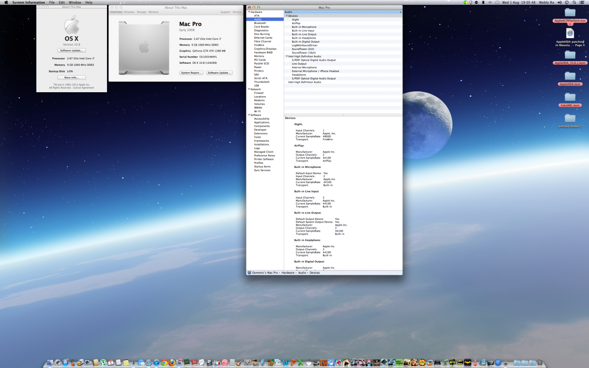

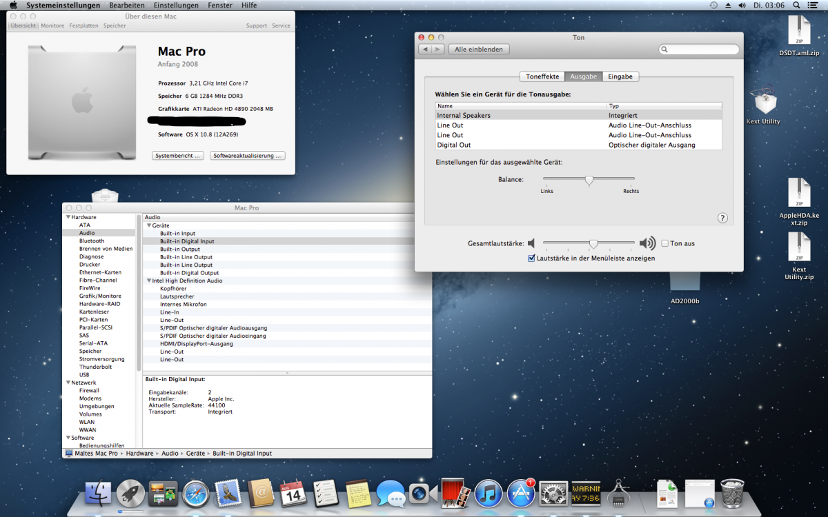

maltba Posted August 14, 2012 Share Posted August 14, 2012 Hey guys, Just wanted to share the outcomes of my work with you. got my rampage 2 extreme fully working !with! Audio. Instructions: 1.Use the MLionize Script to make your boot medium. 2.Install(maybe you will need GraphicsEnabler=No) 3.don't run the finalize thing 4.start again with the usb stick 5.install chameleon: Chameleon-2.1svn-r2042.pkg.zip **maybe you don't need this step** 6.make a new folder called Extra on the root of your installation hard drive ******************************************* 7.copy this into it:DSDT.aml.zip 8.generate a smbios.plist place it in /Extra too(or just use the one from the usb stick) 9.generate a com.chameleon.boot.plist place it in /Extra too(or just use the one form the usb stick) (Chameleon Wizard is a good tool for 8. & 9.) For Audio -Download this:Kext Utility.zip and this: ***wrong one look at the bottom****AD2000b-ML-10.8-AppleHDA.kext patch credits to ErmaC here post #70**** -Extract both and just drop the AppleHDA.kext at the Kext Utility App make you you've installed the correct DSDT(the one from 7.) -reboot and enjoy proof: everything seems to work now. though i don't tested sleep yet. I'll report back when i've tested it. sleep works well. maltba edit:// who the {censored} changed the AD2000B kext? THIS IS THE WRONG ONE! this kext is missing the Info.plist at AppleHDA.kext/Contents/PlugIns/AppleHDAHardwareConfigDriver.kext/Contents/Info.plist! if you don't believe me check it yourself. i've fixed that problem. thats why its working for me -.- here is the CORRECT File: http://freakshare.com/files/85z2yc39/AppleHDA.kext.zip.html CREDITS GO to ErmaC! but i've fixed the kext he provided here: patch credits to ErmaC here post #70 1 Link to comment https://www.insanelymac.com/forum/topic/267001-guide-lion-107-on-asus-x58-lga-1366-i7-9xx/page/28/#findComment-1843843 Share on other sites More sharing options...

artix123 Posted August 17, 2012 Share Posted August 17, 2012 Hey maltba, I'm on R2E motherboard too. Just wondering how did you boot your ML without running finalize, after installation? My installation just doesn't boot if I don't run finalize, and if I do, my audio will be broken (even when I try to install your AppleHDA.kext over the old one). Also having problems with dual-booting - Chameleon just doesn't boot even after I installed it. Might have something to do with my Mountain Lion partition being the 5th one.. Link to comment https://www.insanelymac.com/forum/topic/267001-guide-lion-107-on-asus-x58-lga-1366-i7-9xx/page/28/#findComment-1844958 Share on other sites More sharing options...
maltba Posted August 17, 2012 Share Posted August 17, 2012 i've just took the installation stick and booted up the Mountain Lion Partition with it.I think your problem is dual booting related. are you on a mbr drive? if not try to unconnected all other drives beside the mac os x drive and then try booting up with the installation usb stick(just choose the Mountain Lion Partition when Chameleon appears) and if it boots then try reinstalling chameleon. also make sure you select the correct drive in bios boot orders. for qe/ci - if its not working oob - check this here: QE_CI Exotic patch Mountain Lion GM.zip just drag both kext files into the kext utility app. i have a radeon 4890. to get the garbled gui at first i had to boot with GraphicsEnabler=No. for the audio. make sure you install the kext with the Kext Utility app i've provided. Also make sure you've installed the DSDT.aml i've provided.Furthermore make sure you don't use that one they've inserted into my post. download this one: http://freakshare.com/files/85z2yc39/AppleHDA.kext.zip.html and install it with the Kext Utility App if you can't follow my instructions just say it.if you want i can make a video for you,but i'm on vacation for a week first.also i could help you with team viewer or vnc if you want to.you write a pm and i'll gladly help you in a week. hope this crappy english helps you. maltba Link to comment https://www.insanelymac.com/forum/topic/267001-guide-lion-107-on-asus-x58-lga-1366-i7-9xx/page/28/#findComment-1845066 Share on other sites More sharing options...
