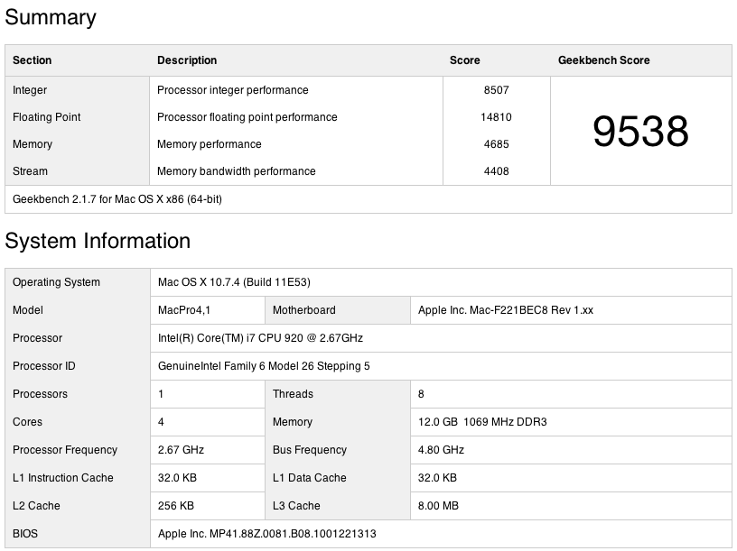

pixelcrook Posted July 20, 2012 Share Posted July 20, 2012 Got it to work now. It was wrong file previlegies since i changed the ACPI file on installation usb. Worked with v1.5 now when I set the right privs. Now I get terrible geekbenchscore :/ (9538) Must have something to do with speedstep not working. Like the cpu is stuck at 2,67 Ghz... Best way to test if speedstep is working? Ive tried to find informations on how to install FakeSMC+Monitor for my hardware but found nothing on that.. Link to comment https://www.insanelymac.com/forum/topic/267001-guide-lion-107-on-asus-x58-lga-1366-i7-9xx/page/27/#findComment-1835539 Share on other sites More sharing options...
eep357 Posted July 20, 2012 Share Posted July 20, 2012 Got it to work now. It was wrong file previlegies since i changed the ACPI file on installation usb. Worked with v1.5 now when I set the right privs. Now I get terrible geekbenchscore :/ (9538) Must have something to do with speedstep not working. Like the cpu is stuck at 2,67 Ghz... Best way to test if speedstep is working? Ive tried to find informations on how to install FakeSMC+Monitor for my hardware but found nothing on that.. 1.5 seems hit or miss for me, on occasion it will still hang up, never a problem with 1.3.5. For smbios, MacPro 4,1 or 5,1 should both work fine, I use 5,1 because it's newer For speedstep, must remove nullapplecpupowermanagement.kext if installed, with ssdt tables in DSDT no other settings needed (i.e. enable P&C states in chameleon) Your ram looks like it may be underclocked quite a bit there in that geekbench, guessing you probably have 1600mhz capable ram? Link to comment https://www.insanelymac.com/forum/topic/267001-guide-lion-107-on-asus-x58-lga-1366-i7-9xx/page/27/#findComment-1835560 Share on other sites More sharing options...
pixelcrook Posted July 20, 2012 Share Posted July 20, 2012 1.5 seems hit or miss for me, on occasion it will still hang up, never a problem with 1.3.5. For smbios, MacPro 4,1 or 5,1 should both work fine, I use 5,1 because it's newer For speedstep, must remove nullapplecpupowermanagement.kext if installed, with ssdt tables in DSDT no other settings needed (i.e. enable P&C states in chameleon) Your ram looks like it may be underclocked quite a bit there in that geekbench, guessing you probably have 1600mhz capable ram? I use 4,1 since i red it was recommended for my setup (maybe i red it in lionize) Do i just remove nullapplecpupowermanagement.kext from the disk or do I need to run any script after? Dont know what you mean by: ssdt tables in DSDT, sorry. Im kind of new to this type of hackning My ram is underclocked by me, so i can use 7 cas latency. Dunno if its worth it *EDIT* Tweaked the ram to 1600mhz cl8, raised my geekbench to ~9700.. Still way to low, gotta be speedstep... I dosent even look like the nullapplecpupowermanagement.kext is installed, cant find it in /System/Library/Extensions.. *EDIT* Link to comment https://www.insanelymac.com/forum/topic/267001-guide-lion-107-on-asus-x58-lga-1366-i7-9xx/page/27/#findComment-1835566 Share on other sites More sharing options...

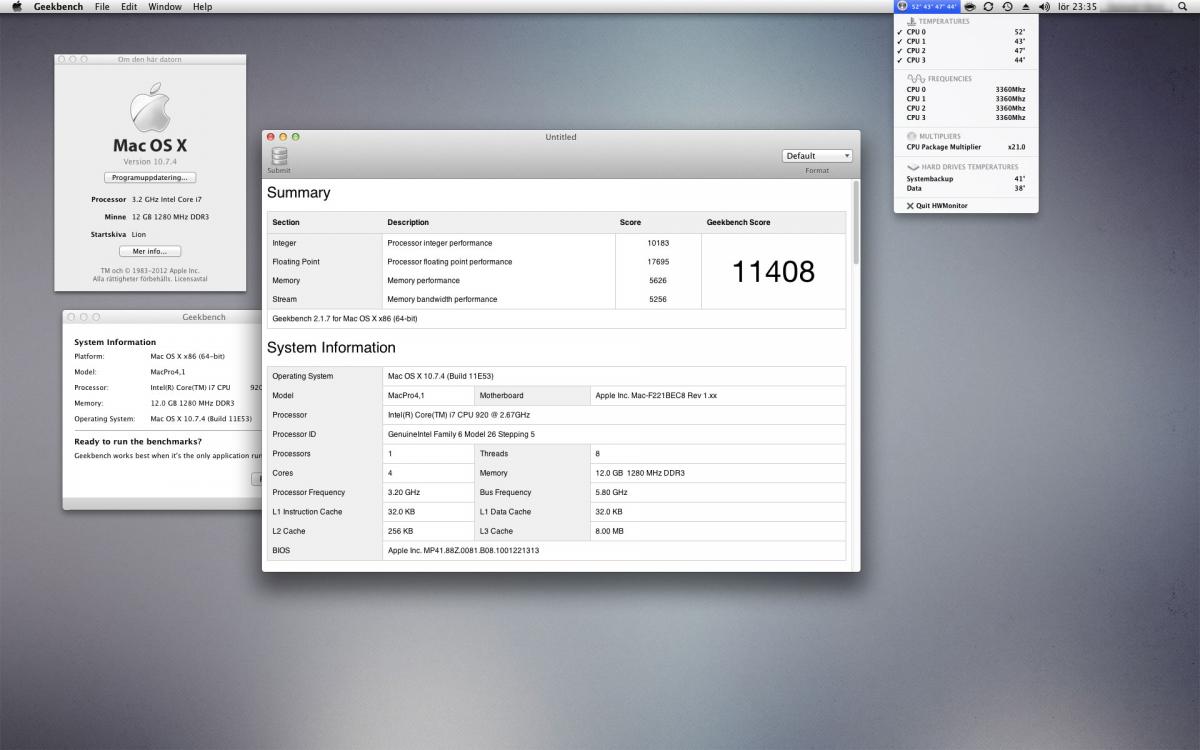

pixelcrook Posted July 21, 2012 Share Posted July 21, 2012 Got FakeSMC to work, and now i see that speedstep is working, clocked the cpu slightly, and i think this geekbench score (11 408) is pretty standard for a i7 920 @ 3,2 ghz. All good! This means Lion(Appstore10.7.4)+lionize+newest DSDT+ACPIPlatform 1.5 is working good on my system. Sleep & wake, fast boot, speedstep and so on. Seems to KP randomly when i clock the cpu a bit more, will investigate. Thanks guys for making this tread very helpful! Link to comment https://www.insanelymac.com/forum/topic/267001-guide-lion-107-on-asus-x58-lga-1366-i7-9xx/page/27/#findComment-1835832 Share on other sites More sharing options...

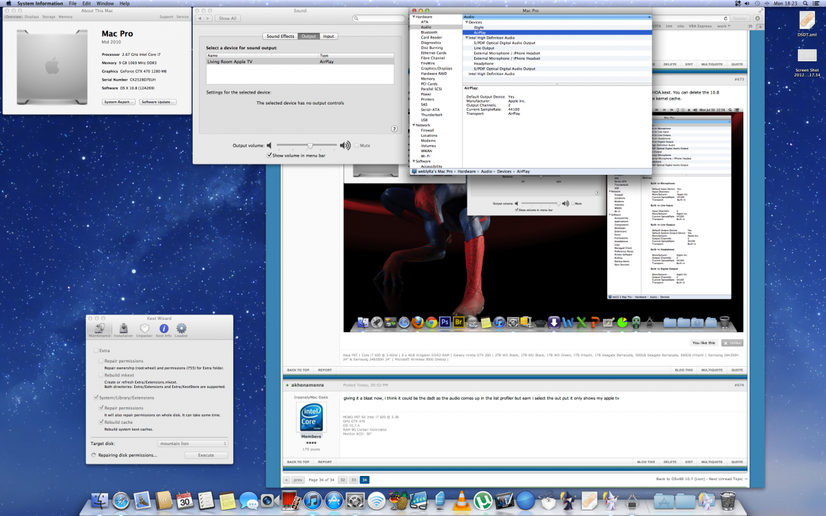

akhenamenra Posted July 30, 2012 Share Posted July 30, 2012 glad im not in the boat alone ....... we can take the 10.7.4 sound kext from the DMG installer image ( system library etc ) and instal with kext utility and we will have sound or does the file need t be installed on a working copy of lion i.e. upgrade to lion 10.7.4 and then just copy across ? i would try but im not a t home many thanks , also can any one host the 10.7.4 next for education purposes? if all is good. Link to comment https://www.insanelymac.com/forum/topic/267001-guide-lion-107-on-asus-x58-lga-1366-i7-9xx/page/27/#findComment-1838819 Share on other sites More sharing options...
tot318 Posted July 30, 2012 Share Posted July 30, 2012 @akhenamenra, I don't know what exactly went wrong on your side, for me it was pretty simple and straight forward installation of the ALC1200 patched AppleHDA.kext. You can delete the 10.8 AppleHDA.kext file and then by using Kext Wizard just installed the patched AppleHDA.kext and use Kext Utility to repair permission and rebuild the kernel cache. 1 Link to comment https://www.insanelymac.com/forum/topic/267001-guide-lion-107-on-asus-x58-lga-1366-i7-9xx/page/27/#findComment-1838840 Share on other sites More sharing options...
akhenamenra Posted July 30, 2012 Share Posted July 30, 2012 giving it a blast now, i think it could be the dsdt as the audio comes up in the list profiler but earn i select the out put it only shows my apple tvn edit nah its still the same , i may change the dsdt tho Link to comment https://www.insanelymac.com/forum/topic/267001-guide-lion-107-on-asus-x58-lga-1366-i7-9xx/page/27/#findComment-1838873 Share on other sites More sharing options...
tot318 Posted July 30, 2012 Share Posted July 30, 2012 I'm not sure which method did you use to install ML as I was using Ermac's Mountain-Lionize script and it has all the DSDTs for most of Asus X58 boards. 1 Link to comment https://www.insanelymac.com/forum/topic/267001-guide-lion-107-on-asus-x58-lga-1366-i7-9xx/page/27/#findComment-1838891 Share on other sites More sharing options...
