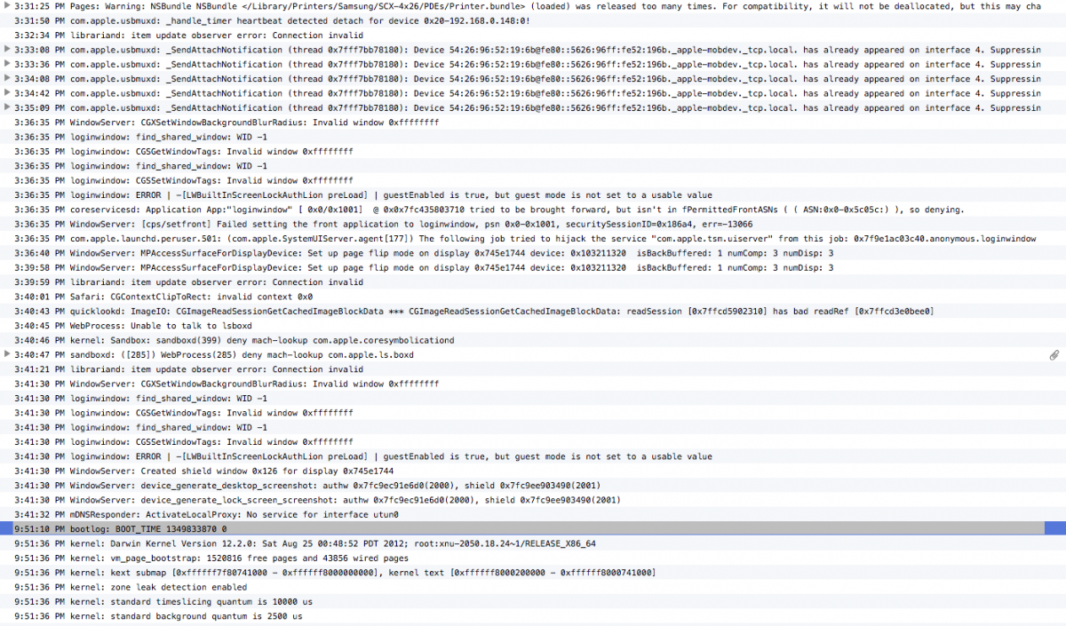

Dojomann Posted October 9, 2012 Share Posted October 9, 2012 Hey, I'm having a sleep/wake problem and I'm wondering if anyone else is in the same boat (10.8.2 with DP3 nvidia kexts): Most of the time it works flawlessly (even auto sleep!) but every so often I'm unable to wake the computer using any usb device (or bluetooth keyboard/mouse) and when waking it with the power button, the screen stays black and I have to do a hard reset. Anyone ran into this and fixed it somehow? Link to comment https://www.insanelymac.com/forum/topic/267001-guide-lion-107-on-asus-x58-lga-1366-i7-9xx/page/31/#findComment-1859397 Share on other sites More sharing options...

Dojomann Posted October 10, 2012 Share Posted October 10, 2012 maybe DP3 Nvidia kexts is the problem? What Nvidia card? Check console logs after it does this as soon a you reboot and see if any error shows GeForce 560Ti. Other kexts cause even more regular amounts of freezing (especially the latest 10.8.2 kexts.. there's a big thread about it on tony mac site for the 550ti) as a general guideline, should I enable p and c state generation? use the cst using sysIO ? USB bus fix? force HPET? what settings could fix this? also, i think I modified my AppleRTC kext. Some places i've seen saydelete the Apple TyMCE driver. Should this make a difference? What does that driver do, anyway? Finally, I have a weird feeling that it might have something to do with the USB drivers. Are there any DSDT fixes? Also here's the log (I left the house earlier in the day, and just now in the evening I had to reboot it) Link to comment https://www.insanelymac.com/forum/topic/267001-guide-lion-107-on-asus-x58-lga-1366-i7-9xx/page/31/#findComment-1859518 Share on other sites More sharing options...
eep357 Posted October 10, 2012 Share Posted October 10, 2012 Nothing that appears GPU related, looks like your USB devices might be ejecting on sleep, maybe just the UHCI (USB 1.1) devices, USBBusFix is supposed to fix that if DSDT doesn't. Most patched DSDT only have extensive edits for EHCI and sometimes UHCI gets overlooked, which has caused some problems in ML for people where in Lion it was not a problem. I use it because for some unknown reason it also increases my benchmark scores 5-10%. P&C states or Cstates using sysIO would apply to speed step, which can also be enabled via DSDT and/or SSDT. If you have HWmonitor installed with FakeSMC monitoring plug-ins, there is a CPU frequency option where you can see it go from the low x12 multiplier to whatever you set as your high multiplier in bios. Even though you'll likely have more than 2 states enabled, it will only show the high/low but in graph view can see it hitting the different states in-between. Try with and without P&C states and see if any difference in this behavior and if any difference in the cpu temps. Prob don't need force HPET, but won't hurt to use it. If you use the Perl command I posted a few posts back, that will patch AppleRTC. Some systems if using MacPro 5,1 smbios will KP during boot from AppleTyMCE, so you would know if you need to remove it Here's my org.chameleon.Boot.plist, some of which is not 100% necessary and graphics stuff specific to my card, UUID stuff specific to RAID-0 booting: <dict> <key>AtiConfig</key> <string>Uakari</string> <key>AtiPorts</key> <string>4</string> <key>Default Partition</key> <string>hd(0,3)</string> <key>DropSSDT</key> <string>Yes</string> <key>EthernetBuiltIn</key> <string>Yes</string> <key>ForceHPET</key> <string>Yes</string> <key>Graphics Mode</key> <string>1440x900x32</string> <key>GraphicsEnabler</key> <string>Yes</string> <key>GUI</key> <string>No</string> <key>Kernel</key> <string>mach_kernel</string> <key>Kernel Flags</key> <string>rd=uuid boot-uuid=92496DB5-5DB1-365B-B82B-533C19F4945B -v npci=0x3000</string> <key>SystemType</key> <string>1</string> <key>Timeout</key> <string>3</string> <key>USBBusFix</key> <string>Yes</string> <key>UseKernelCache</key> <string>Yes</string> </dict> Disabling the pretty GUI speeds up the Chameleon boot time between selecting boot drive in Chameleon and Chameleon's pass off to OSX bootloader quite a bit. Also purposely using wrong resolution for Graphics Mode because if I do enable the GUI, LogIn to Lion theme has a artifact in bottom right corner at 1920x1200. Link to comment https://www.insanelymac.com/forum/topic/267001-guide-lion-107-on-asus-x58-lga-1366-i7-9xx/page/31/#findComment-1859644 Share on other sites More sharing options...
Dojomann Posted October 10, 2012 Share Posted October 10, 2012 okay! I did a whole host of things, so I'm not sure which has totally fixed it.. I re-compiled my DSDT with the latest iasl, and am not using usbbusfix, and that seemed to fix it 1 Link to comment https://www.insanelymac.com/forum/topic/267001-guide-lion-107-on-asus-x58-lga-1366-i7-9xx/page/31/#findComment-1859703 Share on other sites More sharing options...
