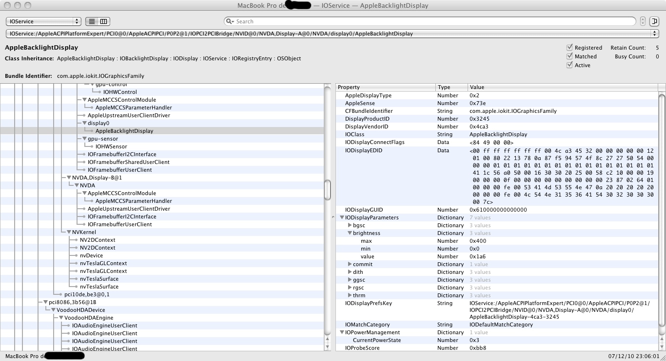

SUCCESS !!!
I managed to get brightness working on my laptop (Nvidia G310m) ! Although it doesn't use your kext, ivik, but I have used it a lot during my research and I think it is interesting information for other nvidia users.
Now, before I get to how I did it, I'd like to warn you that I have just succeeded moments ago and I still need to check temperatures and other harmful factors that may cause harm to the hardware.
Apparently, all it needed was the @0,pwm-info key injected, I took this key from a MacBookPro6,1 dump,
Here, since our graphics card were similar and injected it via GFX strings. Additionally, I added a PNLF device to my DSDT ( usefulness is still to be tested ).
Here is the Pnlf device:
Device (PNLF)
Name (_HID, EisaId ("APP0002"))
Name (_CID, "backlight")
Name (_UID, 0x0A)
Name (_STA, 0x0B)
And here is the injected part, you can inject it via DSDT or GFX string, it is your choice. You can look up information on how to do that on this forum.

It all began to work for me when I injected the @0,pwm-info key however some of the other keys may still be necessary (especially the keys concerning backlight).
Again, this may be dangerous, be careful when or if you try this out. I am not responsible if this bricks your hardware
Good job!!!!
And all brightness levels are oke? Are you inejcting your EDID?
Brightness levels seem to be OK, as for the EDID I injected prior to all the attempts I made to get brightness control working because without it screen colours would be strange.
Here is the brightness section on my IOReg
Now I just need to map my brightness keys to Fn+Up and Fn+Down :P , I seem to remember that there was some info on this thread, a few pages back.
