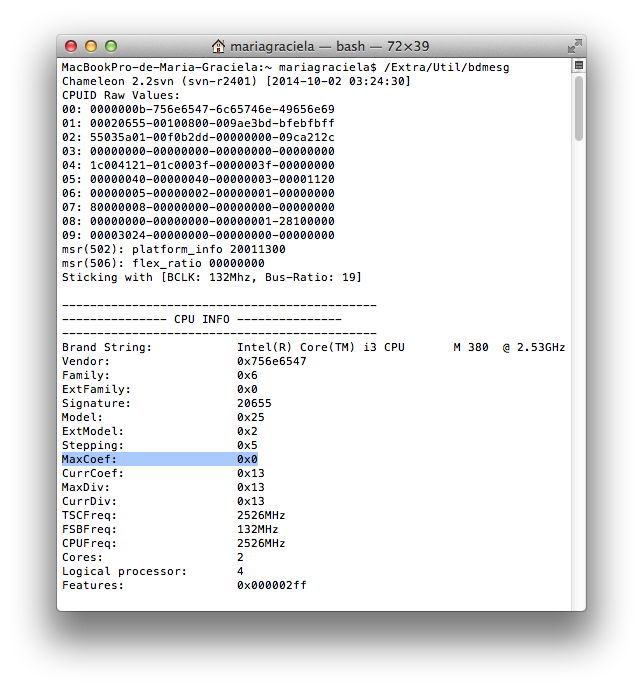

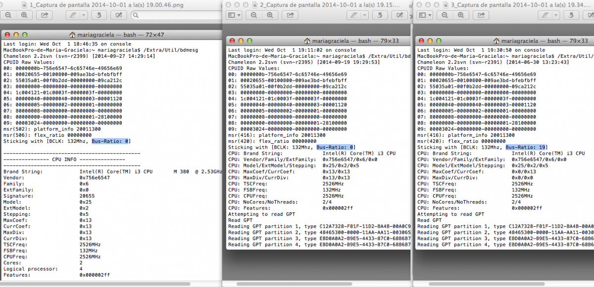

Hi people. Seems that I have a problem with r2399 and r2395 related to the Bus-Ratio.
Please see the bdmesg output where r2391 the Bus-Ratio (19) is correct, right?
Core i3 380M @ 2.53 Ghz: Speedstep (PerformanceStateArray in IOReg) shown 13 p-states in total from x7 (930 mhz) to x19 (2530 mhz).
Thank You.

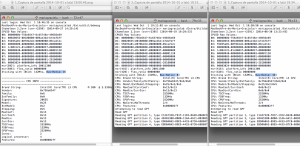

Thank You.
Pls test updated revision 2401.
