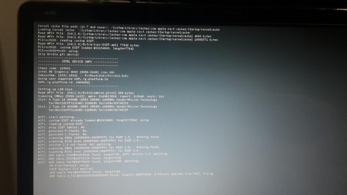

chris1111 Posted November 16, 2014 Share Posted November 16, 2014 On my desktop system receive a "memory allocation error"... waiting for the pictures from my smartphone I'm going to test that too.. EDIT nope same again.. this the picture: bungo.jpgbungo2.jpg sorry it was "AllocateKernelMemory" error... Just test and same picture here this is non recoverable error Link to comment https://www.insanelymac.com/forum/topic/231075-chameleon-24svn-official-pkg-installer/page/101/#findComment-2085998 Share on other sites More sharing options...
Micky1979 Posted November 16, 2014 Share Posted November 16, 2014 AllocateKernelMemory error? Link to comment https://www.insanelymac.com/forum/topic/231075-chameleon-24svn-official-pkg-installer/page/101/#findComment-2086000 Share on other sites More sharing options...
chris1111 Posted November 16, 2014 Share Posted November 16, 2014 AllocateKernelMemory error? yep, same exclacly picture Link to comment https://www.insanelymac.com/forum/topic/231075-chameleon-24svn-official-pkg-installer/page/101/#findComment-2086006 Share on other sites More sharing options...

Pike R. Alpha Posted November 20, 2014 Share Posted November 20, 2014 AllocateKernelMemory error? The error is triggered when you allocate too much memory, which can happen with huge ACPI tables. In that case there is simply not enough memory left to allocate, but try this change in memory.h -#define ZALLOC_LEN 0x10000000 +#define ZALLOC_LEN 0x14000000 1 Link to comment https://www.insanelymac.com/forum/topic/231075-chameleon-24svn-official-pkg-installer/page/101/#findComment-2087420 Share on other sites More sharing options...

Bungo Posted November 23, 2014 Share Posted November 23, 2014 The error is triggered when you allocate too much memory, which can happen with huge ACPI tables. In that case there is simply not enough memory left to allocate, but try this change in memory.h -#define ZALLOC_LEN 0x10000000 +#define ZALLOC_LEN 0x14000000 I fixed (imho) bugs. Can you test? boot_r2379.zip Thx. Link to comment https://www.insanelymac.com/forum/topic/231075-chameleon-24svn-official-pkg-installer/page/101/#findComment-2088639 Share on other sites More sharing options...

Micky1979 Posted November 25, 2014 Share Posted November 25, 2014 I fixed (imho) bugs. Can you test? boot_r2379.zip Thx. tested, is better, but now it stuck here ..but really intreasting . Link to comment https://www.insanelymac.com/forum/topic/231075-chameleon-24svn-official-pkg-installer/page/101/#findComment-2089057 Share on other sites More sharing options...
