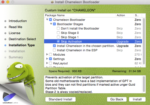

Micky1979 Posted April 3, 2015 Share Posted April 3, 2015 .. nice to hear i'm not alone in a boat. It's not only you and its not only the Chameleon installer . Guys, I made a new package with the "Skip" capabilities for Stage 0, Stage 1 and the activation: The package modified contain the actual r2643, but for all of you that want to test, the goal is to see if the new behavior is ok. So you can preserve already working boot sectors w/o rewrite it, only the stage 2 (boot file) is always installed. In the special case of @ea dd and @fusion71au you can now skip the "activation" on hfs+GPT partition ... hope it help! Default is to install all the stage, and as always you can choose to not install any of the binaries to play with Extra's options. Please give advice! Micky Chameleon-2.3svn-r2643_Skip-test.pkg.zip 2 Link to comment https://www.insanelymac.com/forum/topic/231075-chameleon-24svn-official-pkg-installer/page/113/#findComment-2125138 Share on other sites More sharing options...

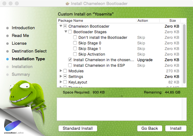

fusion71au Posted April 3, 2015 Share Posted April 3, 2015 Guys, I made a new package with the "Skip" capabilities for Stage 0, Stage 1 and the activation: test.png The package modified contain the actual r2643, but for all of you that want to test, the goal is to see if the new behavior is ok. So you can preserve already working boot sectors w/o rewrite it, only the stage 2 (boot file) is always installed. In the special case of @ea dd and @fusion71au you can now skip the "activation" on hfs+GPT partition ... hope it help! Default is to install all the stage, and as always you can choose to not install any of the binaries to play with Extra's options. Please give advice! Micky Thanks Micky, Works perfectly . Selecting "Skip Activation" during Chameleon install on a fresh GUID partitioned USB prevents the boot hang on my desktop GA-P55aUD3 . Install log: ============================================================================== SYSTEM INFO: ProductName: Mac OS X ProductVersion: 10.10.2 BuildVersion: 14C1514 ============================================================================== Pre-Install Script ------------------------------------------------------------------------------ Creating /Volumes/CHAMELEON/EXTRAROOTDIR symlink targeting /Volumes/BOOTRAMDISK /dev/disk0 #: TYPE NAME SIZE IDENTIFIER 0: FDisk_partition_scheme *120.0 GB disk0 1: Windows_NTFS System Reserved 104.9 MB disk0s1 2: Windows_NTFS WIN7_X64SSD 119.9 GB disk0s2 /dev/disk1 #: TYPE NAME SIZE IDENTIFIER 0: GUID_partition_scheme *2.0 TB disk1 1: EFI EFI 209.7 MB disk1s1 2: Microsoft Basic Data TSH_DATA 1.7 TB disk1s2 3: Apple_HFS Macintosh HD 133.6 GB disk1s3 4: Microsoft Reserved 133.2 MB disk1s4 5: Apple_Boot Recovery HD 650.0 MB disk1s5 6: Microsoft Basic Data WINDOWS 134.1 GB disk1s6 /dev/disk2 #: TYPE NAME SIZE IDENTIFIER 0: GUID_partition_scheme *32.0 GB disk2 1: EFI EFI 209.7 MB disk2s1 2: Apple_HFS CHAMELEON 31.7 GB disk2s2 /dev/disk3 #: TYPE NAME SIZE IDENTIFIER 0: BOOTRAMDISK *209.7 MB disk3 ------------------------------------------------------------------------------ END - Pre-Install Script ============================================================================== Main Standard Post-Install Script Chameleon installer log - Sat Apr 4 09:16:58 AEDT 2015 Darwin/x86 boot v5.0.132 - Chameleon v2.3svn r2643 ============================================================================== BACKUP CHAMELEON FILES: No stage 2 (boot) was found, nothing to be saved. No Extra folder was found, nothing to be saved. ============================================================================== EXTRA FOLDER: Extra not found on /Volumes/CHAMELEON, creating.. File Doesn't Exist, Will Create: /Volumes/BOOTRAMDISK/Extra/org.chameleon.Boot.plist ============================================================================== First Check Passed (not Fat16)! Windows installation not found on /dev/disk2. /dev/disk2s2 is HFS formatted ============================================================================== WRITING STAGE 0: boot0 written to /dev/disk2 ============================================================================== WRITING STAGE 1 hfs: boot1h (hfs) written to /dev/rdisk2s2. ============================================================================== WRITING STAGE 2: Stage 2 (boot) written to /Volumes/CHAMELEON. ============================================================================== SET PARTITION ACTIVE: Setting /Volumes/CHAMELEON partition active. user chose to skip activation, partition not activated! ============================================================================== ============================================================================== END - Standard Post-Install Script ============================================================================== Running Post postinstall script Target volume = /Volumes/CHAMELEON ------------------------------------------------------------------------------ Moving Extra folder to /Volumes/CHAMELEON ------------------------------------------------------------------------------ Post postinstall script complete ============================================================================== NOTE: any Themes or modules you have must be there since this now is the boot partition. ACPI tables, SMBios.plist and the org.chameleon.Boot.plist (with custom settings for the target OSX must be in each partition that contain it.) ============================================================================== 1 Link to comment https://www.insanelymac.com/forum/topic/231075-chameleon-24svn-official-pkg-installer/page/113/#findComment-2125160 Share on other sites More sharing options...

ea dd Posted April 4, 2015 Share Posted April 4, 2015 Thanks Micky, Works perfectly . Selecting "Skip Activation" during Chameleon install on a fresh GUID partitioned USB prevents the boot hang on my desktop GA-P55aUD3 . another confirmation. it works. thank you Micky1979 The installer is getting more flexible. 1 Link to comment https://www.insanelymac.com/forum/topic/231075-chameleon-24svn-official-pkg-installer/page/113/#findComment-2125217 Share on other sites More sharing options...
Micky1979 Posted April 4, 2015 Share Posted April 4, 2015 Thanks Micky, Works perfectly . Selecting "Skip Activation" during Chameleon install on a fresh GUID partitioned USB prevents the boot hang on my desktop GA-P55aUD3 . another confirmation. it works. thank you Micky1979 The installer is getting more flexible. If ErmaC wants... modified files are ready! Guys by the way, descriptions are in a correct English?? There were 2 entries commited in 2602 (malloc & enable20) I thought it was Enable20() that was causing the issue line error leads here: #ifdef __i386__ if (!gCacheBuffer) { gCacheBuffer = (char *) malloc(kCacheSize); } if (!gCacheEntries) { gCacheEntries = (CacheEntry *) malloc(kCacheMaxEntries * sizeof(CacheEntry)); } if (!gCacheBuffer || !gCacheEntries) { gCacheIH = 0; // invalidate cache return; } #endif then... I don't know.. (CacheEntry *) is a pointer to the same var?? ...(I'm saying something stupid?) Link to comment https://www.insanelymac.com/forum/topic/231075-chameleon-24svn-official-pkg-installer/page/113/#findComment-2125219 Share on other sites More sharing options...
ea dd Posted April 4, 2015 Share Posted April 4, 2015 If ErmaC wants... modified files are ready! Guys by the way, descriptions are in a correct English?? Description is ok with me since i understand it. and just a small typo "Stage 2 is always copied/replaced." thanks 1 Link to comment https://www.insanelymac.com/forum/topic/231075-chameleon-24svn-official-pkg-installer/page/113/#findComment-2125220 Share on other sites More sharing options...
